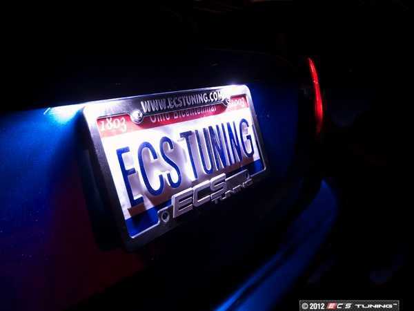

I assume the 'with LEDs' trim is LED license bulbs?
Old Dec 9, 2024 | 09:50 AM
Posts: 36,760
Likes: 2,549
Yep, we have them in a kit which adds the ziza ones. I have those on my cars also.
R50/R52/R53/R56/R57/R58/R59 LED License Plate Bulb - Pair
