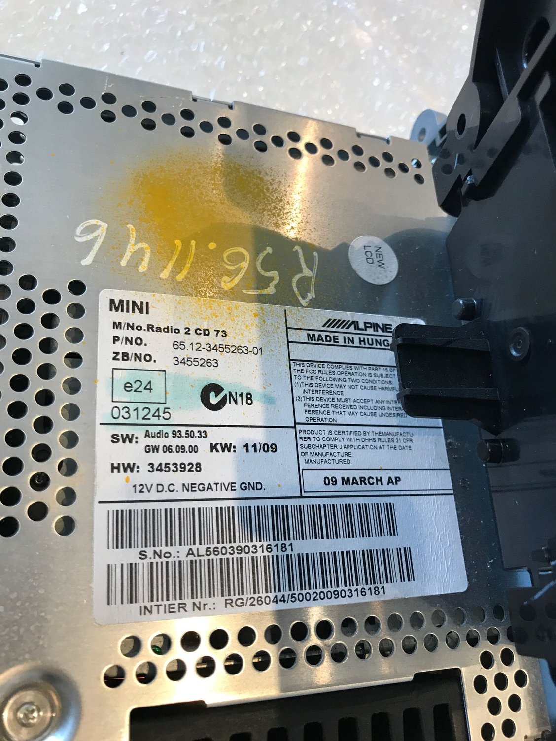

Found a used replacement, exact same PN's, with a build date 1 month earlier than mine, March 09 vs April 09.

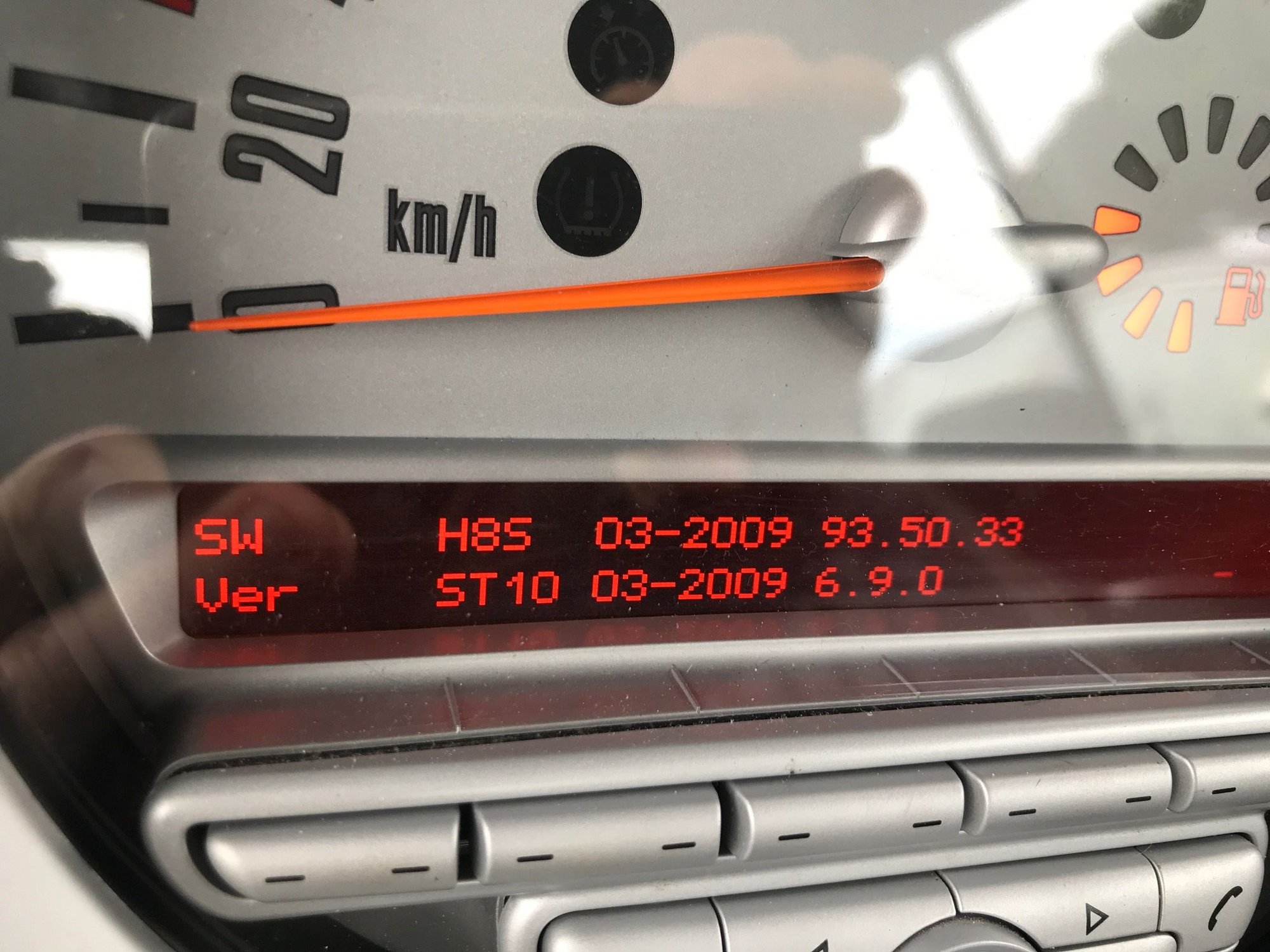

I went into "service mode" in the Radio and got the SW revision.
H8S 03-2009 93.50.33
ST10 03-2209 6.9.0

original radio unit
replacement unit
SW revision:
