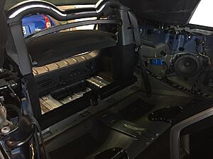

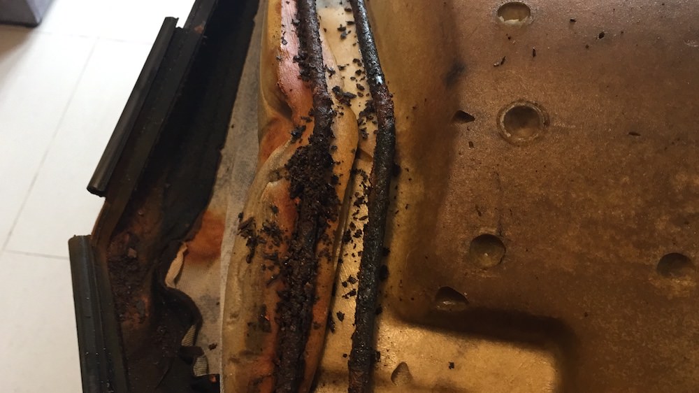

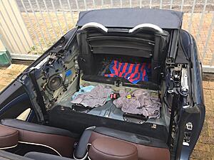

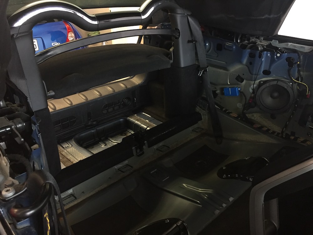

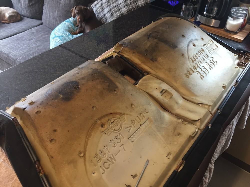

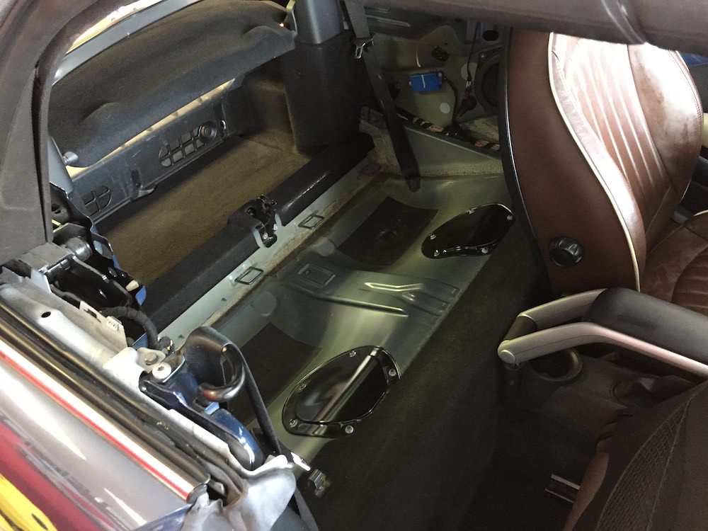

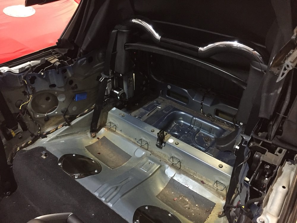

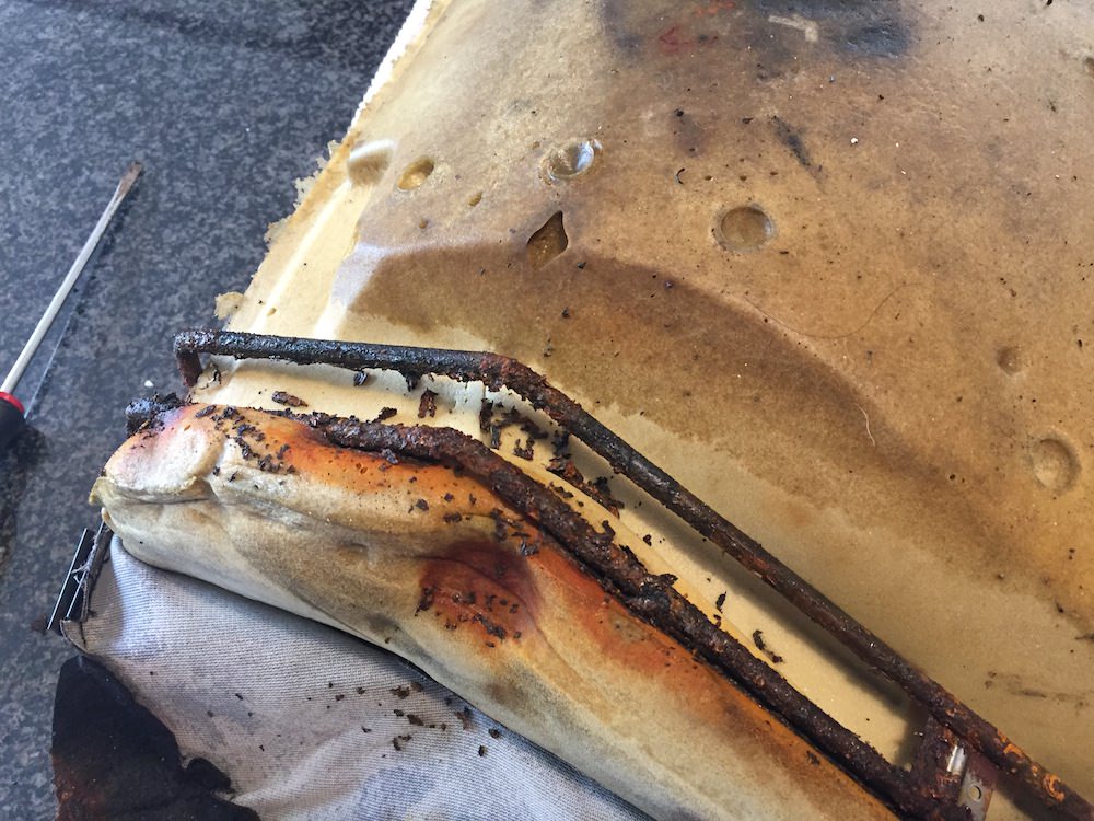

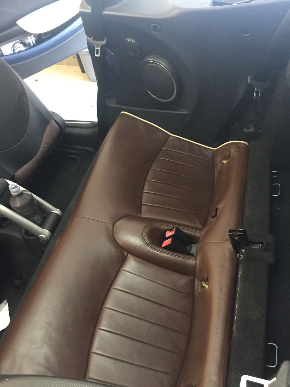

I started by stripping out the rear of the car and was immediately informed that this was not a new problem on the car.

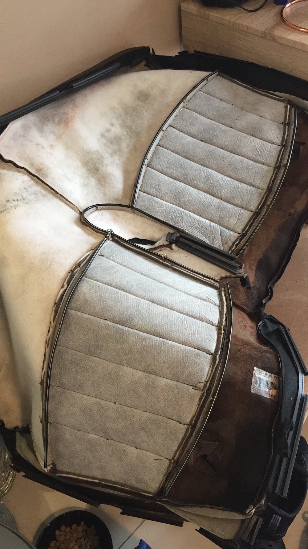

The seat foam, frames and parts were soaking wet, I had no choice but to separate the frame, foam and leather for repair.

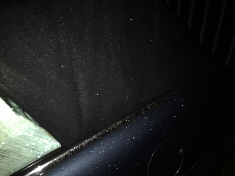

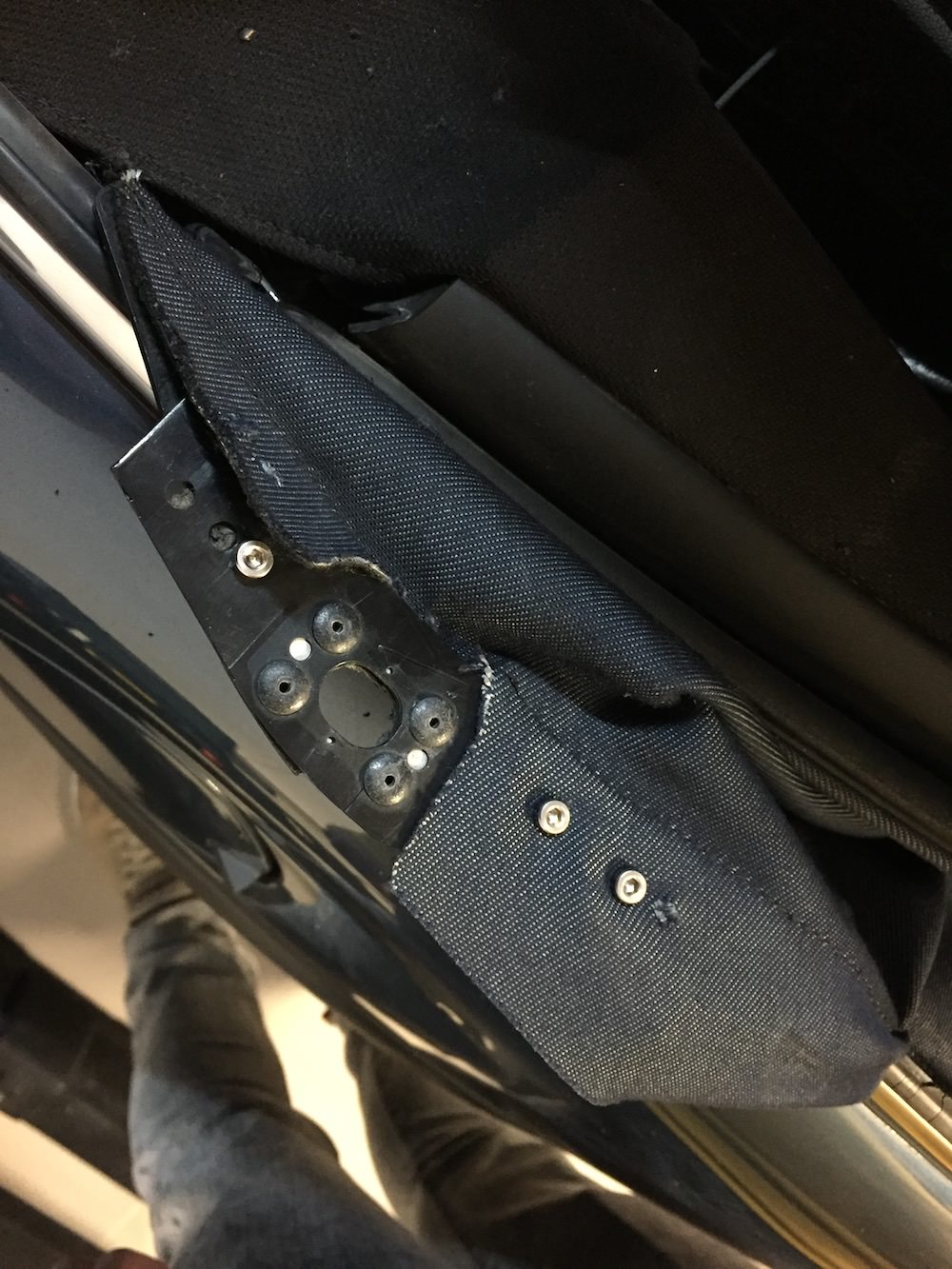

The next heavy downpour found me outside in the car diagnosing the leak, my suspicions were confirmed, the loose sidepanels of the roof had been allowing water to drip into the car:

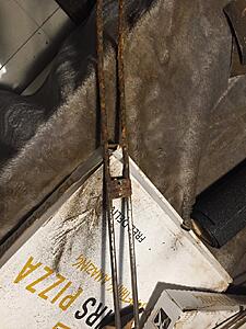

With it now being dark, and not one to simply put things back that I know are not right I spent about 2 hours sanding down the metal frame for the rear seats and chucked the leather into the washing machine with some warm soapy water on the “wool” setting.
The frame was then painted with anti-rust and sprayed with a metal spraypaint:

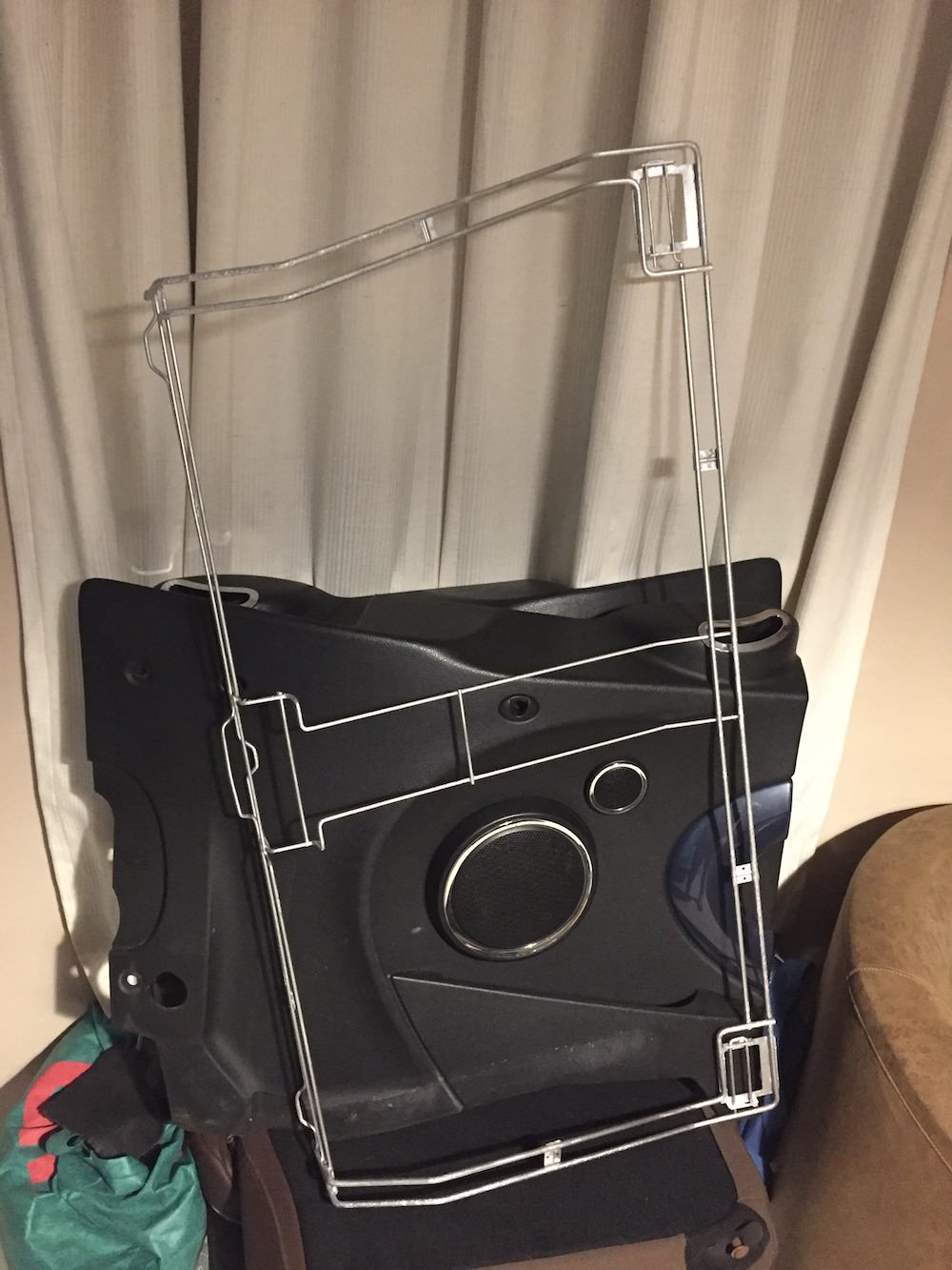

I shot down to our local hardware and grabbed 6x nuts / bolts with locked threads. I then took a 6mm drill piece (Metal with the sharp pointy end) and drilled in new holes after lining the plastics up as best as possible. The end result:
These were then re-attached to the car with brand new circlips. Now, these circlips are not on BMW's parts system listed under the roof, not even under the clip kit they supply. The circlip is used on the clutch pedal assembly, and its called a “FUSE”.

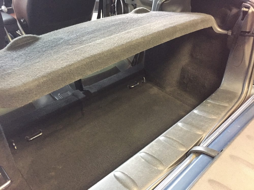

Boot re-assembly coming along nicely:
