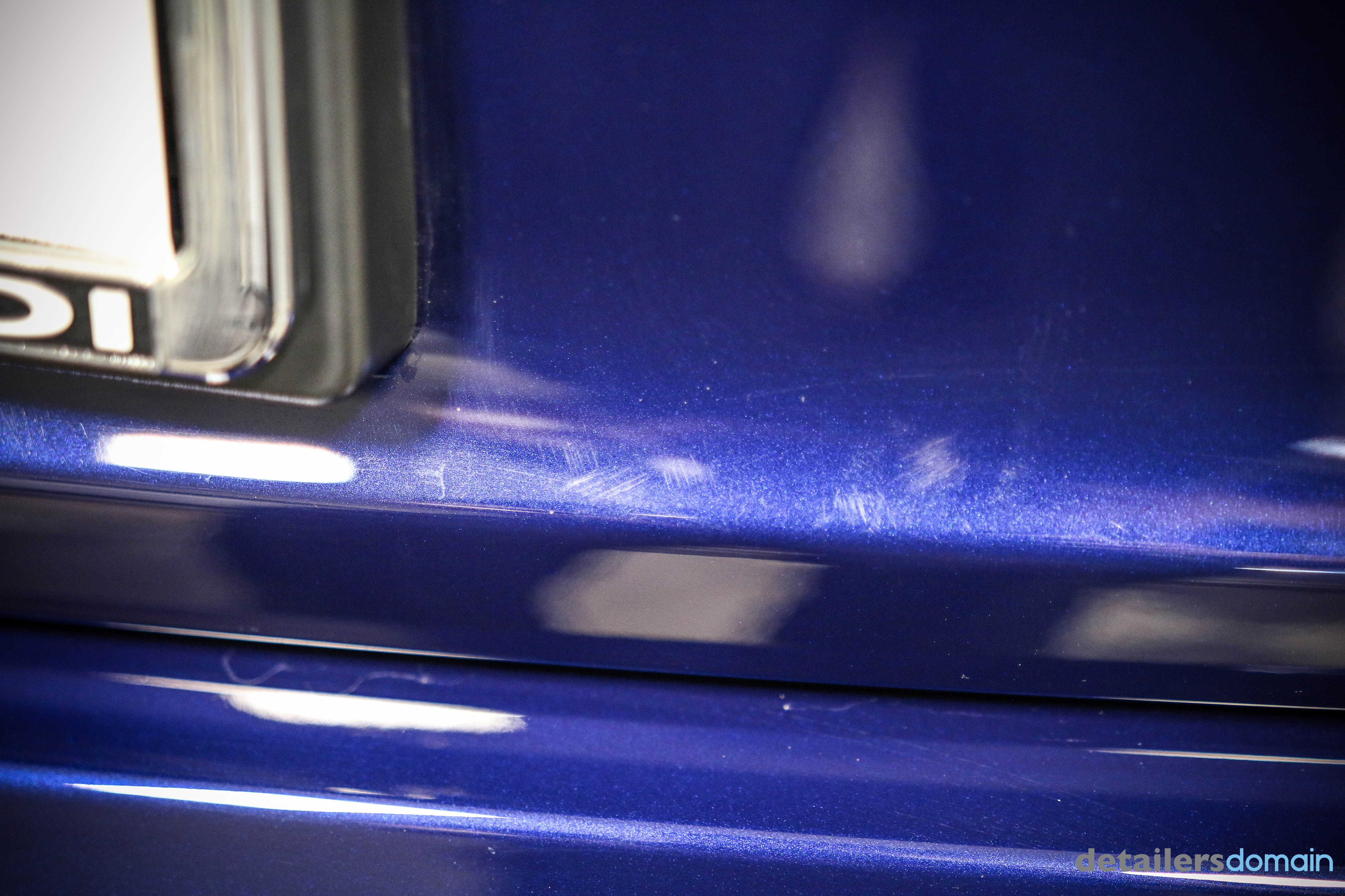

A closer look - these marks were on the roof, hood, trunk

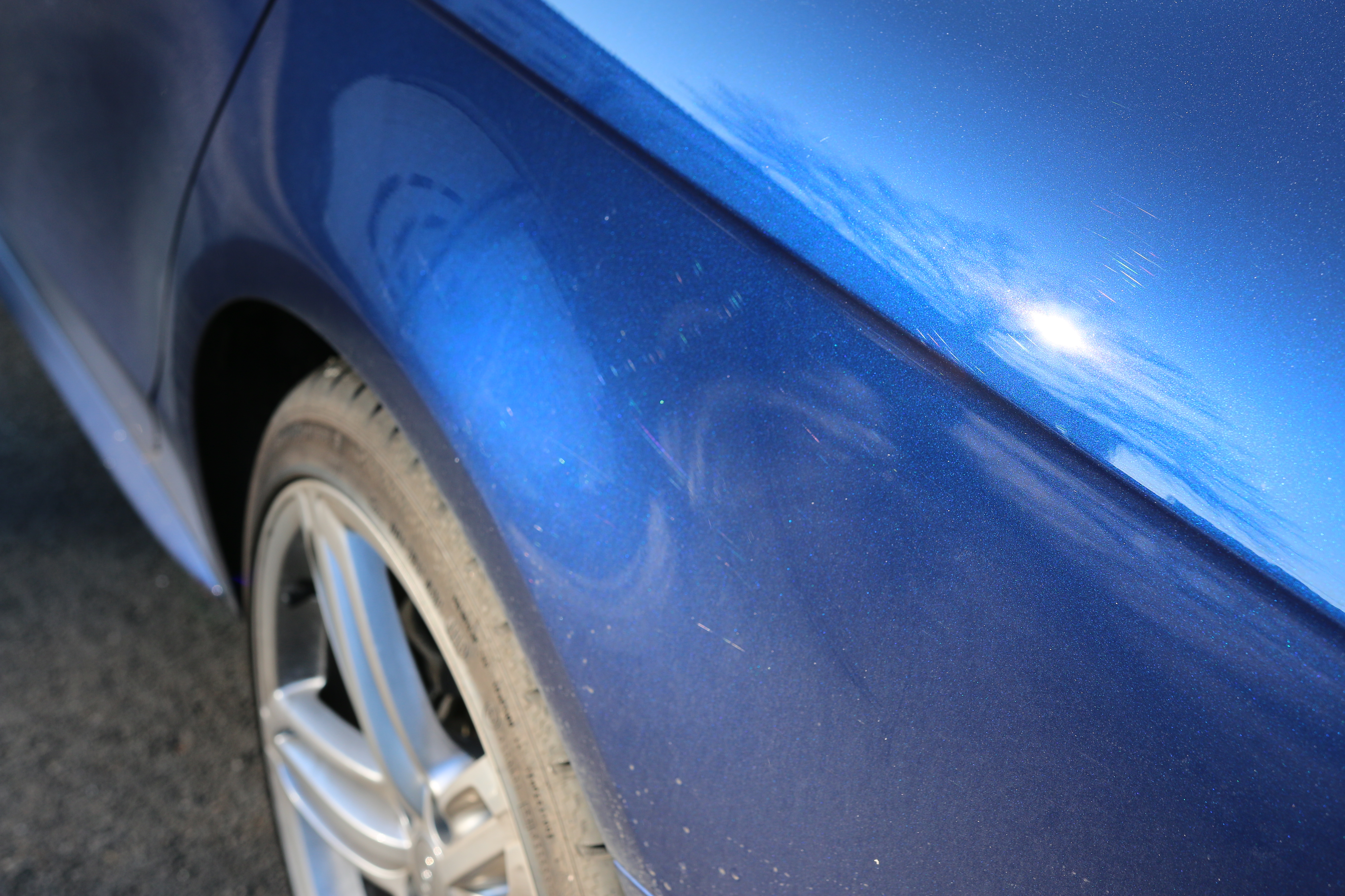

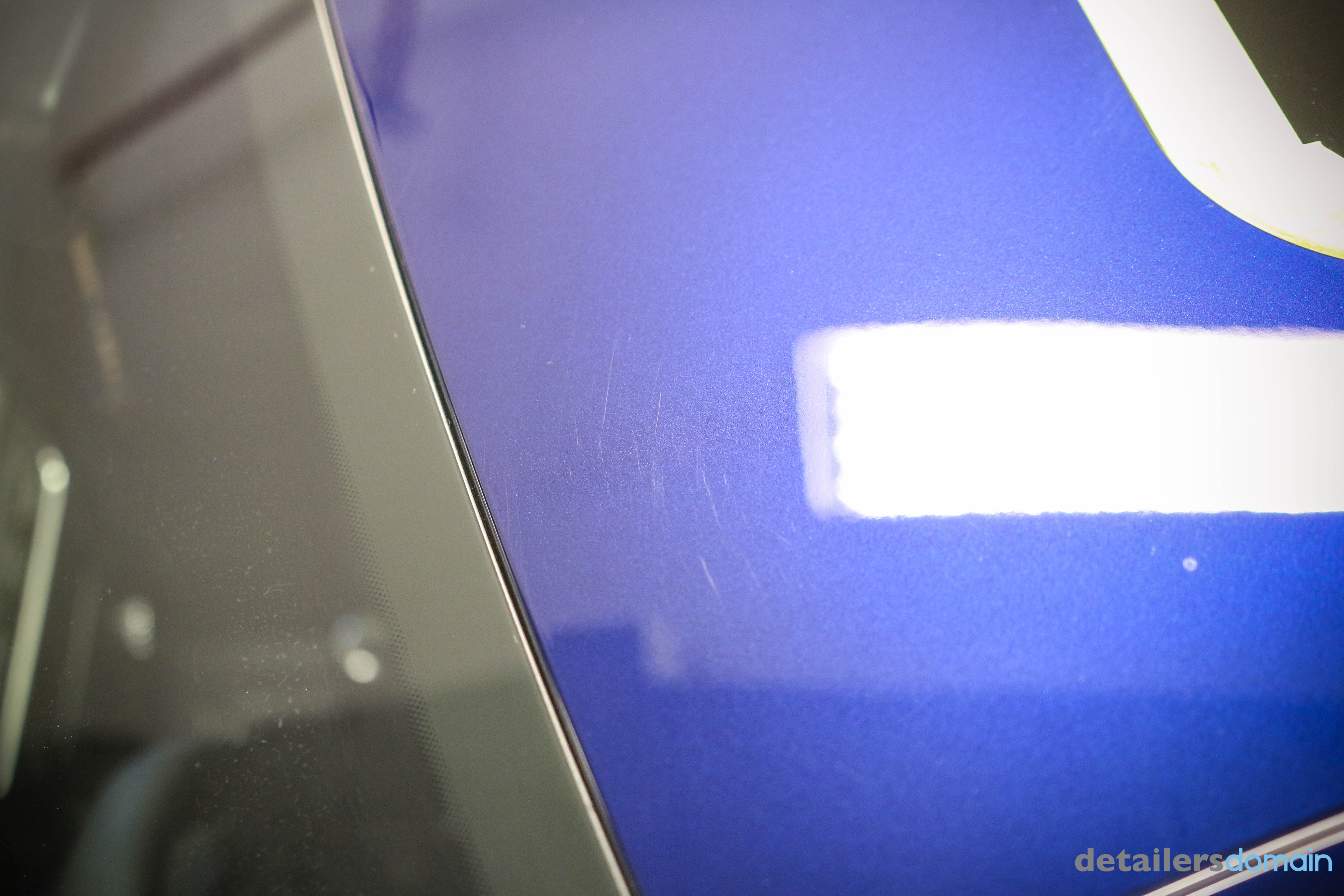

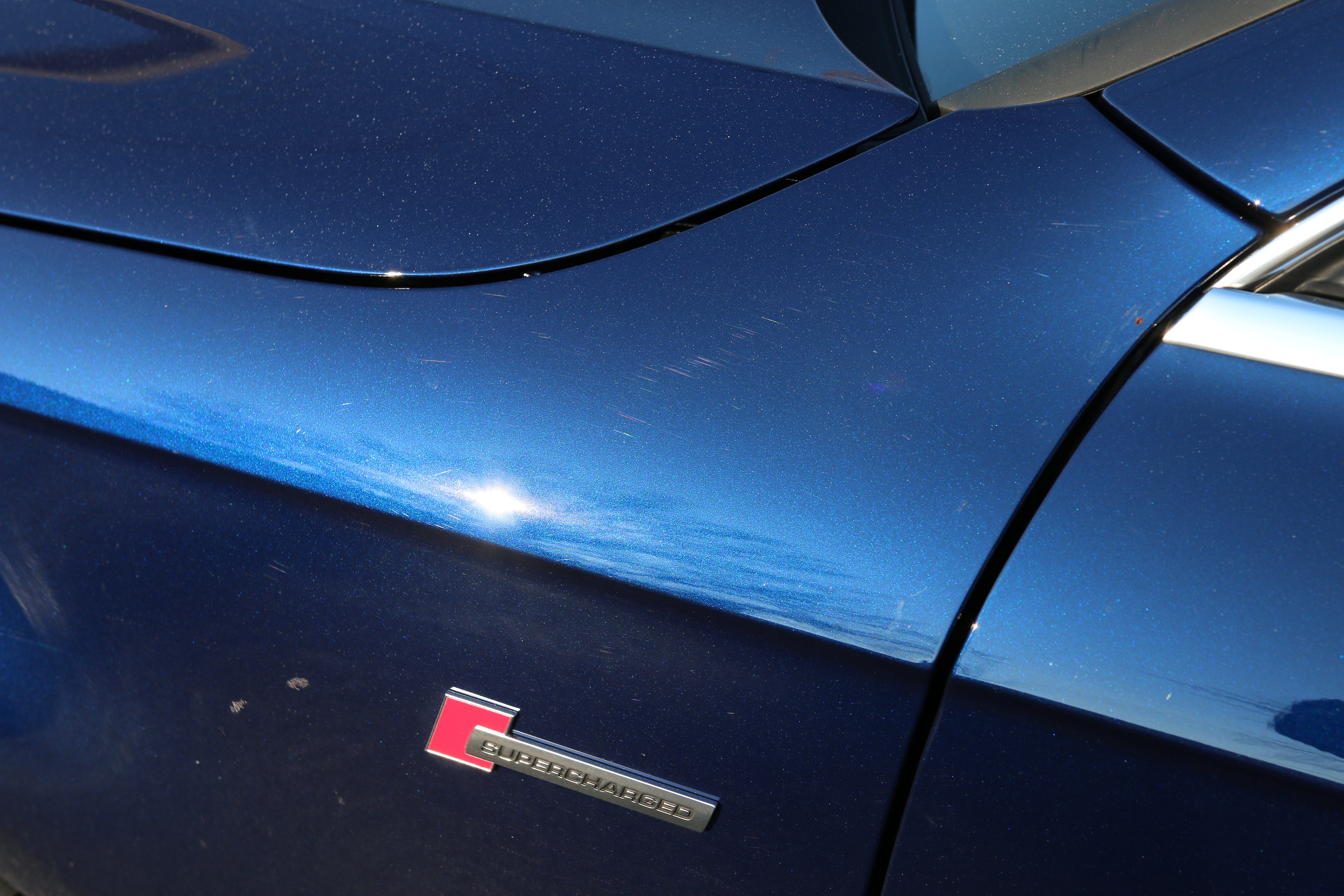

Various scratches/imperfections

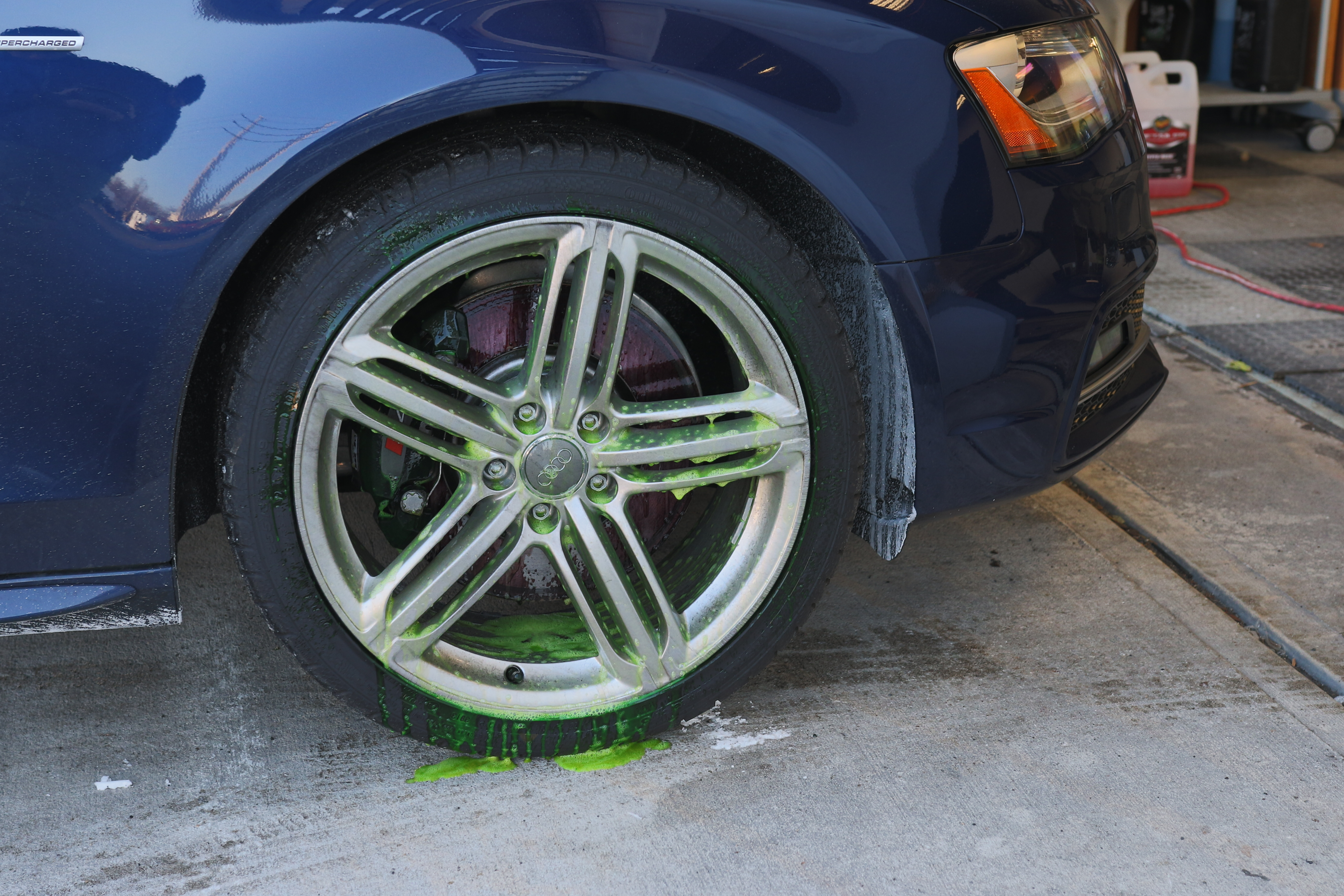

Wheels
Sonax Full Effect Wheel Cleaner and various brushes used to clean up the OEM Peelers

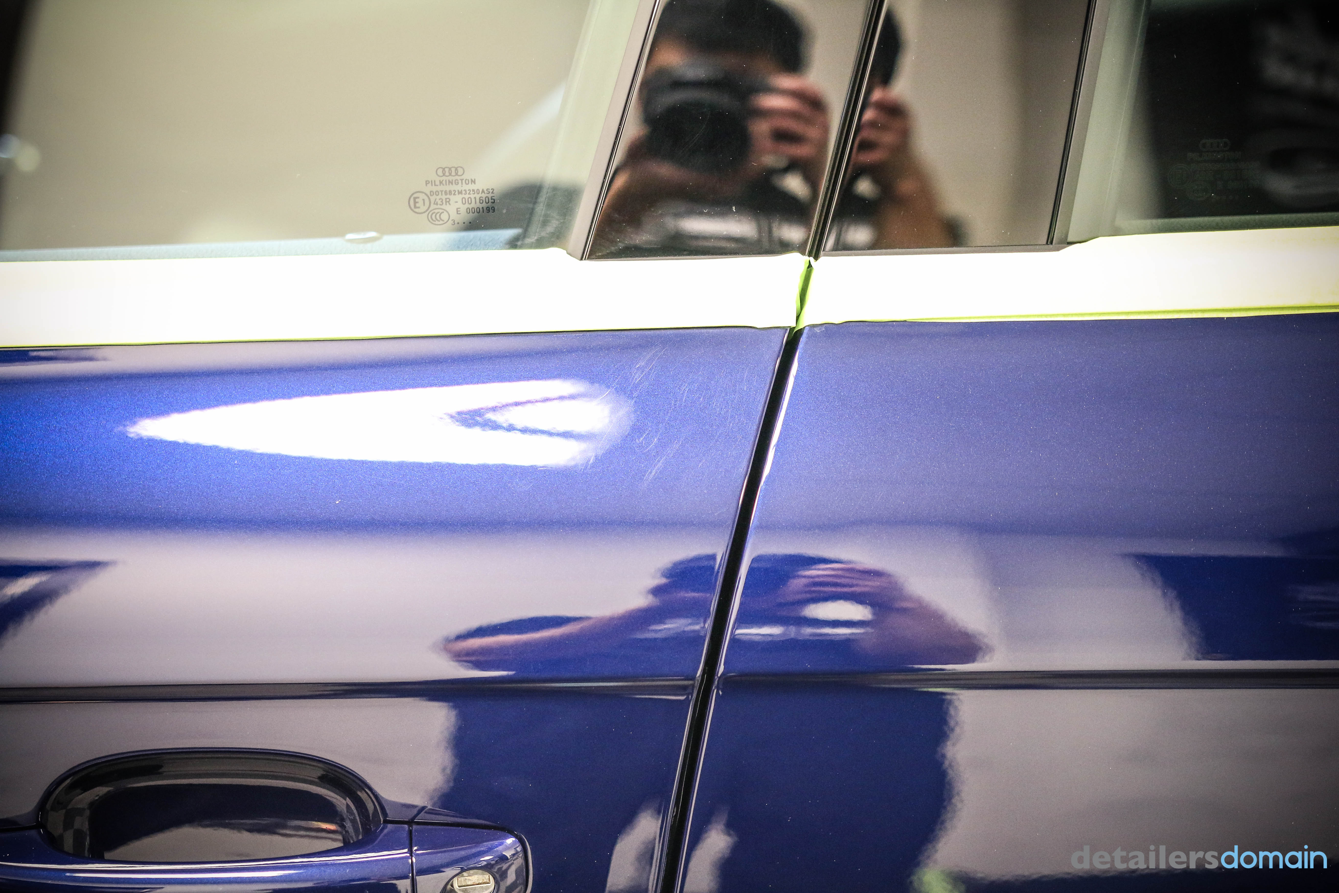

Light scratches around the door handles
After

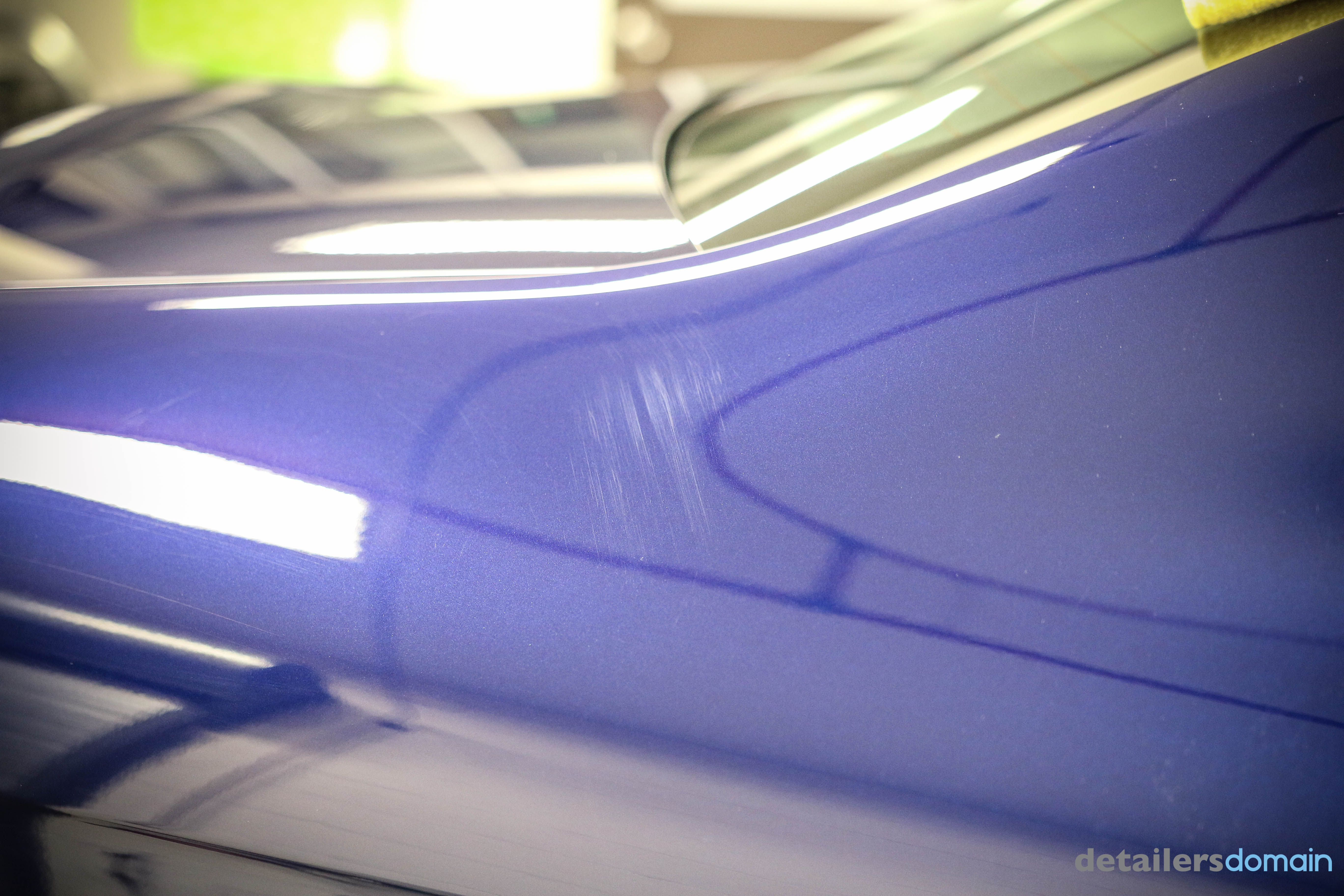

B pillars a common issue with BMW, Audi, VW
After much better after we hit it with Menzerna FG400 and finished it out with Sonax Perfect Finish 4/6

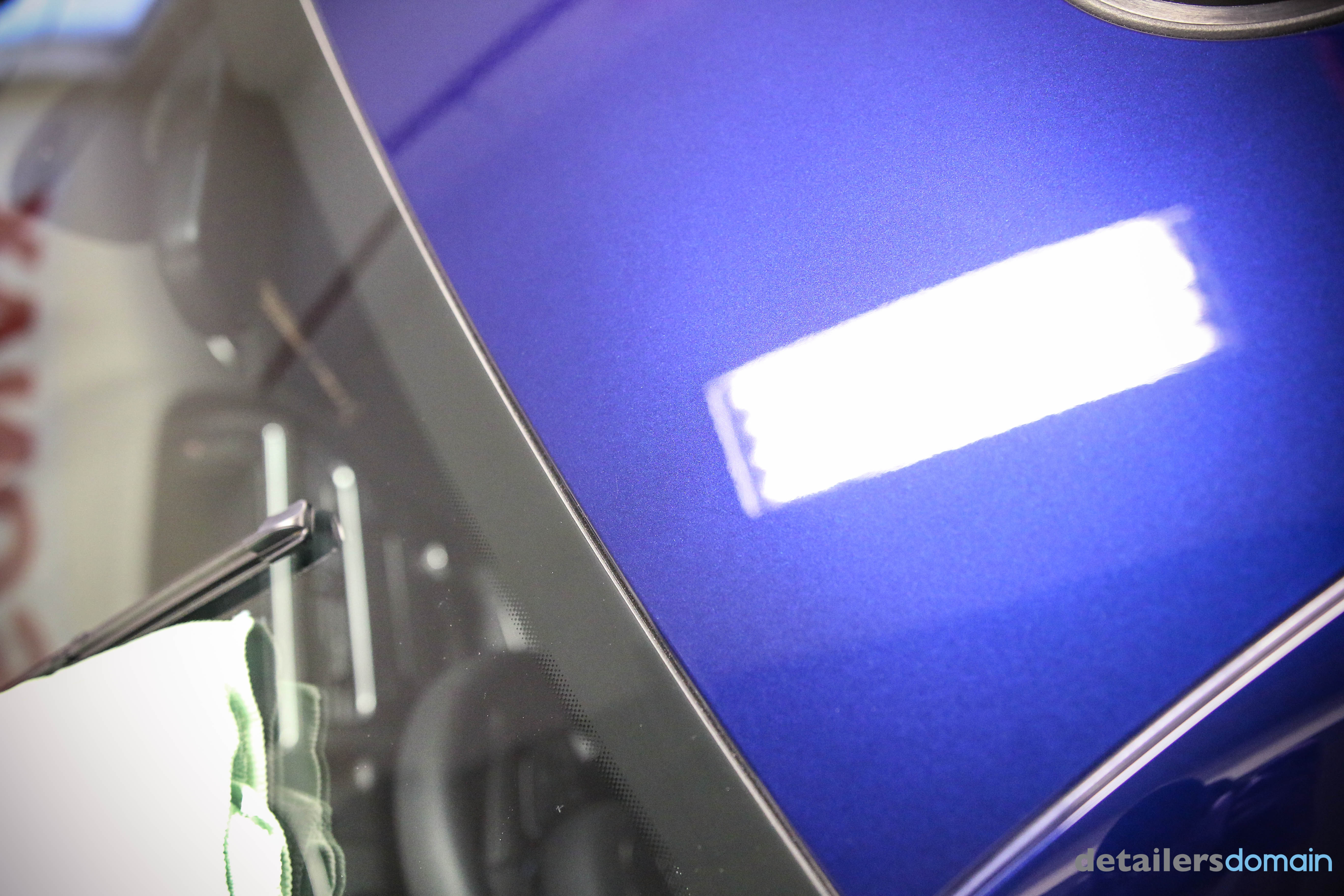

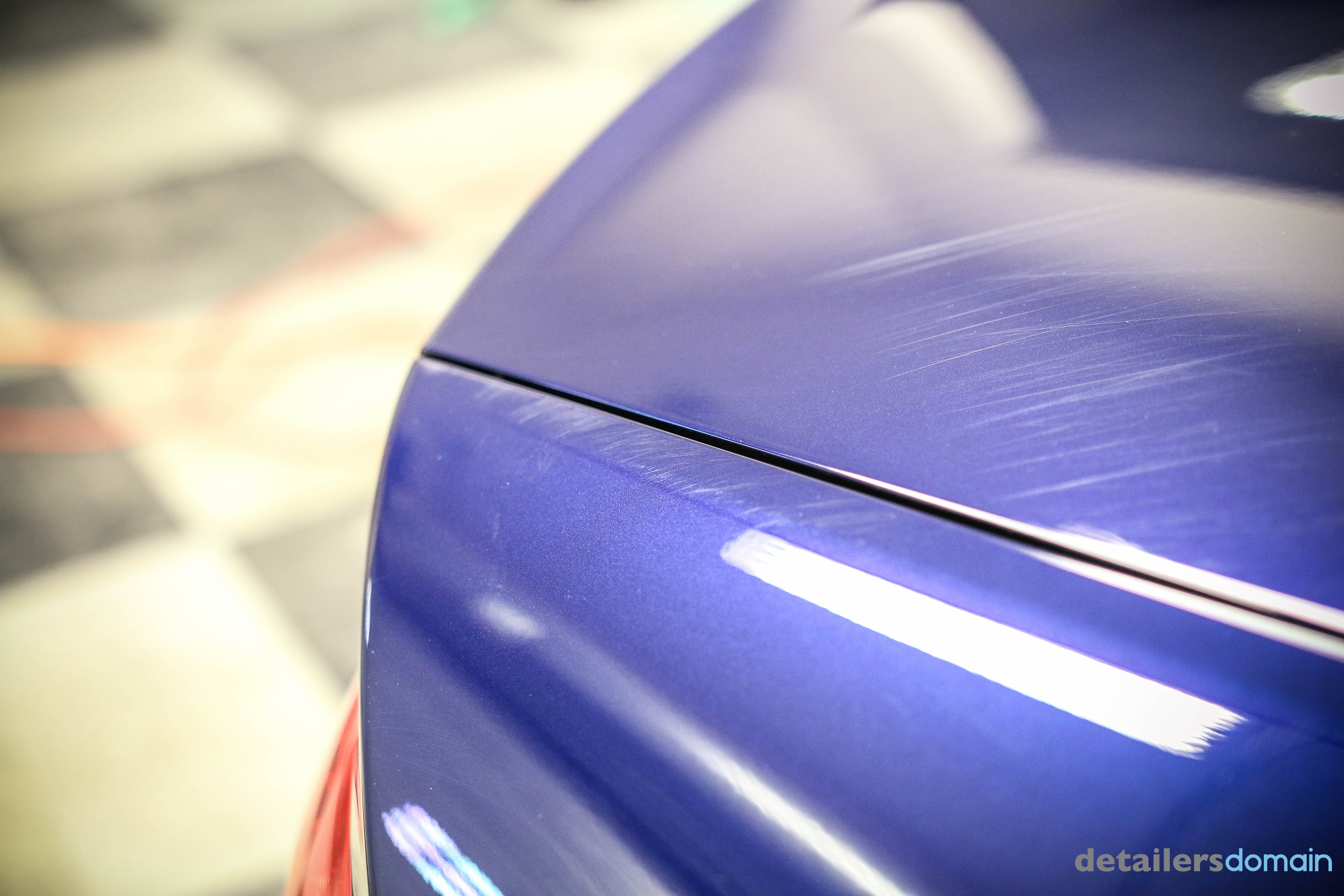

Before shot on the roof
After
After

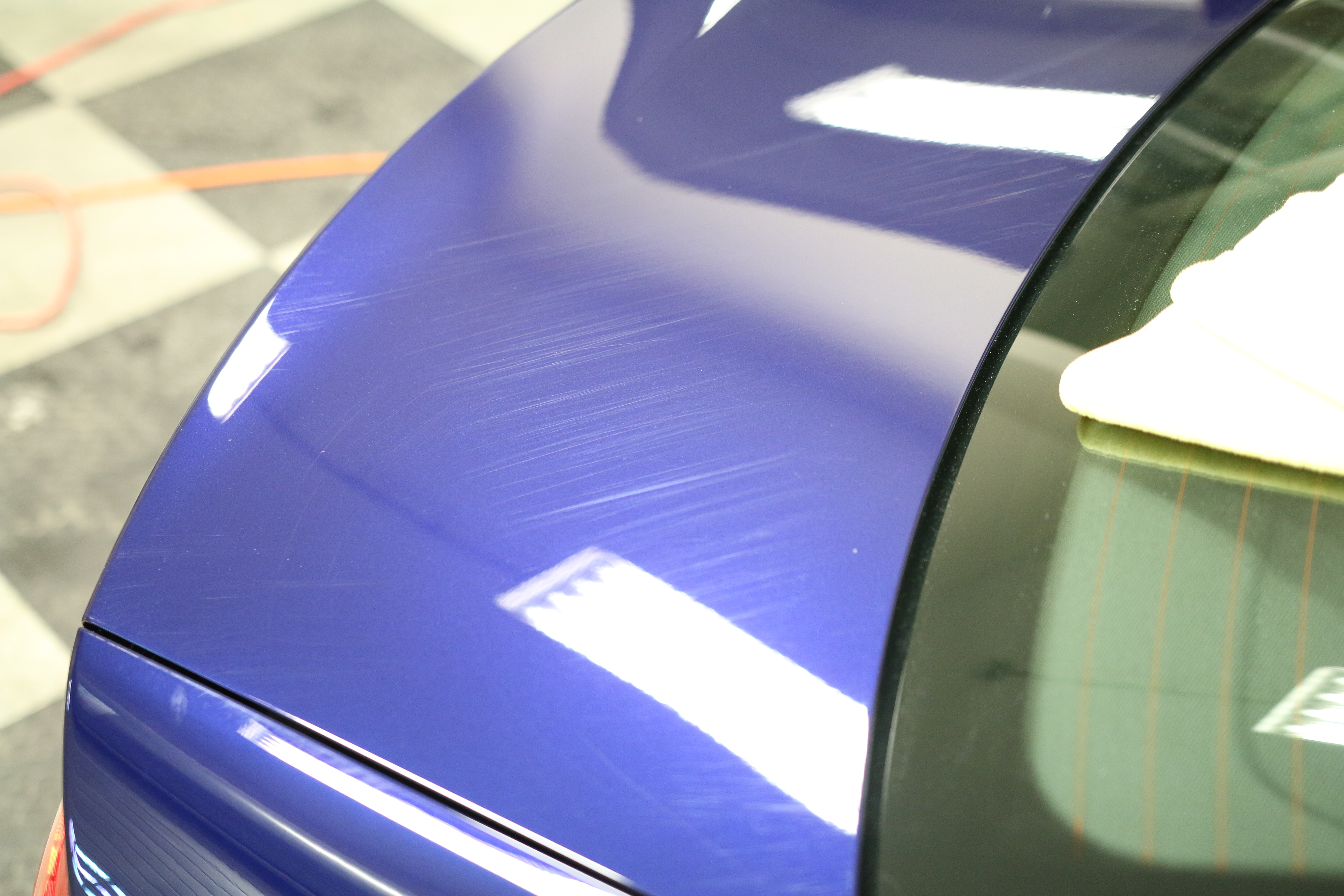

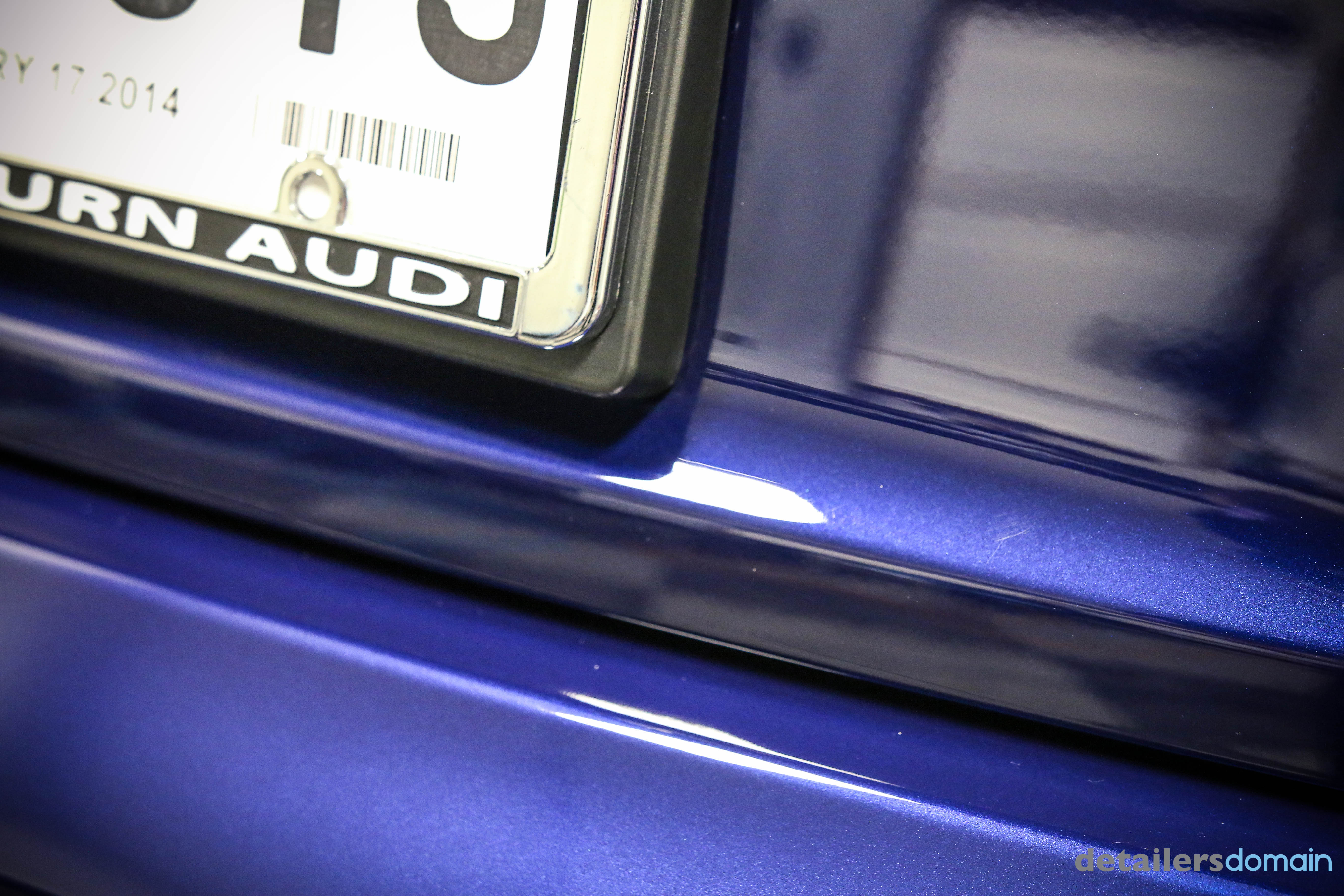

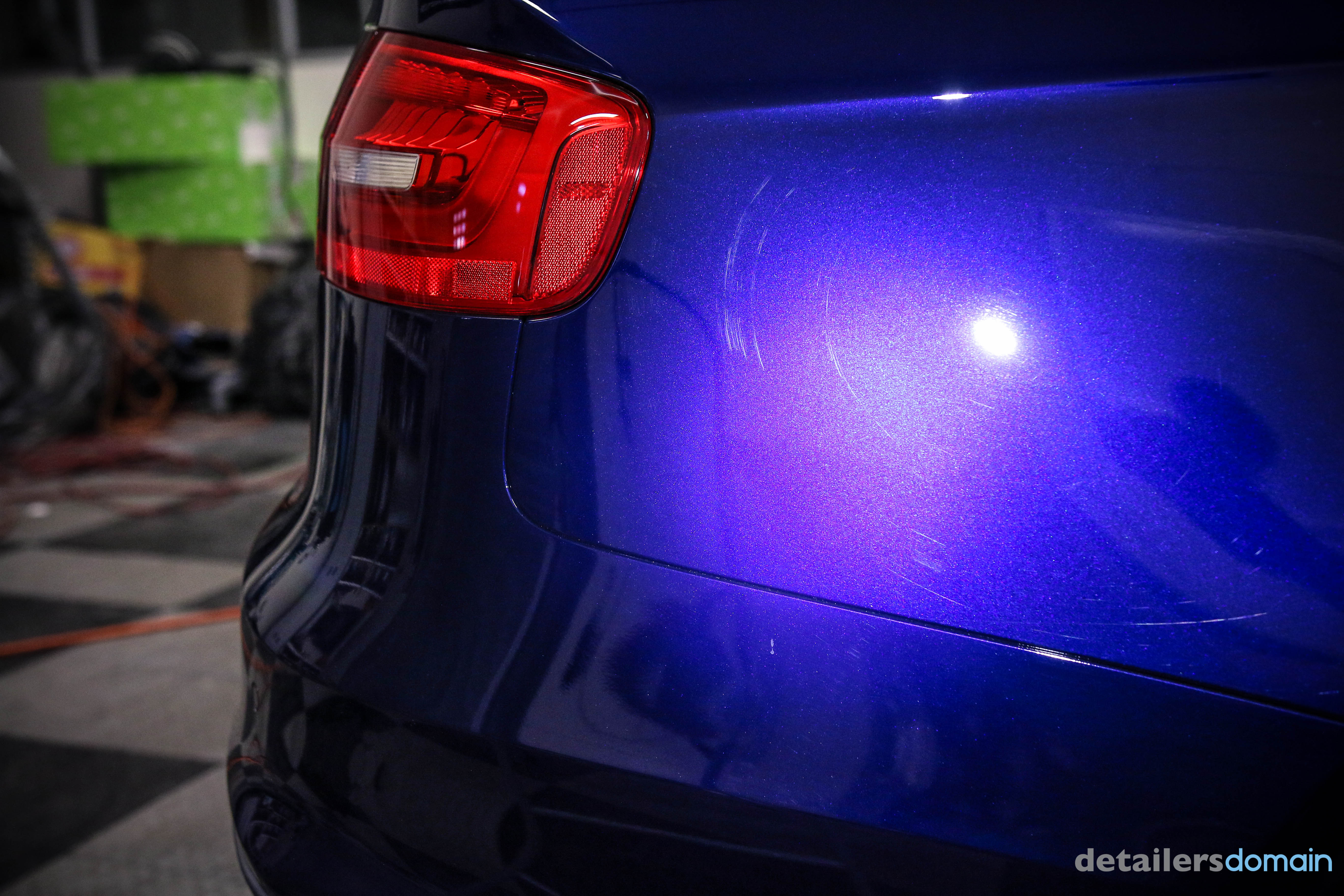

Imperfections on the rear trunk
After

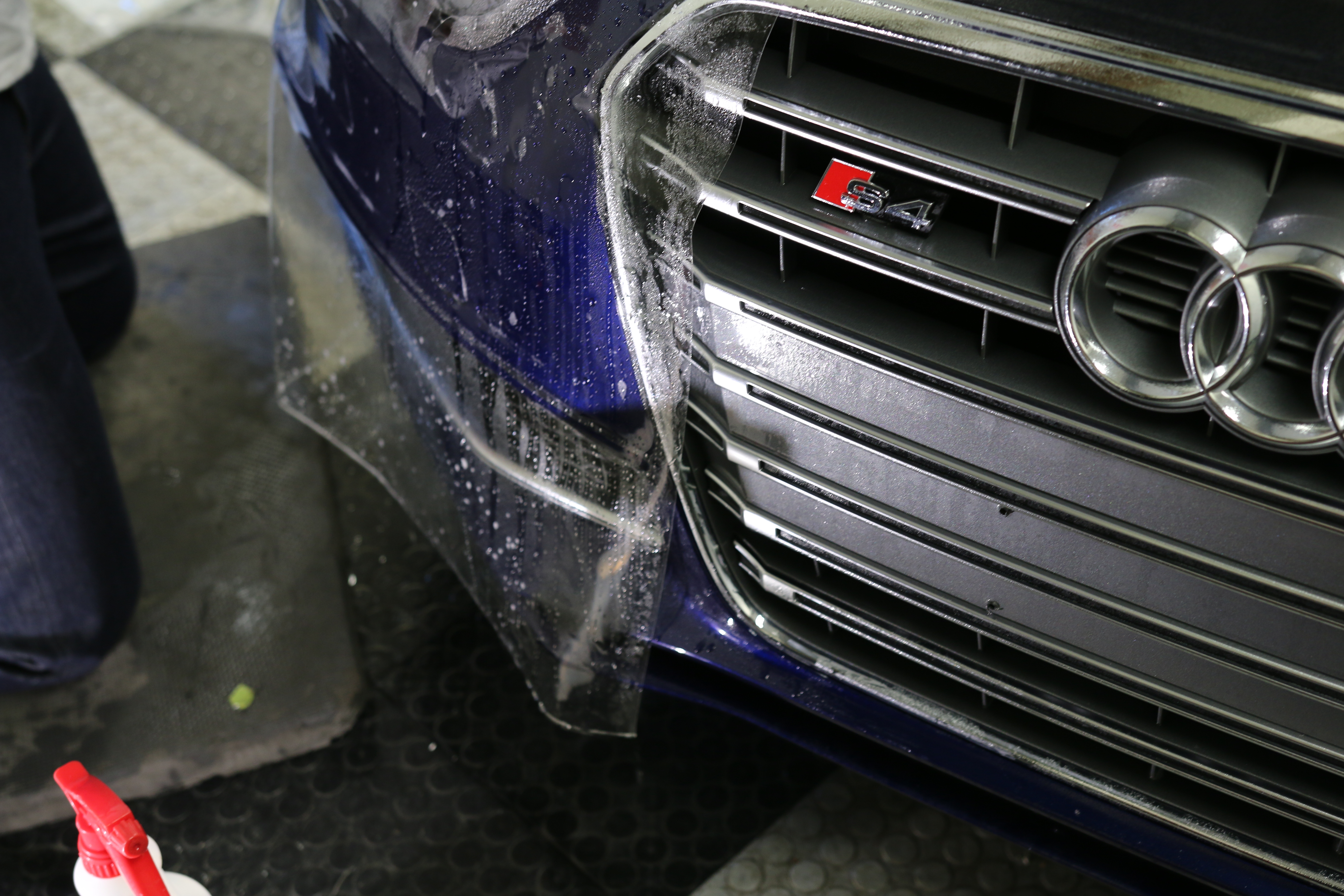

Xpel Ultimate Pre Cut Kit installation

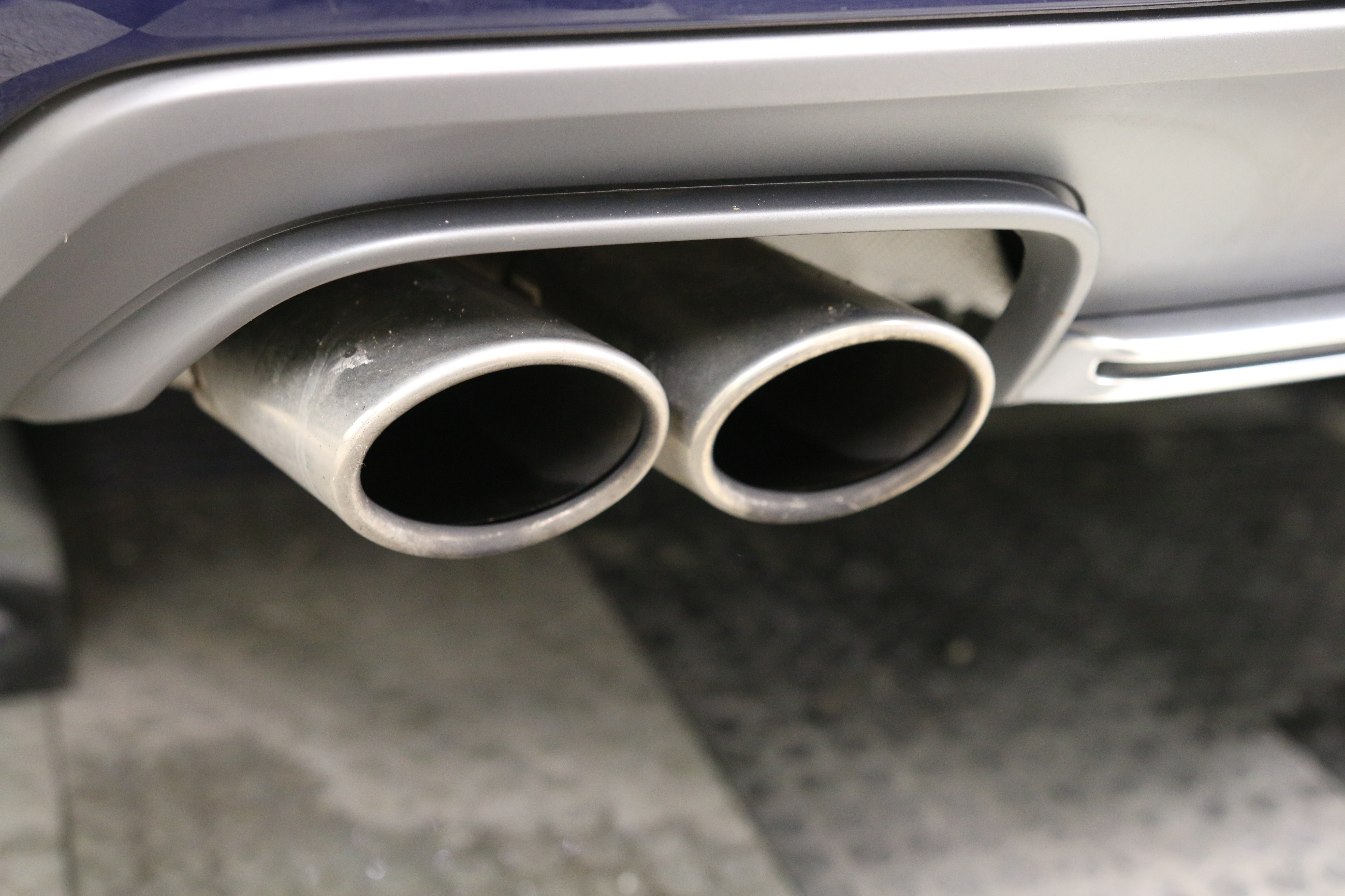

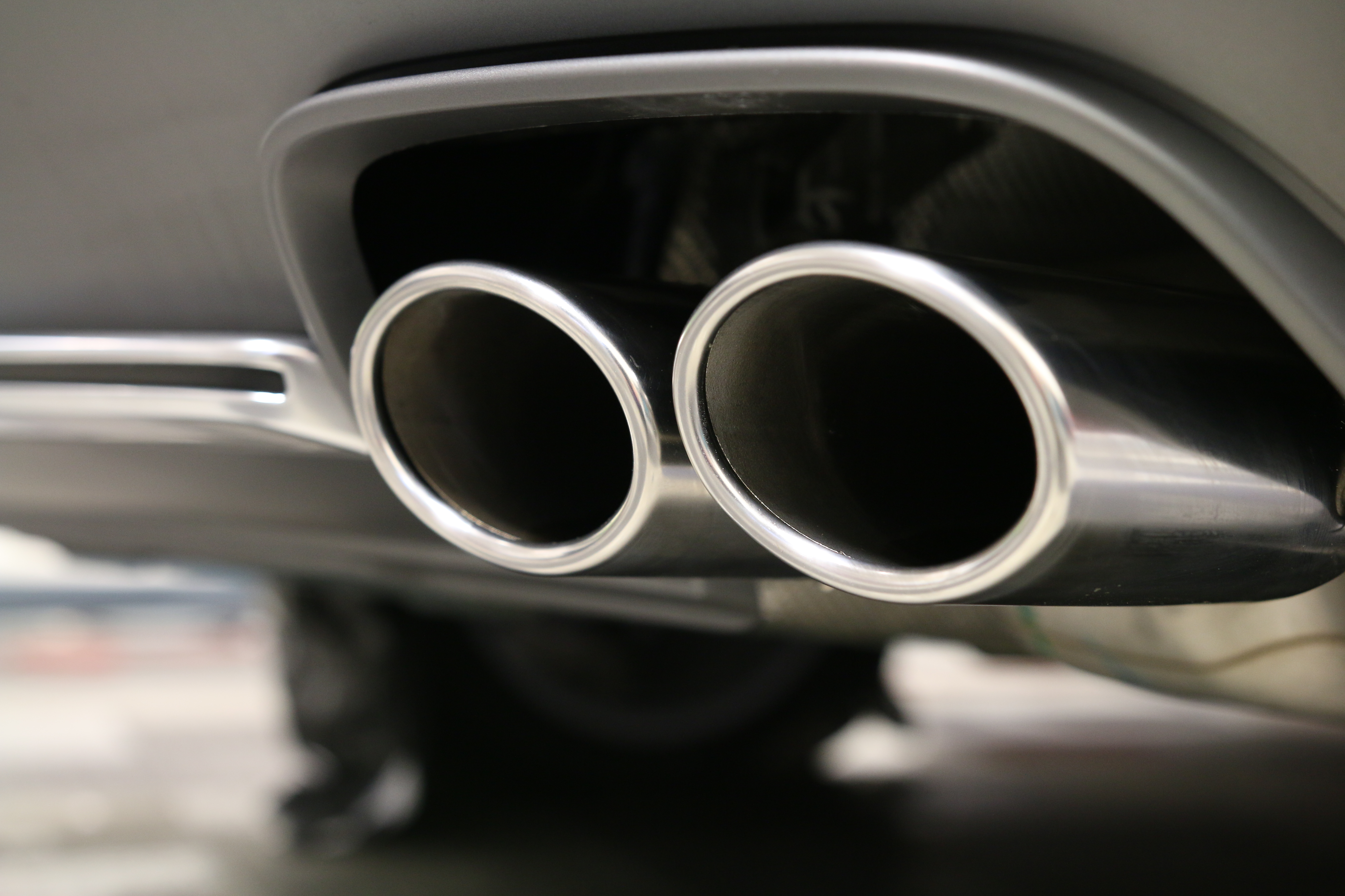

Exhaust tips before
After some Auto Finesse Mercury Metal Polish

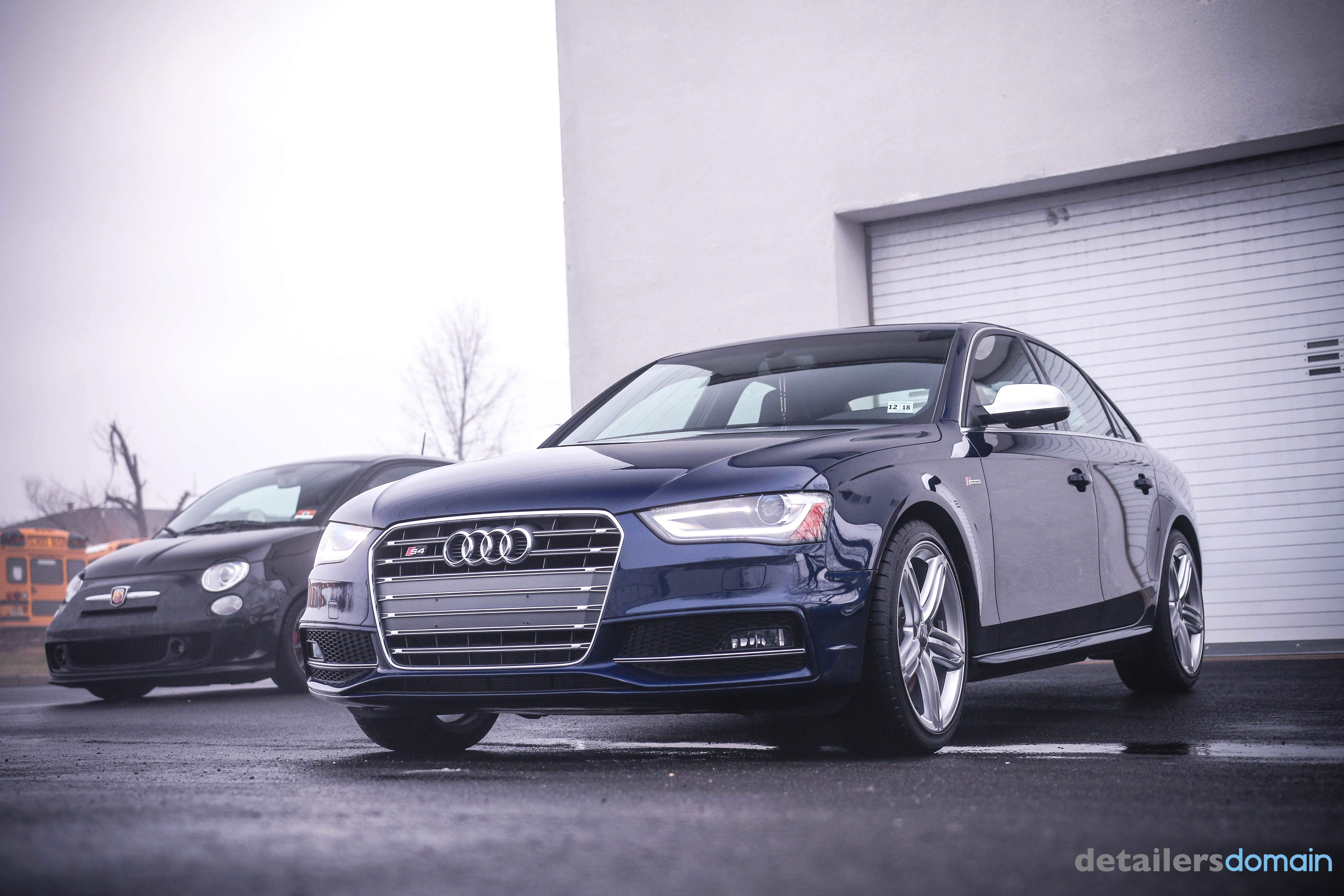

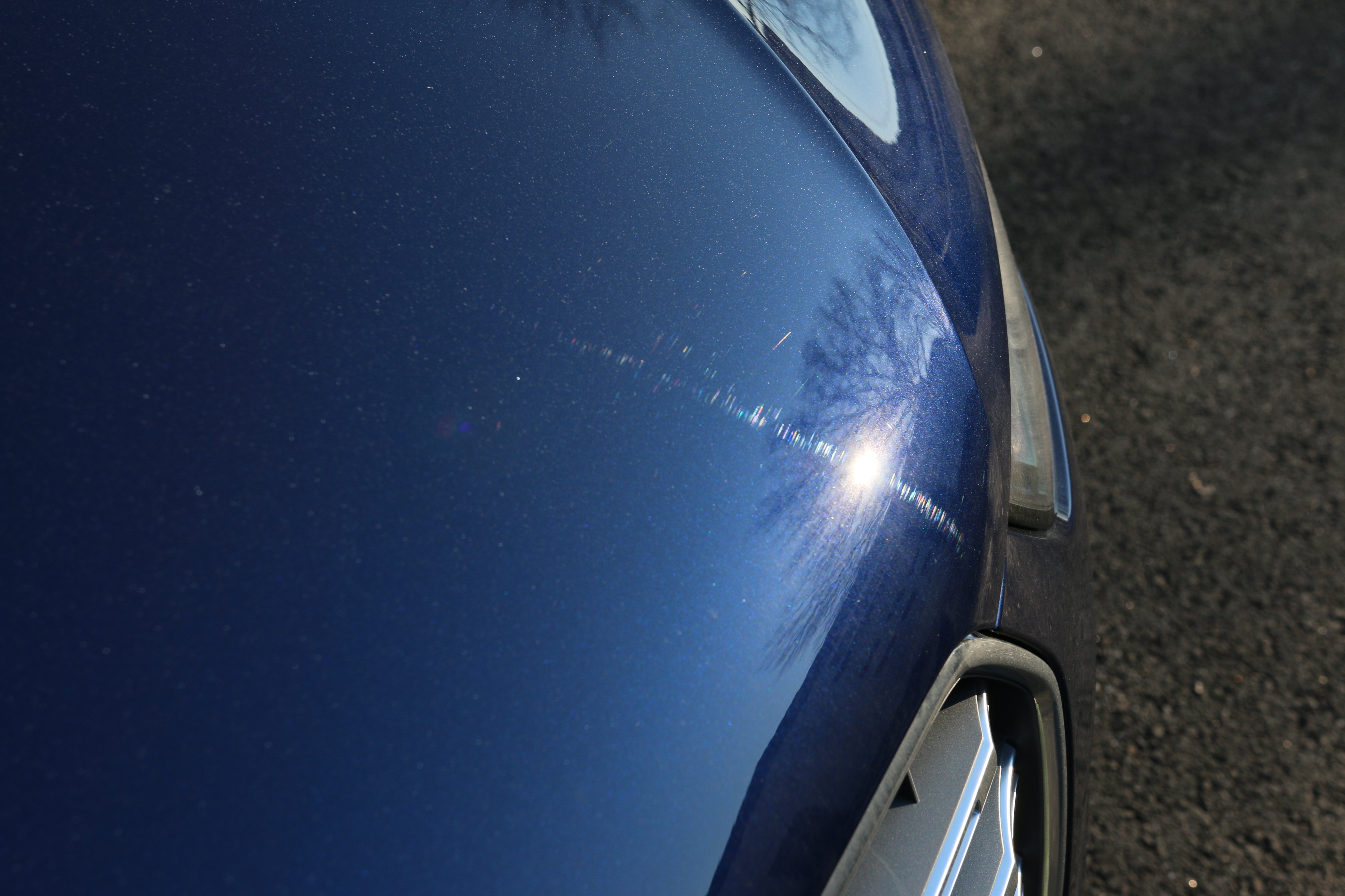

Afters shots
The old and new
A drastic improvement over the what the dealer delivered.
