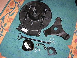

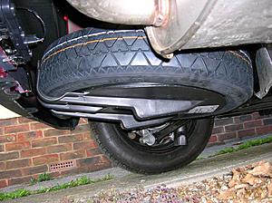

I have one fitted to my R57. It is neat, all body fittings and hole in boot floor were prepared and waiting for the parts, took 30 minutes to fit. Bought mine from a scrap yard including wheel. If you Google 'mini cooper spare tyre carrier kit' and select images you will see plenty examples. Will NOT fit an S as the exhaust is in the way, perfect for base models.

Here are the parts.

Fitted
