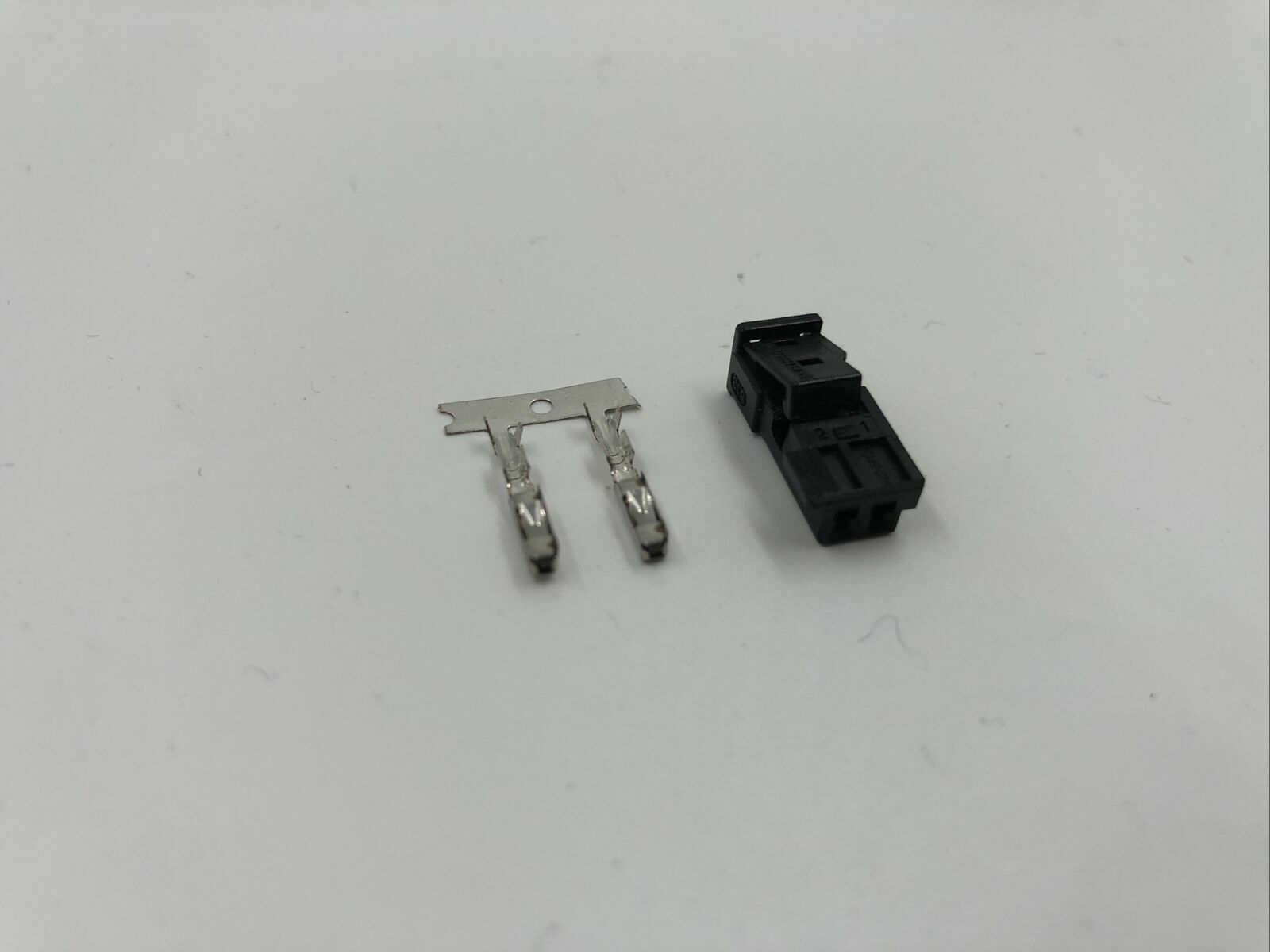

This is the closet i could find in 2 pol (pin) repair kit. These also work on the interior lights and door puddle lights.
https://www.ecstuning.com/Search/Sit...h/61132360043/
Do you have a better picture or part numbers on that little black plug on the harness side?

Ok found the plug end, its not in our etk but under tyco, Tyco part is sold to BMW group.

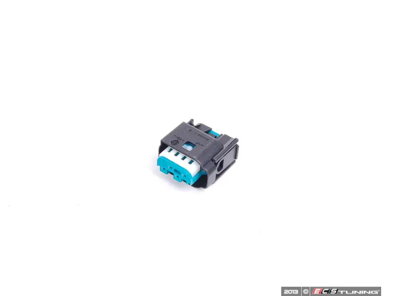

Third brake light / backup light R-57 Base
I've got the same problem with my R57 base convertible.
Light bar needs replacing and a new plug needed. I tried to resurrect the old one a few years back when the plug was froze on the terminals. Now it's time to do it again....hopefully the plug is available now?
It's a 4 prong staggered wire plug. I'm also looking for the wiring diagram to install the new plug. Can't find a color coded diagram in the manual.
The light part number is - 63247255925 ....any idea of the part number of the plug and can you order one for me (ECStuning)?
Thanks, Bill
Old Nov 22, 2023 | 09:12 AM
Posts: 36,768
Likes: 2,553
Hello
https://www.ecstuning.com/b-genuine-...138365356~oem/
This this is the one, older version is all black.
