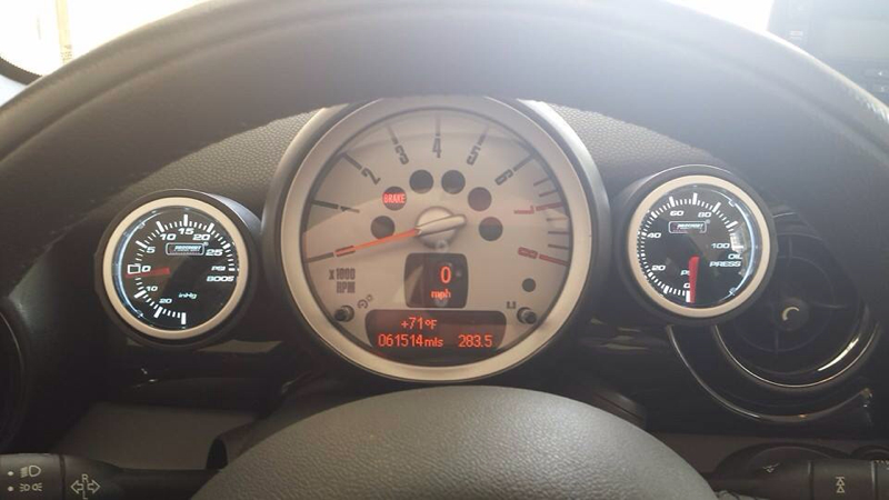

I removed mine with no issues. first get a normal tach housing. you can talk nice to a parts guy or eBay a one, we don't care about the guts we just want the shell. remove and open your tac/open-o-meter unplug the open-o-meter. place the guts of your tac in the new housing and reinstall.. you cant just swap the tac's they are unique to each transmission and model.
Attached Thumbnails openometer gauge replacement. anyone try this?-image-1026758733.jpg
