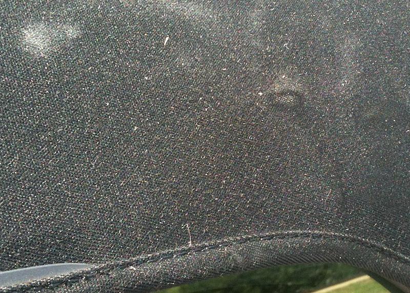

Here are the pics of my black roof showing the spots (rub spots are happening on both sides). First shot is the driver side, second - the passenger side [note the other wear areas], and third a close up of the dent but doesn't show up well.
I have the same rub and indent spots that yours had. I keep my top closed when in the garage and parked at work. I have over 327 hrs top down driving. My VIN is 89605. I recieved it in May 09.
If you or anyone has a service bulletin about the rub spots and the need for top replacement, please post those so I can show MINI of Sterling, VA. I am beginning the process to claim this and want all the information I can get.
Last edited by Derepente; 07-29-2010 at 01:17 PM. Reason: Add photos from iPhone 3GS-cropped

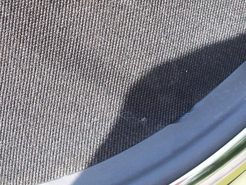

Help with Rub Spots
Help!! I need the wisdom from NAM. I have rub spots appearing on my 2009 MCS. None are serious but my concern is for the future. The dealership tells me that they are normal and even the tech from Mini USA agrees. Not only is the top getting minor rub spots, but the rubber weather stripping around the top is getting worn down. It's on both sides of the car, but the driver side is the worse. You can see threads of the fabric are broken from rubbing on the weather stripping. I believe when the top locks down there might be too much pressure causing excessive rubbing.
I only have 9000 miles with 113 hours of top down time. I am concerned with time this will get worse, thus I thought it would be smart to start having the dealership document the problem. The dealership tells me there is no way to adjust the tension of the frame going down...so I'm out of luck.
My husband is ready to fight, he's very upset to spend over $30000 on a car and have this issue. But I want to hear from the group, before "killer" tackles the problem. No use fighting a battle that can't be won. I had a 2007 mini covertible and had none of these issues. Is this just my car??? Or are others experiencing the same problem??
Sorry my pictures are not the best. I'm not so good with techinology and picture taking.

What would you like the dealer to do right now?
My opinion: This doesn't look bad (yet)
Suggestion: Every time you take the car in for service, make sure the dealer makes a note of the top's condition and your concerns.
Wait until car is almost out of warranty and then decide whether you'd like the dealer to replace the top. By then, the problem may be more obvious (and hard for MINI to ignore), there also might be a better fix for it, and the MINI tech will have some experience working on these R57 tops.
Sadly, I do not think anyone offers an extended warranty that covers the top fabric.
#31
I really wanted the dealership to readjust the frame or locking mechanism. What has me frustrated (especially my husband) is the dealership is not interested in helping...why???...because it's an issue with all 2009 convertibles. It's like an automatic out for them. So I was trying to find out from the group if others have same problem or if the dealership if BSing me.
I did check about the extended warranty...your right...not covered.
So I have the dealership documenting the problem, so when it gets worse they can't give me the "you never mentioned the problem".

So your 2nd and 3rd picture look exactly like what my 2009 looks like. I had my top relaced under warranty due to rub spots that had rubbed through many of the threads. The Factory Rep did agreed with my findings and they replaced the entire top under warranty. However, the same rubber indentation you have in Picture 2 and 3 are exactly what is on mine before and after the top replacement.
One thing I will add is that the replacement top appears to be made from a different thread than my original one.

Originally Posted by zanary
... However, the same rubber indentation you have in Picture 2 and 3 are exactly what is on mine before and after the top replacement.
