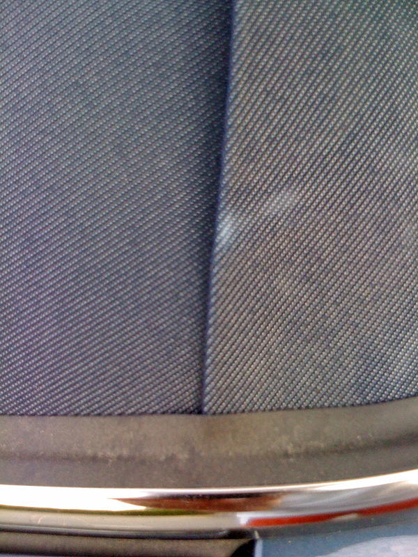

Pictures rub spots on top : 2 weeks old !!!
Here are the pictures which speak for themselves, both spots are on the right side. I washed the car first time afterwards and now there are less visible but still visible. If the top rubs at this speed , after 6 months it will have holes !!

Certainly not normal (at least I surely hope not!) What did your dealer say when you took it in Friday?

stefspain-
That certainly does NOT look normal.
Consult your dealer.

I agree with Jeremy and Mullman, that is not normal. I don't know if you've been to the dealer, but I'd check one thing that I came across last week. As I was loading stuff in the boot, I raised the Convertible top and the shelf to put in some large stuff that would not normally fit the small boot opening. In doing so, I also tossed in some small item which appeared to be round. When I wasn't looking, those items had rolled in the spare where the convertible arm top would normally occupy when you're topless. I cought that at home, when I was unloading the items from the boot.
It's just a guess, but that rub may be caused by something that may be in that area. From the pictures, it looks like you're only experiencing the rubbing and/or discoloration on the side near the seams. Maybe something rolled in there?

Hmm, after I wrote that, I remember reading a bulletin about hard contact for the convertible top when it's open. I went back to the system, and captured two Mini Technical Service noticed that the dealers received in May.
I don't think the first one applies, but the second one is really about Noises when the top of down, but it does say
"...Hard contact between areas of the convertible top that have some movement when in the open position, caused by tight tolerances or incorrect adjustments..."
I'm wondering if this hard contact could be cauisng the rubbing/dis-coloration of your top you're seeing.
See the Word 2003 document I attached below. If you haven't been to your dealer, ask them about that Technical Bulletin as well. Maybe it's somewhat related.

its hapen to alot of mini....its from rubbign against each other when folded down...i put a felt cloth between them so thta the rubbing is reduced

Known problem : top will be replaced
Car has been with the dealer and has been inspected by a "Puma" expert and a rep from the factory. The problem is known and they will replace the top but the tops now being produced still have the same fault. So they are working on it, first to get the cars on the production line fixed and then calling the affected ones back. The whole top , mechanism, inner liner and soft top will be replaced before .... end of the year. So looks to be again the same issue as they had with the R53 in its early days.
