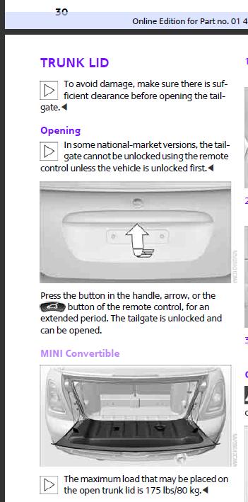

Are you holding down the unlock button on the fob long enough? I tested mine out this evening, and also found this section in the owner's manual.

Yeah, I re-read the manual too, and you can hold the button down forever and it doesn't make a difference.
