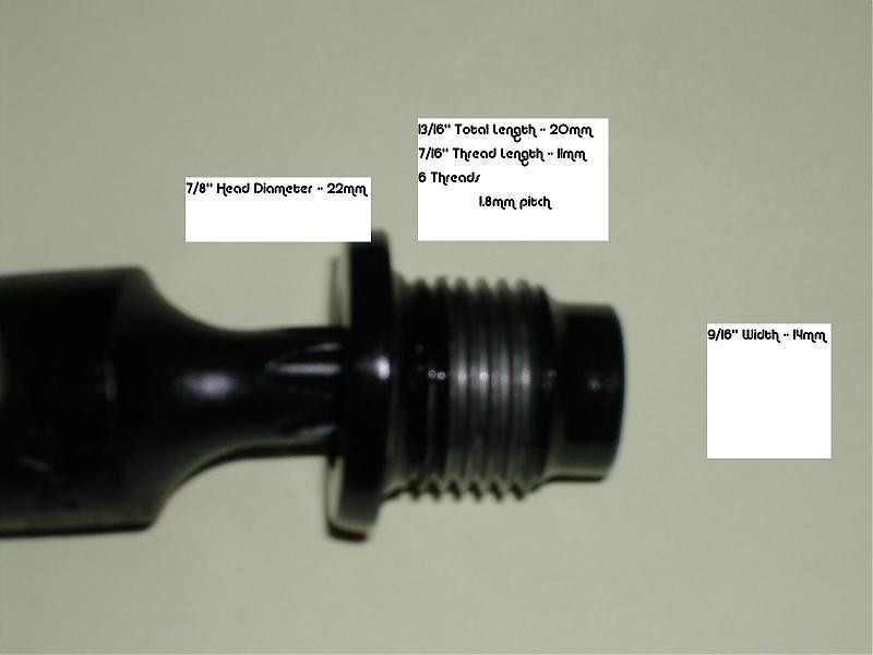

Ok, changed my oil, got messy, took pics and measurements. The drain plug is 14mm wide, 20mm long with 11mm of thread and 6 total threads. I calculated the ptich to be 1.8mm, if others are getting 1.5mm I might have mis-measured slightly. Also, the head is 22mm in diameter and uses a T-50 bit ( ).

Hopefully you mis-measured, as M14-1.5 is an international (ISO) standard for metric threads. 1.8 mm is not even listed in the book. I doubt if BMW would get away from the standard and design their own thread for that purpose, since it is only a drainplug. It would be very costly for them. Did you use a thread guage?. Anyhow thanks for the info.
