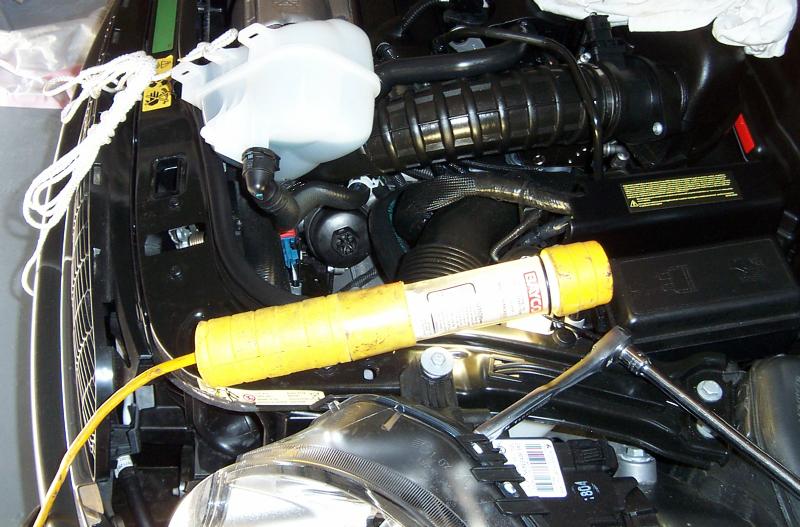

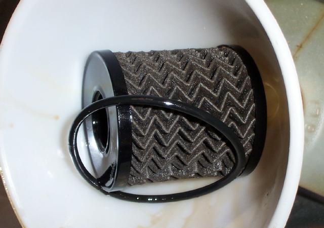

changed my oil at 1200 miles
This is my first Mini so my first time changing a cartridge-type filter. I followed Ryephile's lead, but didn't need to move the turbo inlet hose, just the coolant tank (see pic). I used a 1 1/16" shallow socket and two short extensions. I was also able make a long extension and swivel joint work.
The vertical drain plug is a PIA. Ryephile's not kidding. I got oil all over my tools and I can usually keep them totally dry with a standard drain plug. Wearing gloves really helps you keep clean!
-JL
Attached Thumbnails DIY Oil Changes?-filter-housing.jpg   DIY Oil Changes?-filter-and-o-ring.jpg

Thanks for posting your impressions and pictures jlevy! Good to hear only the coolant tank needs to be moved; I'll remember that for next time. I hope you cleaned up your tools after getting hosed down in the dirty oil, LOL! I'd love to meet [and yell at] the person that designed that drain plug, sheesh.
-JL
What is involved in moving the coolant tank? How is it released from its bonds? Don't have one to look at (still in England) so I am curious.
From the photo of the oil filter it looks like there are lots of little sparkly bits of metal on the filter? Is that right? What is your assessment of how clogged it was? Would it have been good for the full time to factory service?

There's just one 10mm head screw and the coolant tank lifts out of place. Be sure to keep the two coolant lines hooked up or you'll have a mess!
The dirty oil filter is probably showing the paper fibers; when I removed my oil it looked reasonably clean; like it only had a few thousand on it [instead of the 400 it actually had on it]. There were no visible metal bits whatsoever.
The pic of the filter looks sparkly, but there was no visible metal in mine either. I pulled the pleats apart and looked pretty carefully under a bright light. I also rubbed a clean paper towel in the old filter and looked to see if any fine metal transferred. There was none that I could see.
