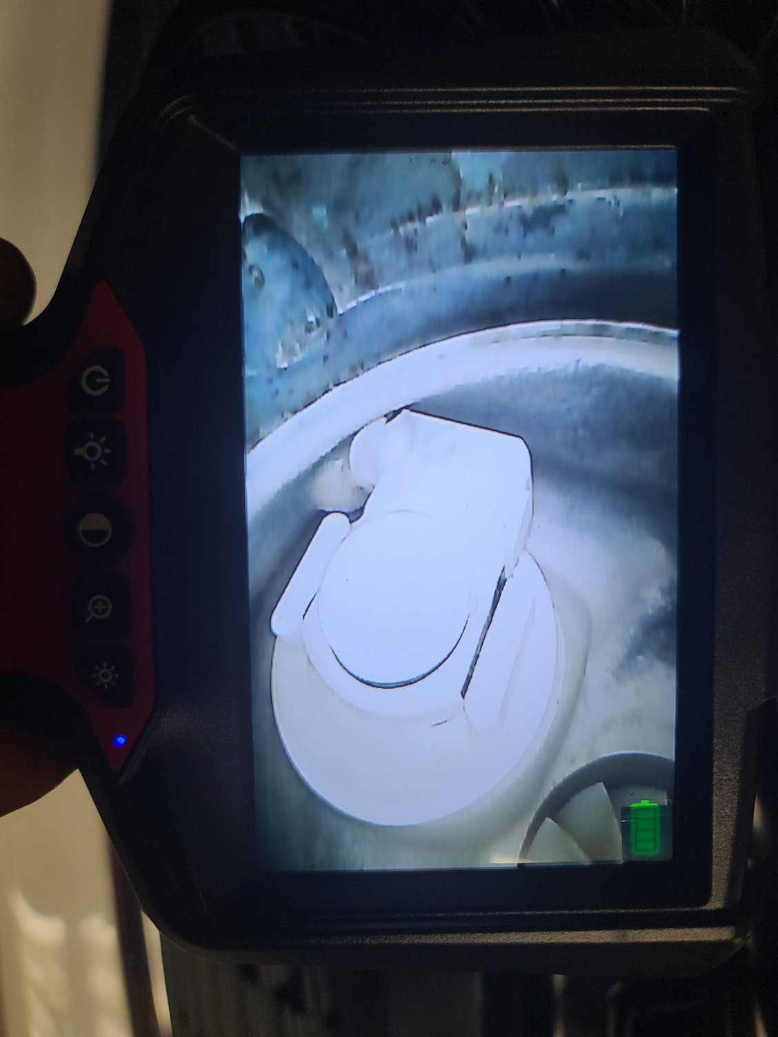

we also ordered a inspection camera amd i have a vacuum pump so ille pop out the 02sensor and see if the wastegate seats under correct vacuum too when he brings it back again.
and to check the pcvthe do I suck or blow through the back port ( passenger side rear of valvecover) to determine if the pvc is sealing correctly?? Because i remember my n14 i had limp issues too and the stock valvecover was bad and the aftermarket one was too UNTIL I trimmed the pcv plunger because it was a tad too long and caused a pcv leak, so I wanna make sure that this isn't a pcv issue.

Originally Posted by Maybe, maybe not
Did you mean Bimmerlink? Were any of your other scan tools capable of recovering BMW fault codes?
none ! I don't ever even see the cel light come on in the middle under the gps unit , only the low power limp light on the tach.
I've tried torque plus , bimmercode, my handheld scanner , my brothers ghetto handheld , carly and inpa but inpa wouldn't connect at all.
