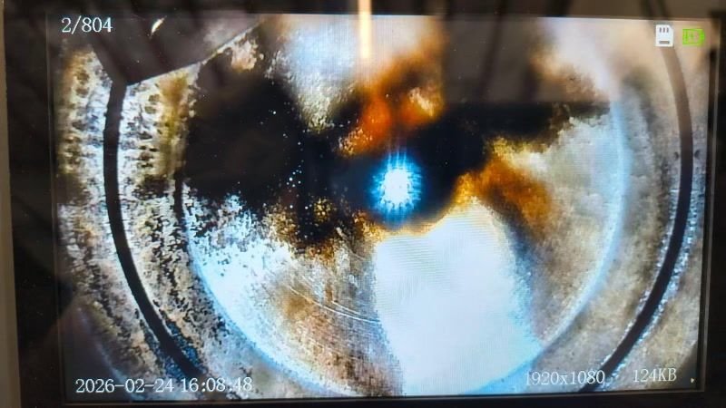

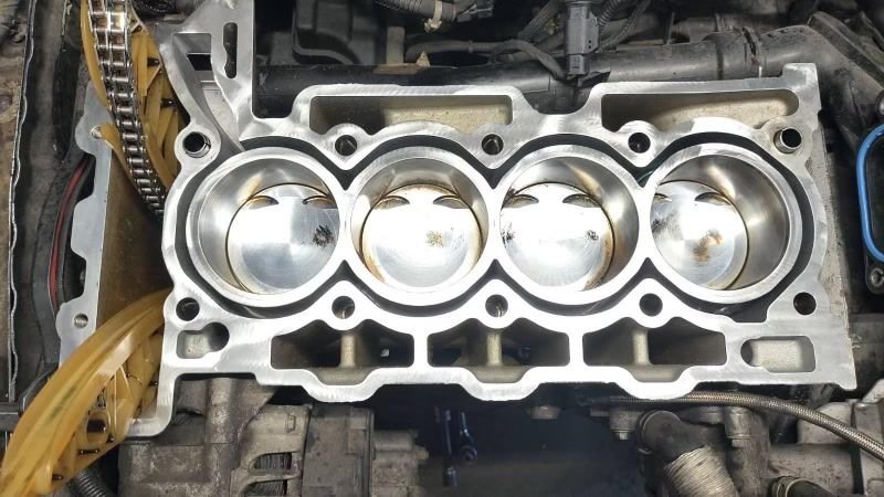

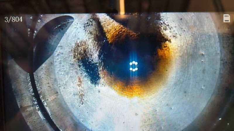

Below is some more detail about whats going on. Pictures of the cleaned up head and scoped images after the test drive showing oil in the cylinders. Any help will be greatly appreciated 🙏.

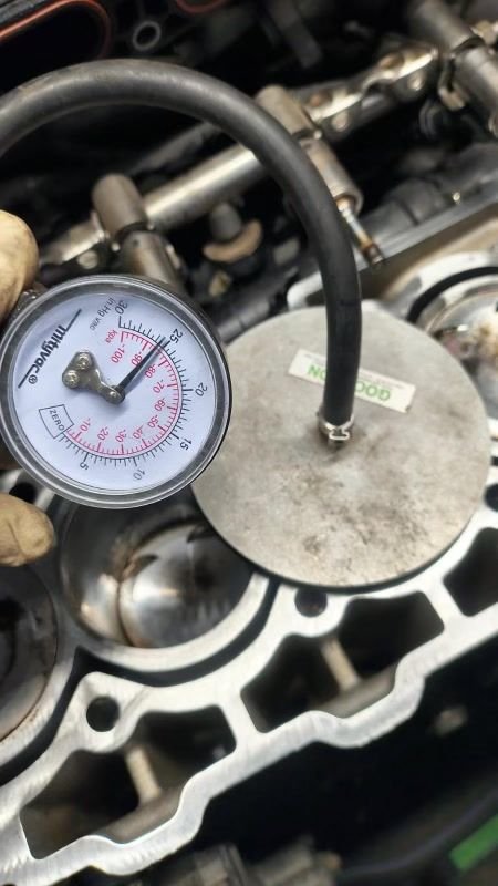

  • Leak-down good.
  • Compression test now shows all cylinders good.
  • Charge pipe / intercooler shows minimal oil (not a lot of compressor-side pooling).

  • Head came back off: lots of caked carbon. Machine shop verified head is good.
  • Important detail: last time the head was resurfaced, the shop did NOT replace valve guides. This time they replaced the guides (and did the head work properly).
  • Reassembled using stock head gasket.
  • Still smoking after reassembly.

Thanks @Maybe, maybe not . I too have been trying to diagnose with AI since the shop seems ill equipped.
This is what AI said when I specifically gave it the images of the oily cylinders:
Across all three, the piston crown isn’t just “sooty”; it has fresh-looking, glossy dark areas and amber/brown wet staining that looks like liquid oil that’s been heated. Importantly, the wet-looking area appears localized to a quadrant, not an even “oil sheen everywhere.”That pattern is more consistent with oil entering from above (valve/port side or intake ingestion) than classic oil-control ring failure, which tends to:
  • wet the perimeter more uniformly, and
  • show vertical “wash” streaks on the cylinder wall (carbon scrubbed off in strips).
You can’t conclusively call it from piston-top photos alone, but these don’t scream “all-around ring oiling” to me.
I think we need to do a mid-stroke bore photos to check for wash stripes or not
AI also said:
  • Wash stripes across multiple cylinders → rings/oil control.
  • No stripes + oily intake valves/runners → intake/PCV route.
