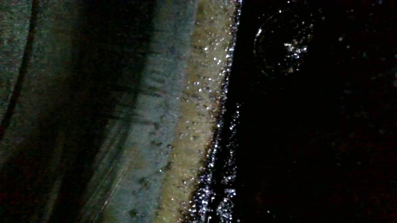

yesterday on my 100 mile drive to a music store I got a blinking engine light, misfires on 1 and 3. Opened up the intake, to find it covered in carbon and oil. Used our camera to look in the cylinders and they’re filled with oil. (Even the good ones)
my guess\hypothesis is that the piston rings went and the pistons have been burning oil for over 10k, and either damaged the head gasket, melted a valve or two or both.

Cylinder 2
Cylinder 2
This was on the clean cylinder 2 and I have no idea what it is
Cylinder 3
Cylinder 3
Cylinder 3
Cylinder 3

So I’ve found that the issue is actually a melted valve, would doing a valve job and head gasket replacement be a sound enough fix for this? You mentioned the bottom end is sound most likely so piston rings and pistons would be excessive. Obviously I’ll be doing a timing chain again, that’s a no brainer, but what else should I investigate?
