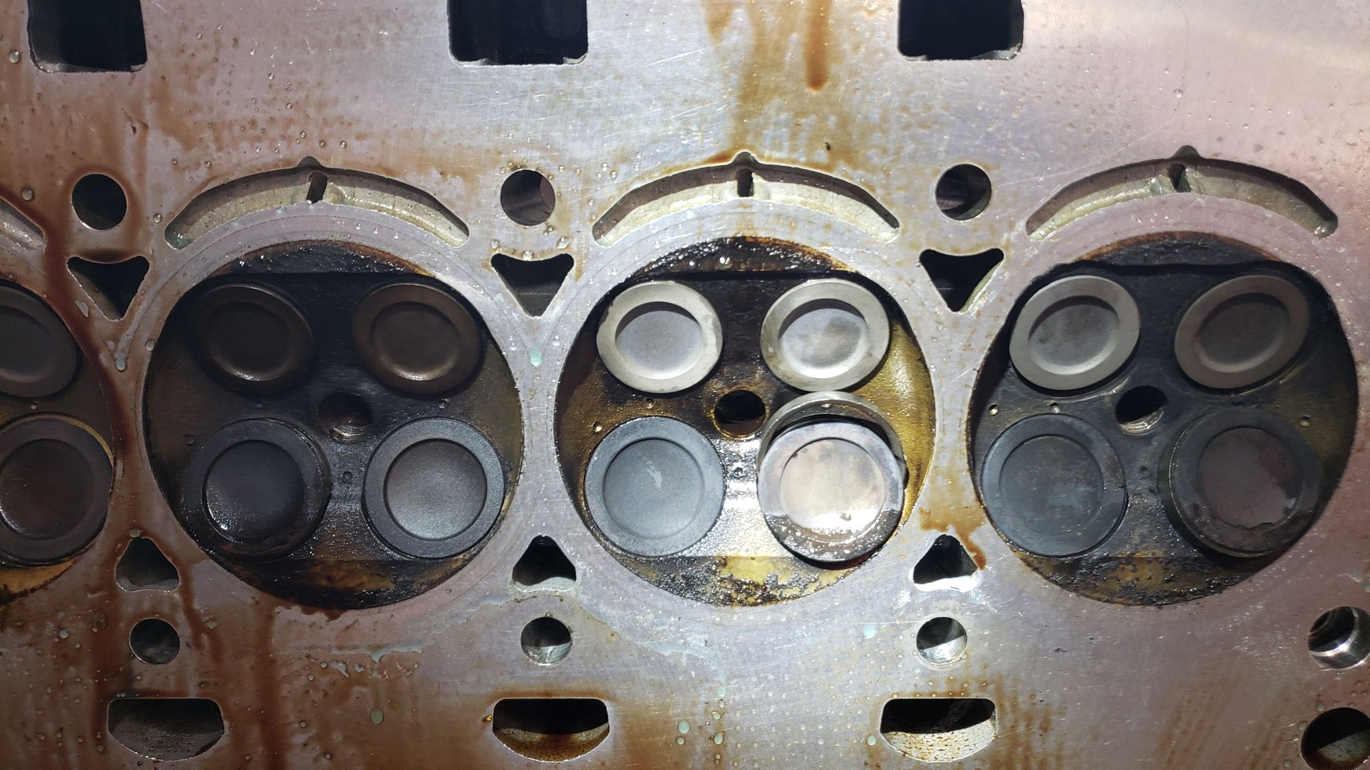

Thank you for the answer. Unfortunately when I replaced timing chain and cleaned oil pan and oil pump I found out that it doesn't start anyway. I decided to check compression and here it is:
0, 180, 180, 180. Zero compression in first cylinder. So probably something wrong with head or piston. I'm going remove head and check it.

I take it those numbers are in cylinder order 1-4.
Pull the #1 spark plug and use an articulating bore scope (Amazon) I'll bet you've dropped a valve seat, or you've have a valve with a hole in it.
One of the R56s I restored had this problem with the #4 exhaust valve ... no compression on that cylinder for sure; I found this by doing a leak-down test.
My current resto job had this problem ... dropped valve seats.
