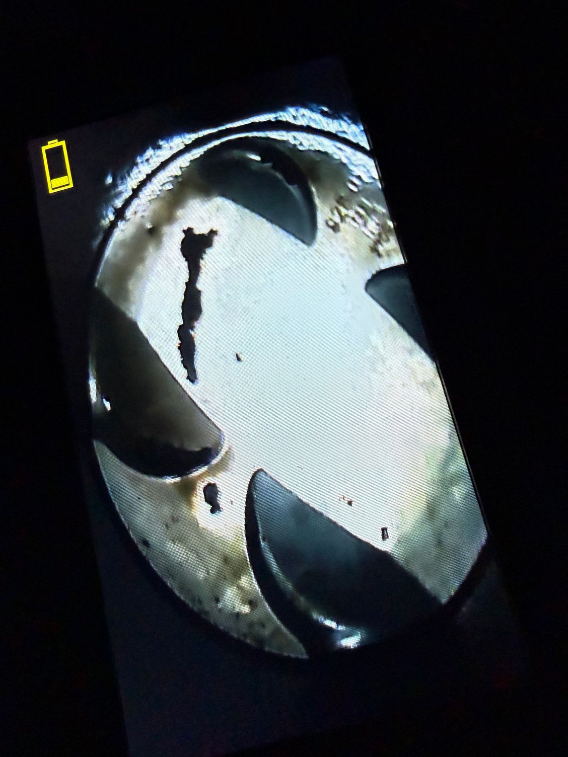

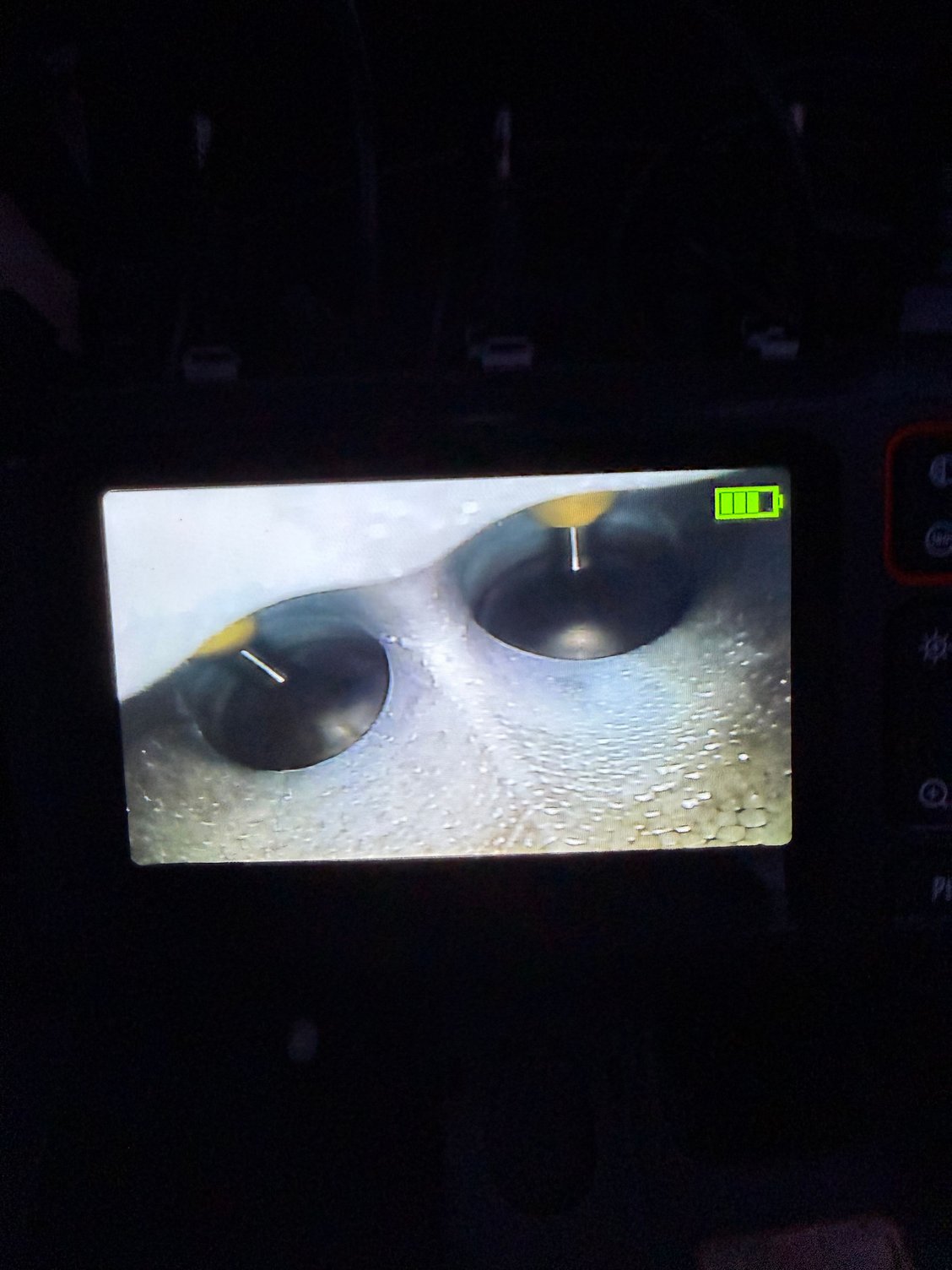

I recently bought a mini cooper 1.6 N12 for a good price. It had a misfire code on cylinder 1. Everything else seemed in perfect condition and it didn’t have any other codes than the misfire code and a lambda sensor code. I drove it home for about 100 miles. It didn’t breakdown, and honestly did it pretty good. At home I have had a look at multiple things. Starting with the coils, spark plugs and injectors. I swapped the coil, spark plug and injector from cylinder 3. Cleared the codes and tried again.. this unfortunately didn’t help as the code was still present at cyl 1. I then had a look inside the cilinders with my endoscope, and I saw that cylinder one looked completely clean! Like shiny clean. Meanwhile the working cylinders looked black. I then stuck my endoscope into the injector ports of cyl 1 & 3. I did this to see if the owner was right about the valves being cleaned professionally (Not just an additive in the fuel). And to my surprise they were all really clean. Not a spec of carbon. I also couldn’t see any problems with the valves them self. My endoscope doesn’t allow me to tilt the camera up so I cannot inspect the valves from the bottom. I asked the original owner for a summery as of what happened and he sent me this:

Your #1 cylinder piston is washed; a very accurate way to confirm this is to take an oil sample and send it to either Blackstone Labs or Speed Diagnostics and explain to them your problem; you'll be looking for fuel dilution in the engine oil. Even if the injector is functioning electrically, you are probably unaware of what the spray pattern looks like or if the injector is closed (not leaking). N12 injectors aren't very expensive. Continental is the OEM supplier to MINI for the injectors. Best price is at Rock Auto. If your injector is allowing too much fuel into the cylinder, that can cause a misfire from a fuel mixture that is too rich. I've seen it happen with a stuck open injector, and the wash of your piston makes that a high probability. On a second note; you'll want to change your engine oil yesterday. Oil with gas in it is not a very good lubricant.
