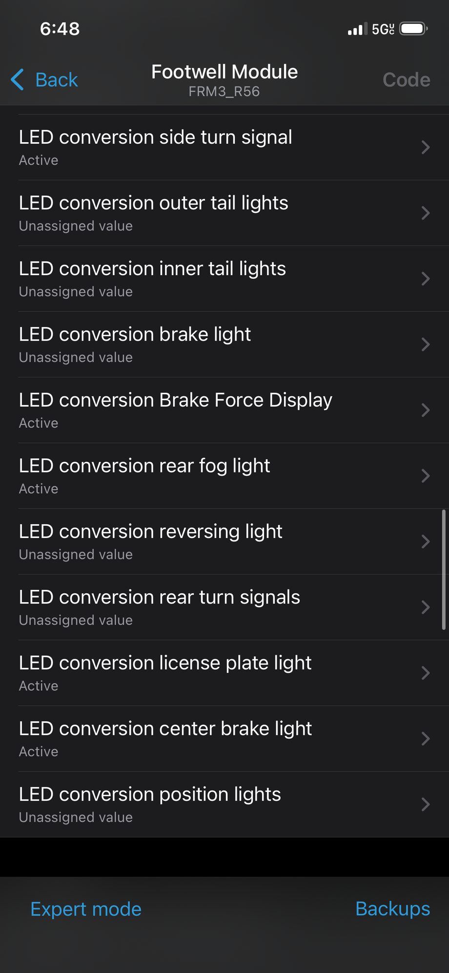

I swapped out some of my halogens to LEDs however BimmerCode options are not matching the lights actually on the car.
Which one of these labels would be considered the driving PARKING lights (above the fog lamps)? I tried setting the "position lights" to active but it's still showing a bulb out message.
Also, is it safe to convert everything? From what I understand LED conversion stops PWM so lights don't flicker and the startup dead bulb check. But would it cause an issue if I coded LED conversion for a bulb that's still halogen?

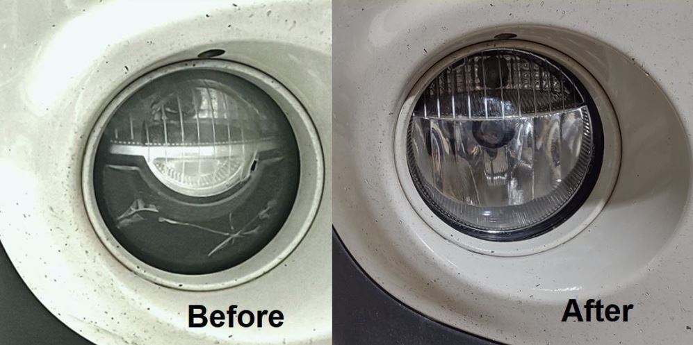

I don't quite follow. My lights look like the after picture. I'm talking about the parking lights, which are the upper small portion, with the fog lights below them. There is no option labeled parking lights in BimmerCode...
