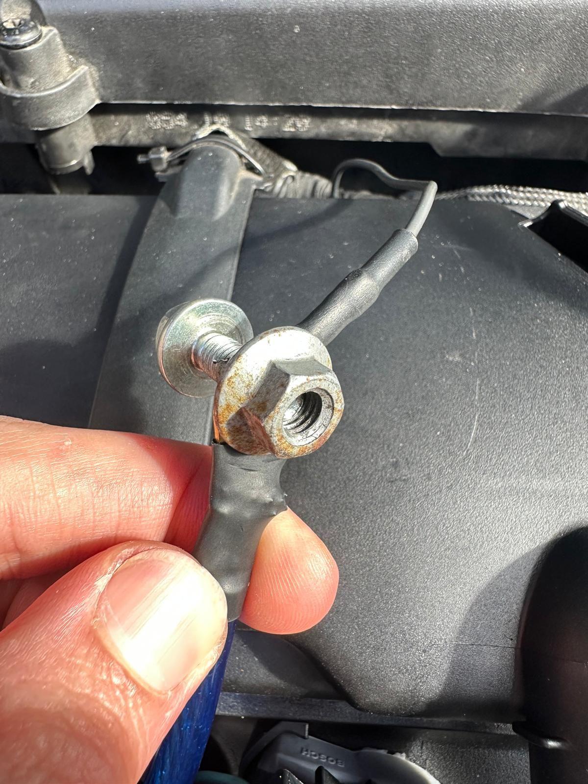

Update - ECU Blown, is this ground OK?
Back again to update this thread because there was 0 information online about this when I was searching last week.
Yes I blew the ECU by starting the car without ground on the main harness. The code is aligned with this. ECU was sent off 9 days ago and is being returned to me tomorrow, cost me £330 from ECTesting in Derby UK to have it repaired.
Needless to say I'm about nervous about putting it back in. Is this a sufficient ground connection to get it to the garage? The ground wire is wedged onto the bolt, and the nut is as tight as it will go, with the other wire sandwiched against.
Painted surfaces are high risk grounding points. Connect the blue cable directly to the battery ground connector.
Just to be safe, thoroughly wire brush the metal mating surfaces of both cable connectors and then tighten the nut-bolt fastener.

Aww man I'm sorry the ECU didn't survive.
I'm sure that ground would be ok because the bolt passes through the unpainted hole but ya might as well go to the battery ground or the ground on the motor mount. Passenger side.
