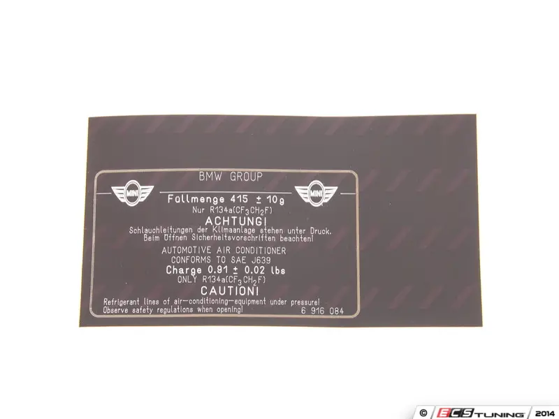

This is the sticker i have on my original hood. 2012 R58 JCW with the N14 engine.
https://www.ecstuning.com/b-genuine-...n/64506916084/ Thats the part number in the bottom right hand corner
But my sticker says Fullmenge 460 +- 10g so at one point they updated it to 415. Picture was in 2014 time stamp.
Hope that helps.

Jun 27, 2025 | 08:10 AM
Quote: This is the sticker i have on my original hood. 2012 R58 JCW with the N14 engine.
Hope that helps.
Very interesting and helpful.
For the label shown in your picture, the R134a weight in grams and lbs matches (correct conversion), unlike my label.
Does your sticker with Fullmenge 460 +- 10g show the correct conversion to lbs (1.01 +/- 0.02 lbs) or the incorrect conversion (0.91 +/- 0.02 lbs) like mine?

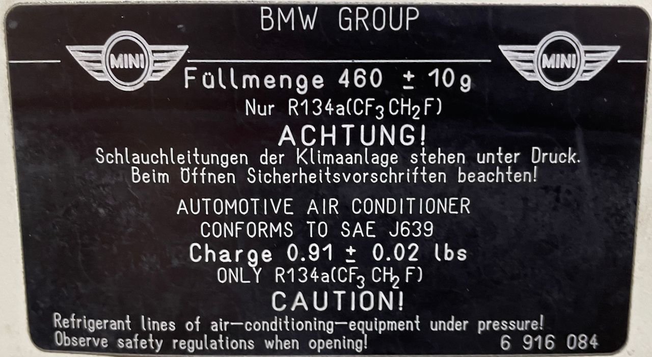

Jun 27, 2025 | 08:38 AM
Reply 1
Jun 27, 2025 | 08:46 AM
Haha...incorrect conversion just like mine. Thank you!
I would assume that there are some DIYers and shop techs who were misled by the label error and improperly filled MINI A/C systems with the incorrect weight of R134a.
Reply 0
Jun 27, 2025 | 08:57 AM
Yep, my guess is it was wrong till 2013.... then MINI got a new batch in with it correct! Hence our update time stamp photo
So ever Gen 2 MINI needs and updated sticker. I would just lay it over the old one.
I am surprised their was not a recall for an updated label???

Jun 27, 2025 | 09:22 AM
Please correct me if I'm wrong. In North America, we're currently not absolutely certain which R134a label is correct, your original label or the updated label.
In your update 2012 label, the R134a weights in grams & lbs match (415 g equals 0.91 lbs).
In your original label and my 2012 original label, the R134a weights in grams & lbs do NOT match (460 g does not equal 0.91 lbs)
In George's German 2010 label, the R134a weights in grams & lbs match (460 g equals 1.01 lbs)
Is the proper R134a charge in North America 415 g or 460 g? Do you see what I mean?

Jun 27, 2025 | 10:36 AM
Hello
2012 R58 JCW label, the R134a weights in grams & lbs dont match 460 and 0.91
New label for my car is 415 and 0.91 which is the correct label as that's what we sell. https://www.ecstuning.com/b-genuine-...n/64506916084/
The label company messed up for the stickers in production. They combined USA and Germany labels.
Reply 0
Jun 27, 2025 | 01:04 PM
Thank you so much for taking time to respond to this thread and for providing accurate information.
Just to verify, the required R134a charge for your 2012 MINI and my 2012 MINI is 415 g/0.91 lb. Is this correct?

However, based on ESCTuning's input, the metric weights were incorrect and the imperial weights were correct on the original hood labels in North America. Who would have thunk?
