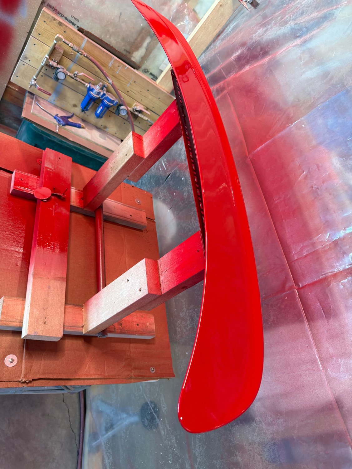

most recent my R58
What's the condition of the area that needs paint? Rust?
A bit of confidence, a few YouTube videos and you’ll be off to success.
it’s not hard to do and when you take your time, it’s not hard to do it right
