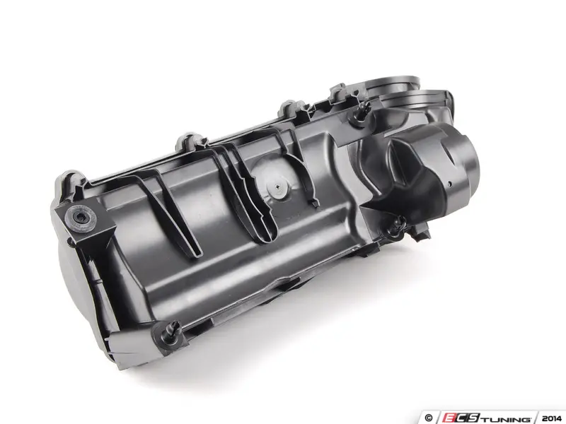

Yep these things like to pop off the intake manifold and stick to the pegs on the airbox.
https://www.ecstuning.com/b-genuine-...11617593928kt/
Or
https://www.ecstuning.com/b-genuine-...g/11617593928/
Diagram number 4 is the grommets.
https://www.realoem.com/bmw/enUS/sho...33#11617593928
What i do is grease the pegs on the box side so it does not pull them out with the intake box. 3 on the box. That 4 one stays and bolts down with a little torx screw.
https://www.ecstuning.com/b-genuine-...r/13717577509/
Diagram: https://www.realoem.com/bmw/enUS/sho...12#13717577509

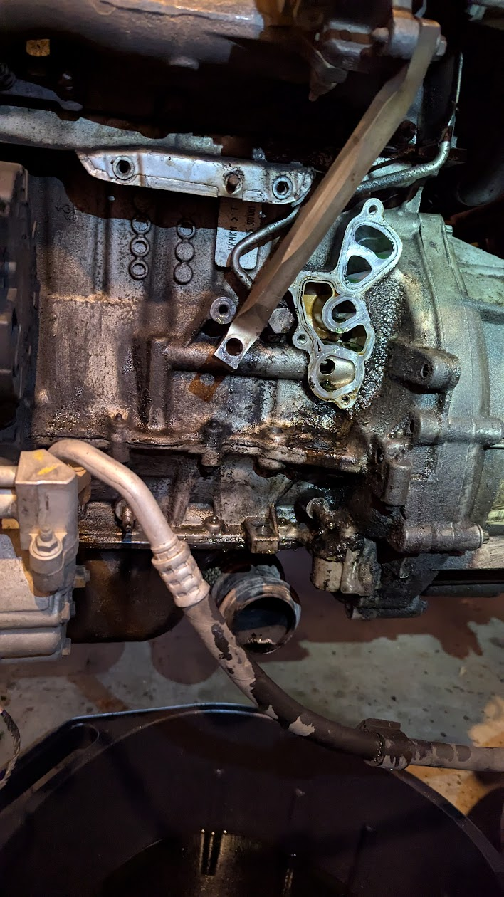

p.s car is back up and running, re-sealing the engine went great considering I've never done anything like this before: no leaks, no drips, no codes, no missing bolts.
It was quite the crime scene down there...
