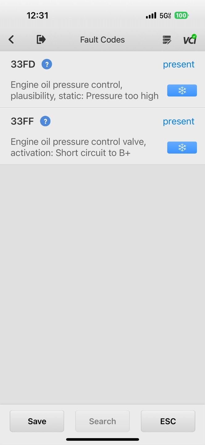

I just picked up 2011 mini cooper s automatic transmission with 77.5k miles. The previous owner was 70 yrs old grandma and she always had a service at mini dealership and I received all the records as well. When I start up in the morning and I noticed that there was knocking noise and kinda grinding noise from passenger's side. the noise slowly disappears when it gets warmed up and while I driving, It runs fine and no noises but randomly I can hear the same noise when I stuck in the traffic light. I just scanned the car with autel ap200 bluetooth scanner and found those error codes. what do you guys recommend me to do? and I'm confused with meanings of "not present". does it mean it's erased?

Hmmm - a lot of signals. Could be multiple things. Do a quick search of the code numbers on this sight - you will see a range of things from replacing your fuel cap to oil control solenoid TSB ...
This might take a few attempts to address
Good luck !

I erased all codes and drove around 10 miles and rescanned the code. now I have 2 codes : 33FD & 33FF. I'm going to start with the exhaust vanos solenoid.

Now I have these 2 codes left. I erased few times but it's still there. I'm not really what I should start to replace first. I just ordered vanos solenoid (brand name URO) from autozone and plan to replace exhaust one and hopefully this fixes the problem. Car doesn't start making any noise today even cold start (that's so weird).. car runs fine but shakes at idle though. what do you guys think?

I'd check / change the oil again. Make sure it is at max ( do a warm check ). Hoping that is all it is ..

I wouldn't put it past Jiffy Lube to not change the oil filter, based on where it is, but it is possible they messed something else up.
The early N18 engines has issue with the oil control solenoid harness, too. There is a service bulletin for where the harness goes through the block. The harness can wick oil and cause issues with the DME.

just finished oil change with mobile 1 0w-40 european formula & mann oil filter but still have same issues..

Update: solved problem with replacing oil pump solenoid however, car still shakes when car is warmed and can hear irregular knocking noise from passenger side. Could it be exhaust solenoid?
