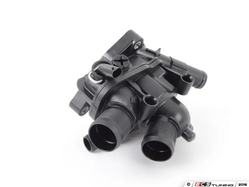

Should be right next to that sensor, but looks like it might be under the fuel pump.
https://assets.ecstuning.com/product...8832_x800.webp
One of the best investments I made was a vacuum coolant fill tool.

That is exactly what the one on the JCW engine looks like. I used everything but a mirror to try and see it. I don't think it is there. Might have to invest in a vacuum tool.
