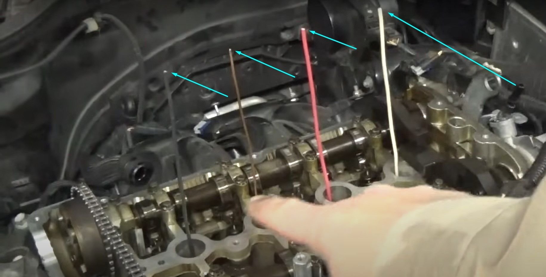

Assuming that you have a locking camshaft locking tool, did you make sure both the intake and exhaust camshaft writings are facing straight up? The markings on the camshafts needs to be pointing straight up and all of the pistons needs to be midway by using 4 equal length coat hanger wires in order to lock the flywheel. Here are some photos below to show you what I mean.....Remember, timing is "IMPERATIVE" and so critical
Writings on the camshaft
4 equal length to set the pistons for chain installation

Originally Posted by Vanski
@Our2008R56 ,
You can save yourself the trouble of the 4 wires by simply installing the crankshaft locking pin from the timing set kit. It's more accurate too.
