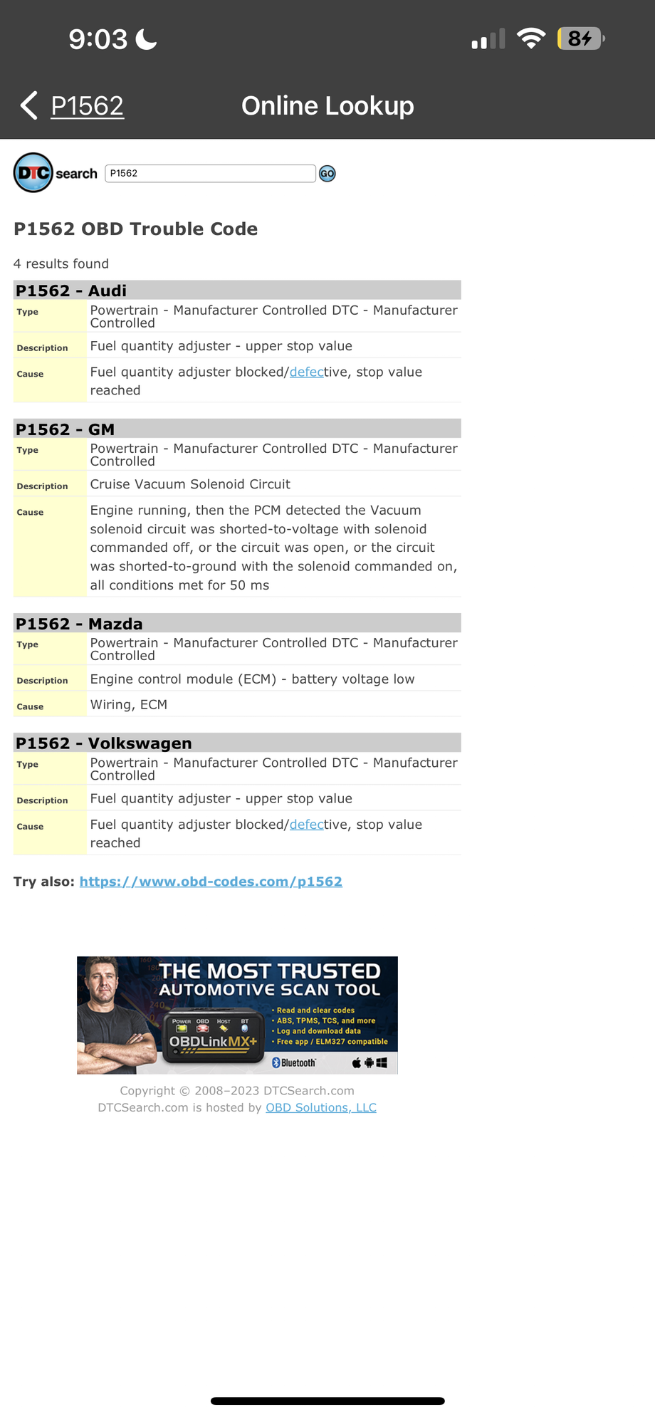

08 r56 S Manual. I just got code p1562 and cant figure out what it means? When i look it up it all says manufacturer specific but i cant find answers for mini cooper. Car seems fine tho no issues that i can tell can anyone help?

If you have no ther codes, could be a leak in the intake manifold. I would triple check the PCV tube that goes from the back of the cam cover to the manifold. Those are know to crack and leak.

Does your OBDII scan tool read OEM enhanced? The OEM enhance will give you a sub code using without the "P" such as "1E0101"
