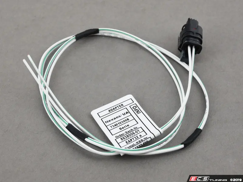

https://www.ecstuning.com/News/MINI_...el_Pump_22527/
On the later style that wire is used and make sure its hooked up correctly, also make sure its connected correctly and getting power.
https://www.ecstuning.com/b-genuine-...r/12518638006/
DIY and PDF
