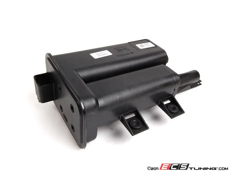

Diagram and how it comes apart.
https://www.realoem.com/bmw/enUS/sho...84#16132757327
This is the charcoal filter
https://www.ecstuning.com/Search/Sit...h/16132757327/
