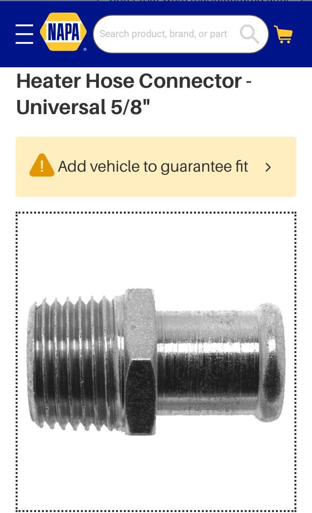

If I remember correctly mine was a 350psi hose. I think I got around 6ft for $30. Works like a champ
And I had to use these connectors to make it all work. It was a very tight fit with the stiffer psi hose, but it works and has been on my car for almost a year with no issues
