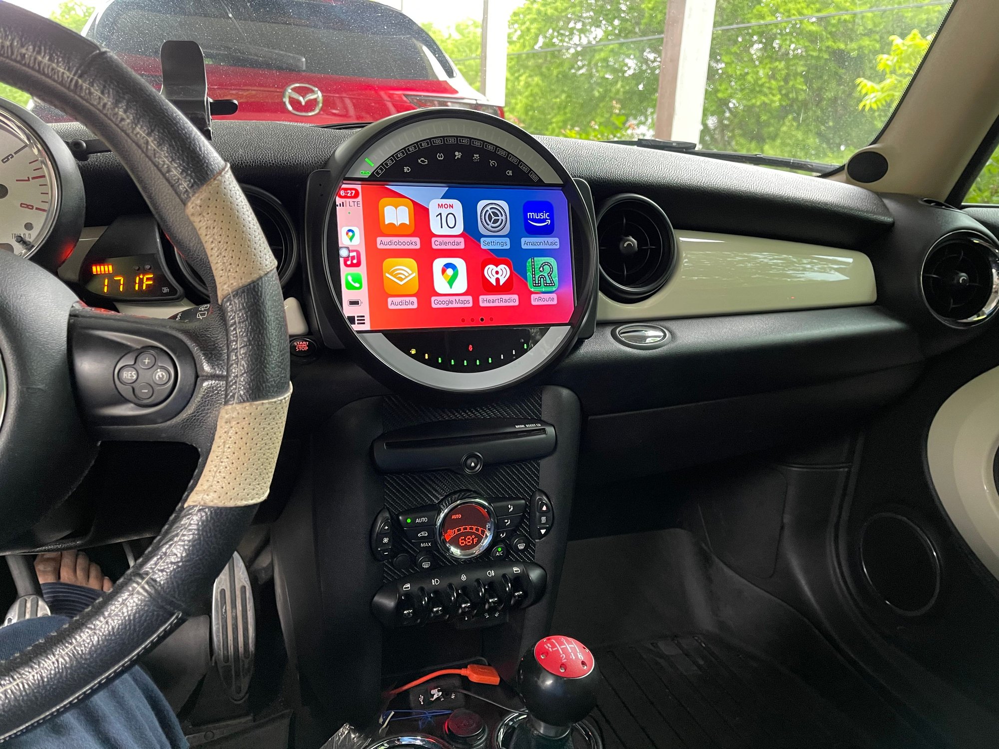

Installed this Android 10 head unit purchased from AliExpress yesterday. Not the best build quality, (cheap feeling plastic) but has a ton of cool features including wireless CarPlay nice screen resolution.

Installation wasn’t that bad but do know how to take the center stack apart before tackling the job. Overall quality is OK but plastics feel cheap on the surround and on the surface decals. Mostly it’s a “plug-n-play” install but I did run into a minor fitment issue with a stock plug for the tach lighting. You will lose the CD player function and some of the backlit icons are tiny and hard to see in daylight, esp the fuel gauge. Chimes are from a supplied speaker but sound weak and timing is slightly off. Now the good are the very clear and vivid 9” screen, wireless CarPlay, integration with steering wheel controls and overall customization capability. AliExpress has several venders selling this unit anywhere from roughly $360 to over $500 depending on memory size.
