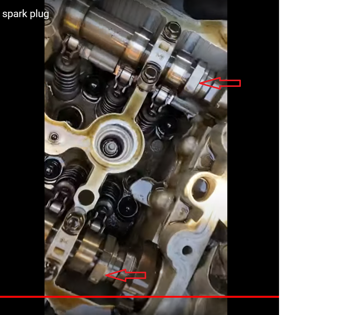

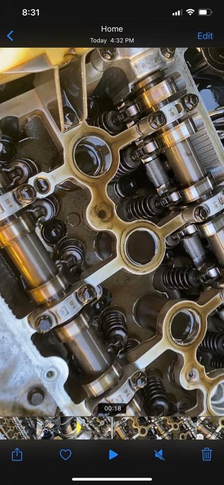

Hey there i have a 2010 mini cooper s was drving home today and the car lost power and coolant leaking and then there is oil everywhere on the valve cover gasket and a code p0012 and p0001 and then random muilt cylinder misfire when i open the coil pack there is ton of oil in cylinder 1 -2 -3 and number 4 is dry the car turn on but feel like dying and smoke coming out the front hood here is the link to the video

Looks to me like your valve cover is missing...

Is the gasket for the spark plug holes even on the valve cover?

yes and the valve cover from the inside is a little brittle

i take it off to inspect

Pretty sure your camshaft timing is out.
That doesn't explain your oil and coolant issues. I think you've got some major problems going on there.
If it were my car, I think I'd be pulling the head and inspecting for damage. You *could* re-time the engine then check compression, but I believe you said your coolant is disappearing as well. Not good.

I'd say valve stem seals is what's needed and new head gasket.
