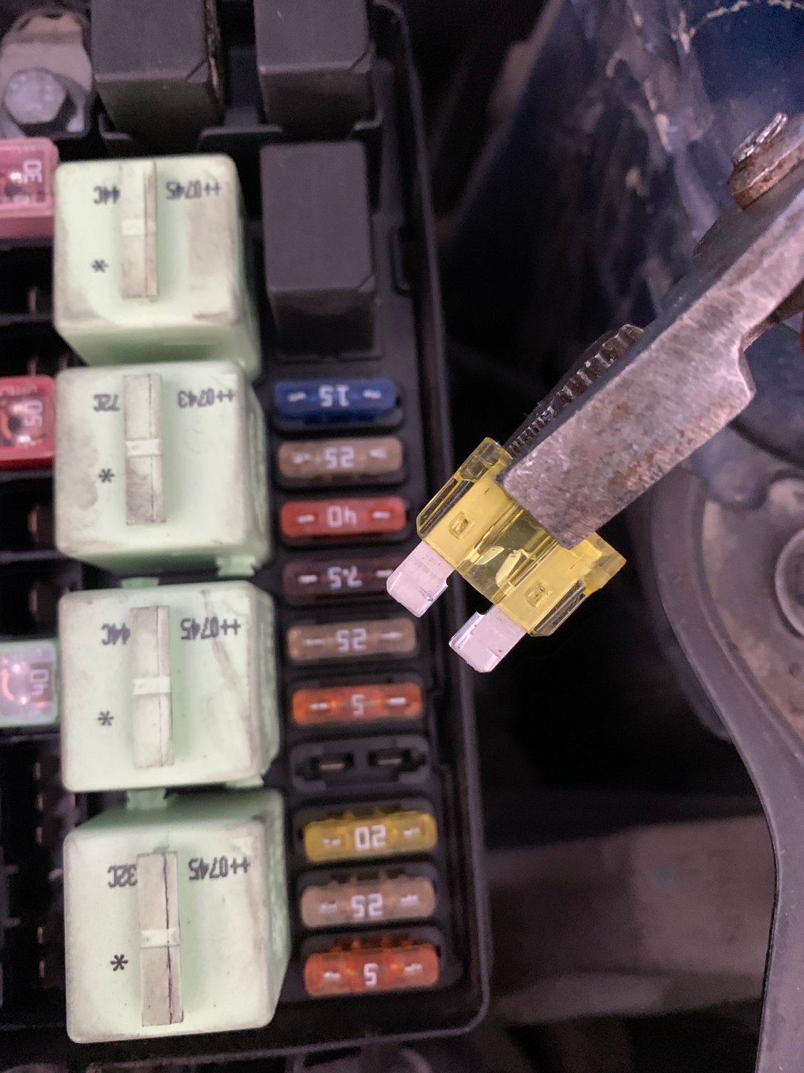

When codes were erased with scan tool, they would return immediately/instantaneously(!), suggesting an electronic failure, in my opinion, rather than a slowly evolving fault signaled during feedback loops while driving.
I noticed the insulation for two wires attached to the Air Mass sensor was split, exposing the bare wire that I covered with shrink wrap (see image).
The shrink wrap at mid-wire was where I cut the wire so I could install the wrap to cover the exposed wire at the base of the connector (circled).
You can see the impression of the split insulation under the shrink rap captured within the circle. The mid-cut wire was soldered and covered with wrap.
Next, I checked all of the ECM fuses in the fuse block under the hood on left hand (driver's) side (USA).
Fuse (F04, 20A, circled) was blown.
Considering the years of heat/cool cycles experienced by the engine and how the wire insulation suffers from these heating gradients, my next task is to check the integrity of the wire bundle underneath the wire loom.
The wires under the loom were stressed when installing thermostat, oil pressure sender gauge, vacuum pump seal, or similar and worth it for me to check. I am expecting another short circuit to happen again.
BEAUTIFUL MAN! Thank you so much!!!
I owe you lunch and a beer.
Replaced the wiring harness after finding a short, and that fuse, and voila! BOOST!
