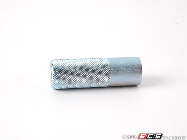

Yes they can be a paint with the little prong. Their is a little tool.
https://www.northamericanmotoring.co...r-caliper.html
