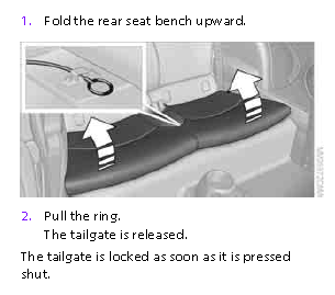

older models had a release under the back seat. Sometimes.
https://www.northamericanmotoring.co...battery-430901

owner's manual for 2007 R56
curiously the 2009 manual does not have this paragraph .....
but the manual for the coupe, roadster and convert' shows the location of the 'pull' for all of those models so I SUSPECT you will find this on any GEN2
F57 has it too ......
<very early GEN1 cars like my 2002 S lacked this ... it was rectified later but NOT retrofitted to cars built without>
