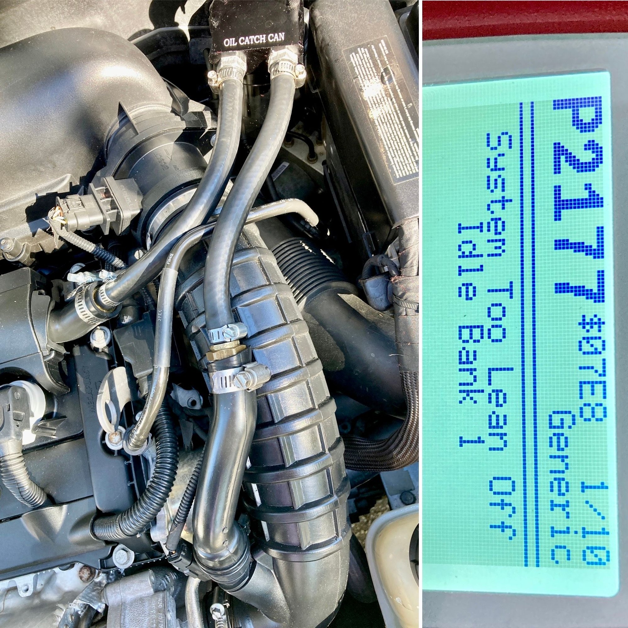

Plugs, coils, pressure and smoke test good. I went to town on the catch can today, improved connections, trimmed down a hose and swapped out a brittle hose. Raised the CC an inch. Codes all cylinder misfire related, and this dandy of a code in pic. Test drive was really good! Axe Murderer status. Boost was good as well. I’ll take a legit drive and see if any codes clear out. Thanks for all the suggestions. I’ve never used Fram either. 💩I need to buy a six pack of the OEM filters from FCP Euro, or wherever. I wish I could find K&N for the Mini around here.

Brittle vacuum hose BAD. Some common causes of code P2177 could include...
  • Damaged, burnt, shorted, disconnected, or corroded wiring and/or connectors in the upstream oxygen sensor’s wiring
  • Vacuum system leaks that cause unmetered air to enter the engine
  • Defective upstream oxygen sensor
  • Insufficient fuel pressure, but note that this will almost certainly be indicated by an additional code along with P2177
  • Dirty, or contaminated MAF sensor element
  • Use the aftermarket MAF sensors, especially on high-end European applications
  • Failed or failing PCM, but note that since this is a rare event, the fault must be sought elsewhere before any control module is replaced

Vacuum lines are very new, both 02’s are brand new, not sure about fuel pressure but the sensor below the MAF (small side clip) has a tape job (in pic) and maybe I should unwrap the mystery there.

oh also, could be a dirty fuel injector, so run some TECHRON or whatever to clean out that cylinder 1 injector.

Running this through the tank. The car takes a while to idle smoothly at start. Choppy haunting starts continue. Eventually the car drives really well with boost. I made the lucky mistake of leaving the car running in the driveway for over 30 minutes. When I eventually took off it was running strong! I’m talking to my mechanic tomorrow. I’ll mention your suggestions. Thanks for hanging with me on this.

You might have a weak low pressure fuel pump. I changed mine at around 160k miles as preventive maintenance.
My high-pressure fuel pump died precipitously at about $130k miles. Both those would cause a lean condition if not working properly but I don't know if Mini would throw a code for low fuel pressure.
How many miles on your car?

Sorry misspoke here. The error code is for bank 1 (upstream O2 sensor) not injector 1...

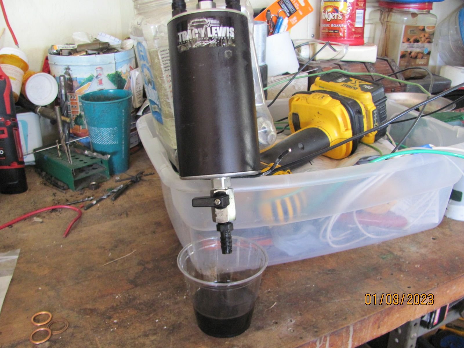

Tracy Lewis Catch Can
For those who don't believe, this i what came out my ( N14 JCW) single catch can after 3000 miles. i am in Florida, so their is no condensation, this is oil.
Picture of my set up, post# 67

Yours and every other car ever made. That's pretty standard. These French engine spit out a lot of oil for sure. My old turbo Japanese car does as well.
Everybody with direct injection needs a catchcan.
