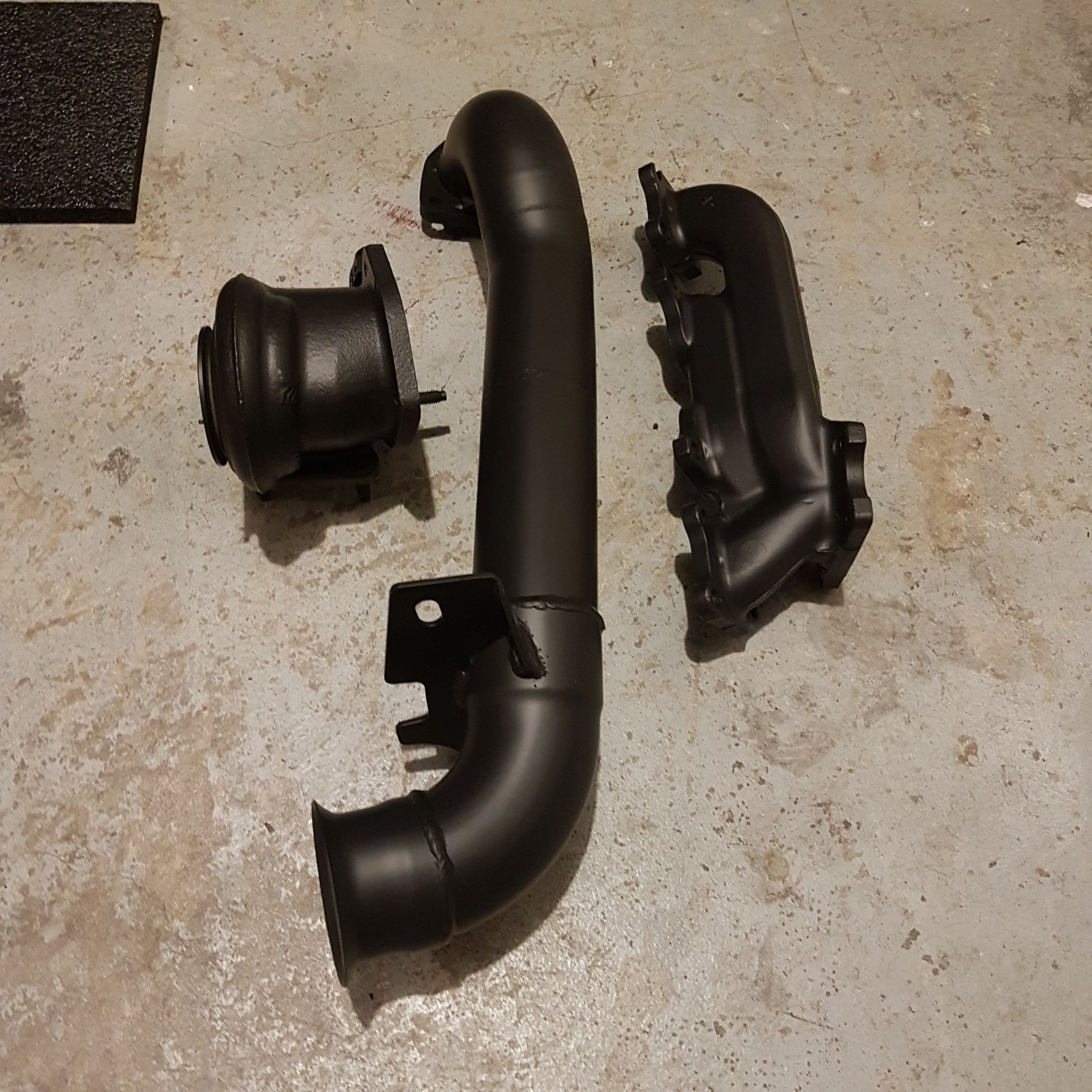

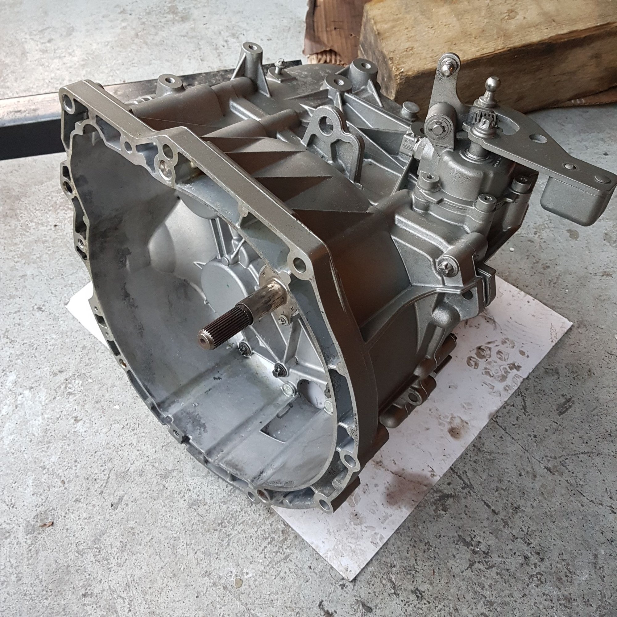

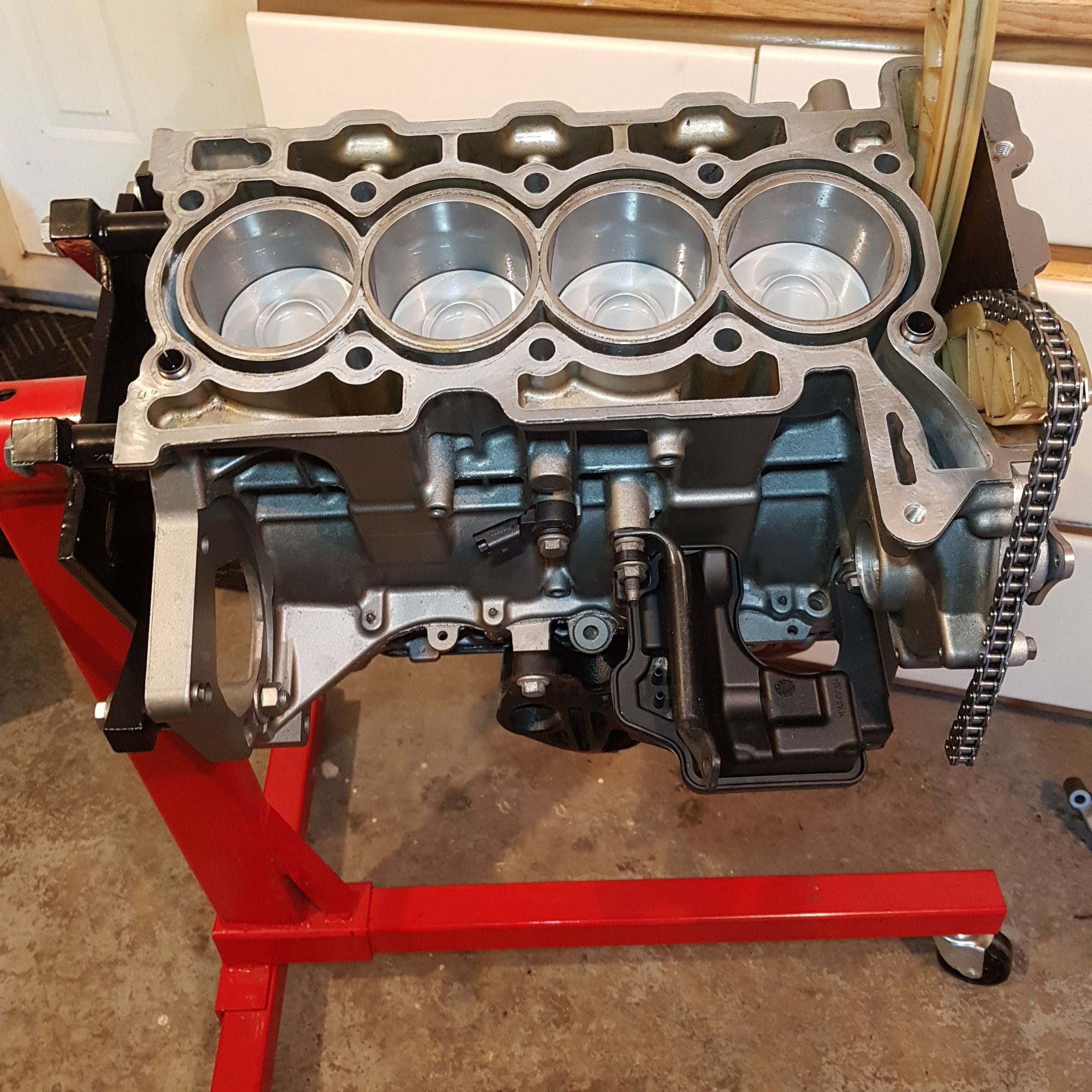

Progress Yeah!! short block together, JCW pistons, ceramic coated piston tops, re-coated side skirts, ceramic coated jcw exhaust manifold, turbo housing and down pipe. stuck waiting for cylinder head, guides stuck on us side of border due to covid 19. Wavetrak LSD installed, cleaned and painted transmission. removed lower control arms and front sway bar to install new H&R front bar, found out they shipped me the wrong one, doh. Somehow ended up with an E30 M3 front bar, R56 cooper s rear bar. Dont ask me how that happened, ordered a kit front and rear together. pressed off the rear control arm out of the bushings, going to press the old bushings out tomorrow at work and install my new power flex bushings. Cleaned up the engine bay, got new 215/45/17 Conti's mounted up on my OZ Superturismo's, ordered a set of Mishimoto hoses, thought i might as well replace them while im in there. Turning out to be more hassle than i thought it was going to be, but its getting there should be ready by mid next month, provided I can get the cylinder head back.

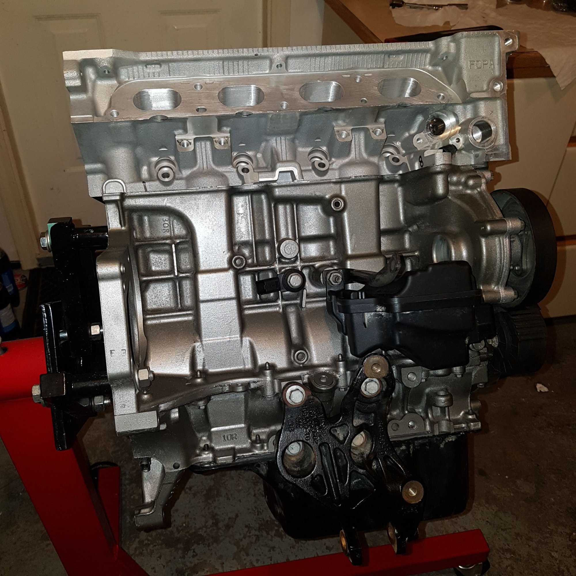

Got my cylinder head back today from Hayward Performance tonight, he replaced the valve guides, performance valve grind, Supertec valve springs and seals, he also massaged the ports. Lance does very nice work, first mini N14 head he's done he said they are very hard to work on because the ports are so small. I also cleaned and assembled the oil cooler assy and installed the exhaust housing on the turbo charger. Question do you think I should paint the head same color as the block or leave it raw aluminum, the problem with the raw aluminum is it gets grungy and its hard to clean.
