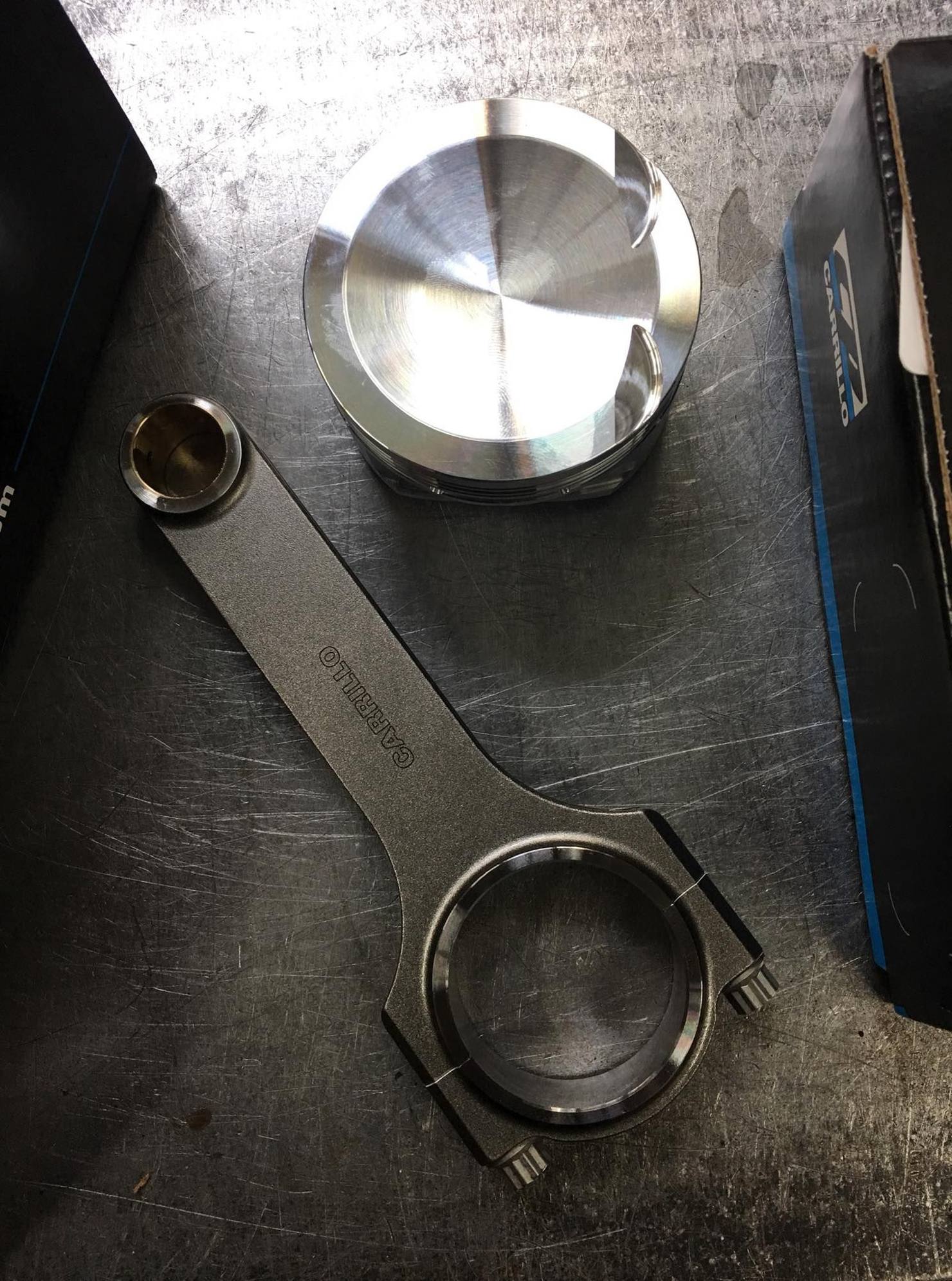

CP pistons and rods - lower compression + bigger turbo

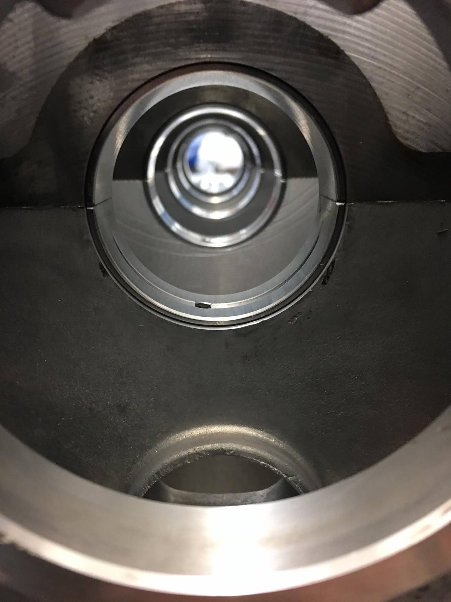

I guess this is what the bearings look like

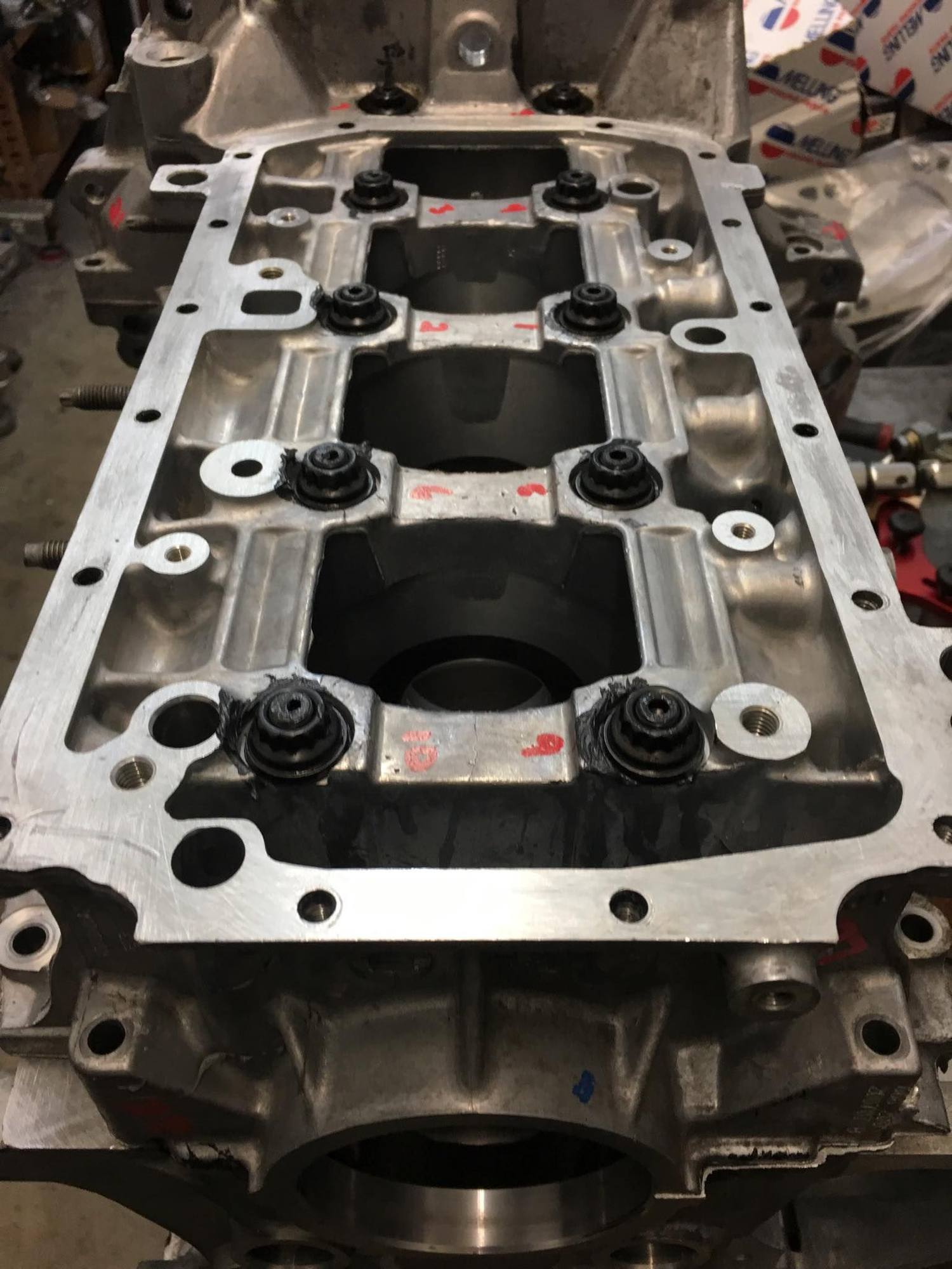

the bottom end with ARP bolts - It's a beautiful thing. Hope is doesn't fall apart.

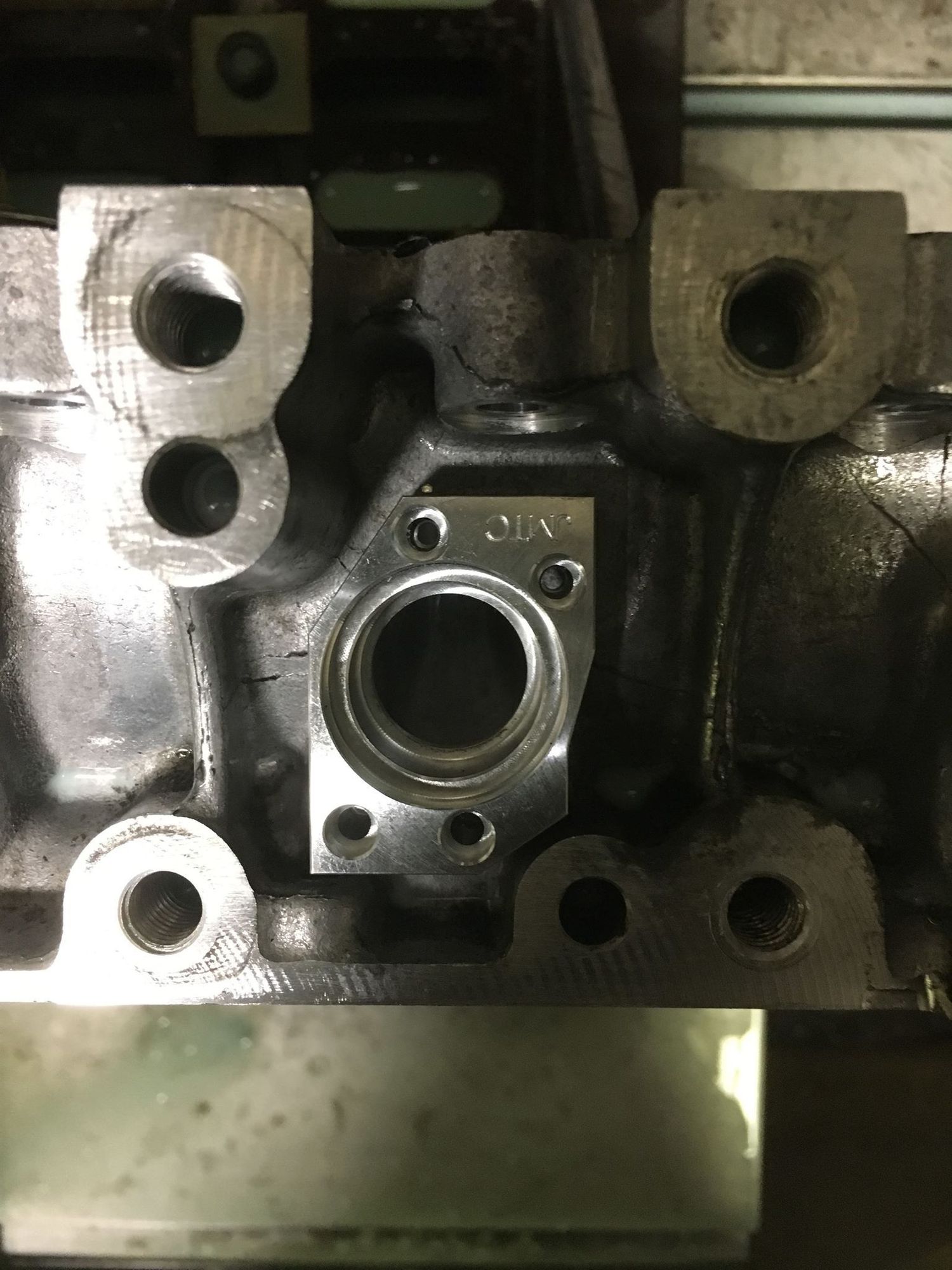

Arric at JMTC milled in the fitting for the N18 wire connection.
A close up of Arric's work.
N18 pump installed
N18 pump installed with the fittings. Hope it doesn't leak. Holy hell. I hope I can wire this up to work properly. We need oil pressure.
