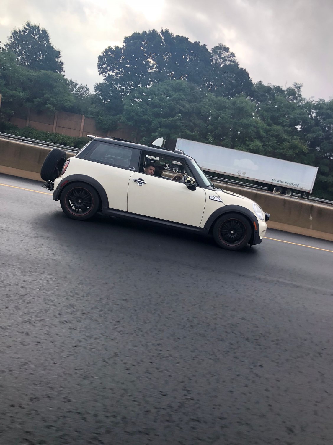

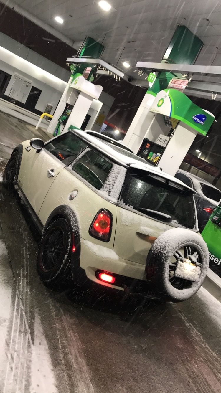

Can't comment about your problems, but do love the spare tire. Hadn't seen that done before..
