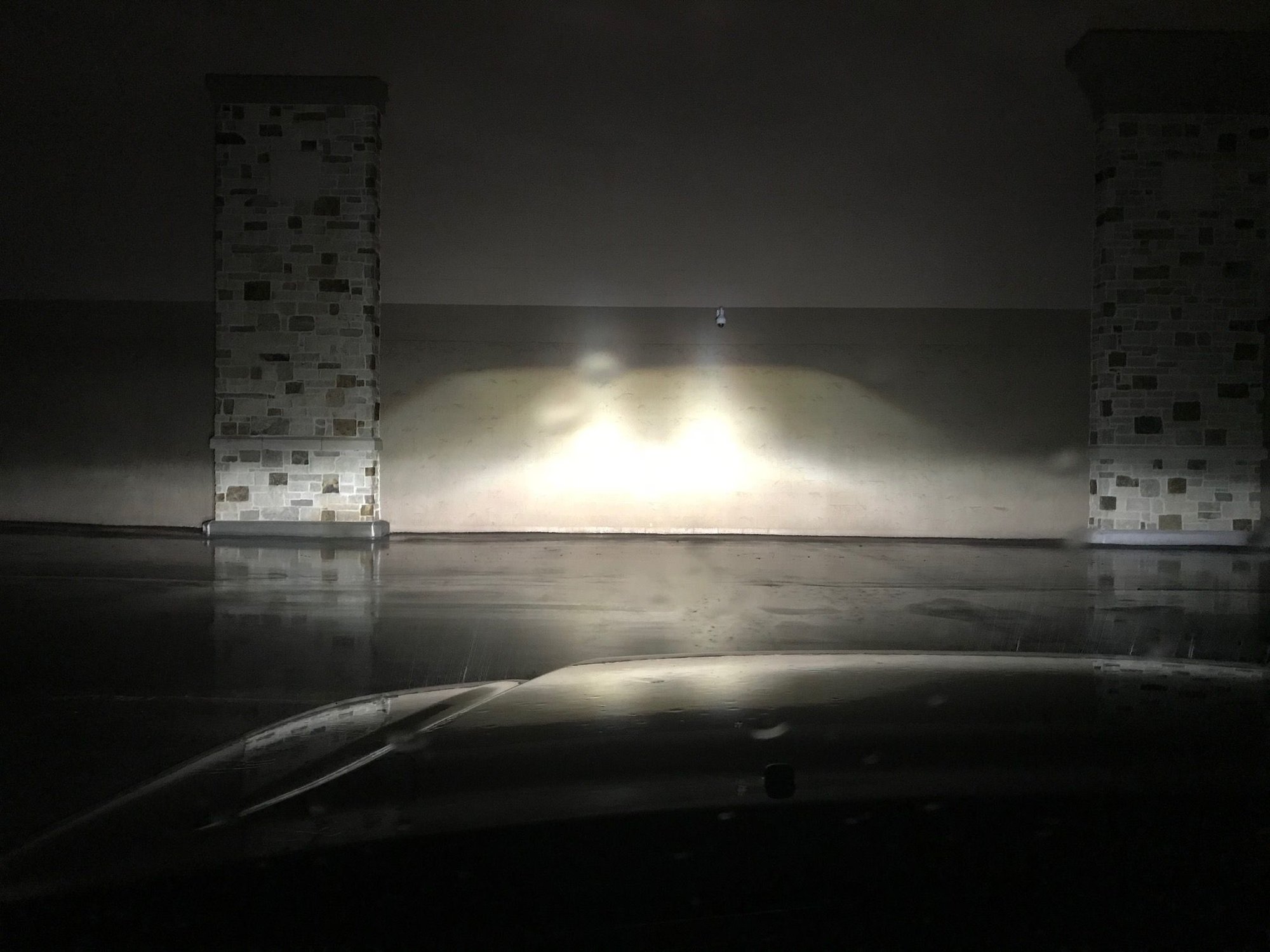

Yes, I understand the work involved with retrofitting lights. I have done many sets. These are the lights i just got done doing on a friends Tacoma. Morimoto mini D2S 4.0 with Denso ballasts and Philips Xtreme 4300K bulbs.. Pic was taken about 50 feet away.

Looks exactly like the beam from mine!
I used the same, Morimoto D2S 4.0 Bi-Xenon.
Except I kept the mini ballast, the 4 wire plug is 2 for power and 2 for the shutter, and D2S 5300 bulbs.

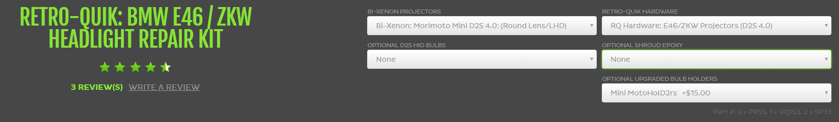

techman1, was it this kit?

Yep, and the optional igniter, D1S >D2S .
And the D2S bulbs, all in one go.
