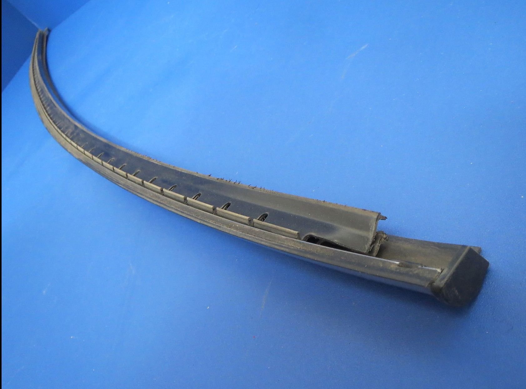

Here is a view of the underside of the trim. Hope this helps.

So the tip of the arrow goes around the rear glass?
The entire piece has to slide on?
