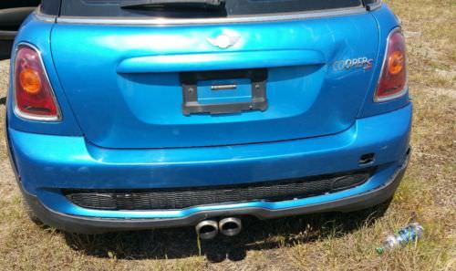

Hello. Husband here. I think the nomenclature of parts is aiding in a sea of confusion that I'm in.
I had this style bumper:
...as previously mentioned, it is no longer with us.
I got this style bumper off Ebay not knowing that it was a tad different (my fault)
so the problem is upon having made the switch I found myself without "reverse" lights
The leads coming from the car to the new lights to fit the new bumper don't mate. Although the connector suggested will mate with the new lights - the mini has 3 wires coming from it & this suggested connector (which I went ahead and got) only accommodates 2 wires and there is no metal in them. ? I think I'm screwed as there is no way to even wire these new connectors up. :shrug:
