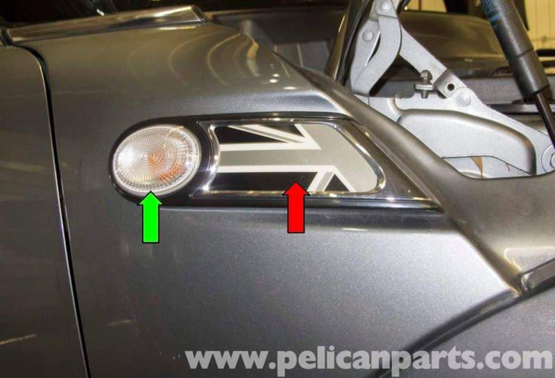

The fender light? Pop the fasteners for the wheel well liner, peel it back, and you'll see a couple jam nuts holding it on. Remove the nuts, and the light housing will pop out of the fender trim. Installation is the reverse process.
If you are talking about the "fog" light housing, if you can't get it out by removing the wheel well liner, you'll have to remove the bumper to get at it.

Are you talking about this one below? If so, our tech article should help you here: http://www.pelicanparts.com/techarti...eplacement.htm
If you're talking about the one in the fender (image below), we have the article here: http://www.pelicanparts.com/techarti...eplacement.htm
