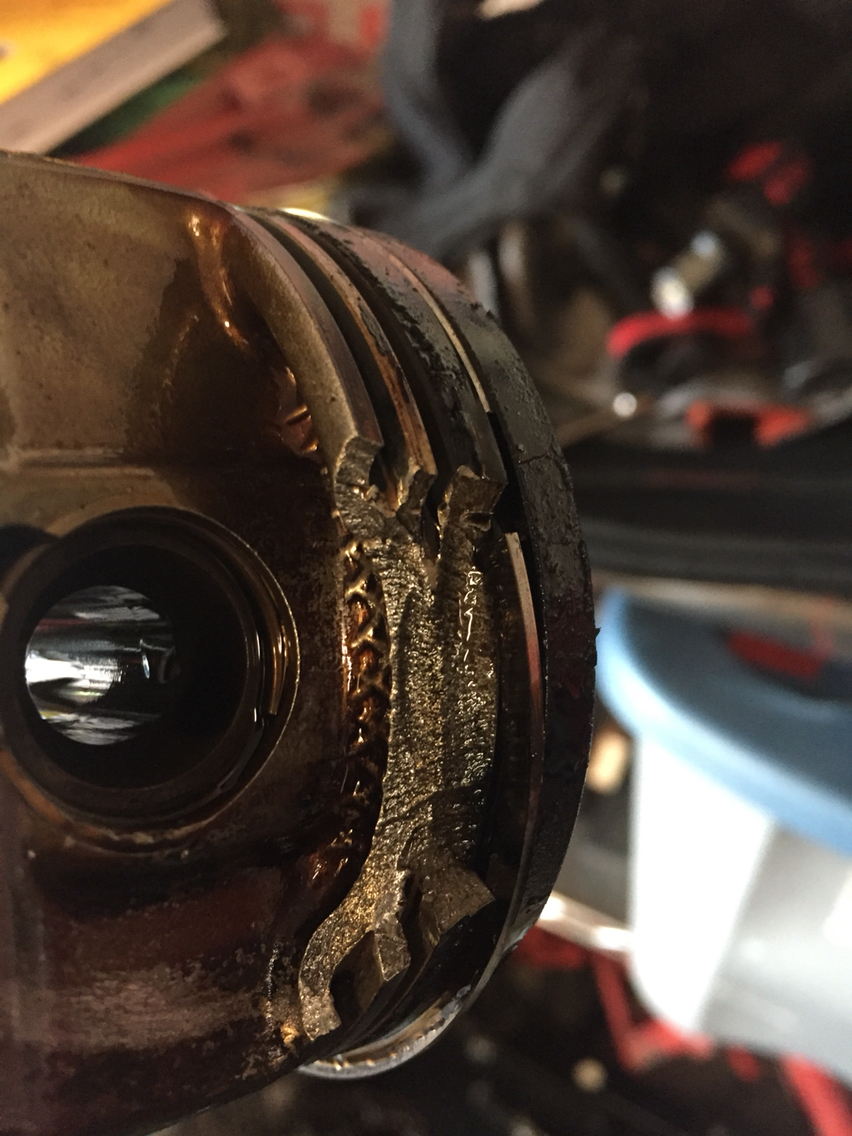

I also have the same set up and run 20 psi. I just finished a complete engine rebuild due to a failed piston. The rings in the stock MCS engine are low tension and subject to blow by. The stock PCV system pushes oil directly into the combustion chamber and causes build up and also knocking. So begin with a compression test and leak down to check the health of your engine. Follow that up with a walnut blast cleaning of the intake valves. Remove and clean your entire intake system including all hoses and intercooler. While the intake is our clean it and the throttle body. If you want to invest in your engine rebuild it with a quality piston such as CP and have the head rebuilt by a machine shop. If you do the rebuild yourself you can keep costs down. Best of luck.
Attached Thumbnails Blue smoke from tail pipe-photo406.jpg   Blue smoke from tail pipe-photo608.jpg
I got 2 oil catch can to address the PCV system issues. I'm going to do a compression test asap, then do the carbon cleaning.
if the compression test is bad, I will have to take of the head.
Attached Thumbnails Blue smoke from tail pipe-20170118_102654.jpg   Blue smoke from tail pipe-20170118_102659.jpg
