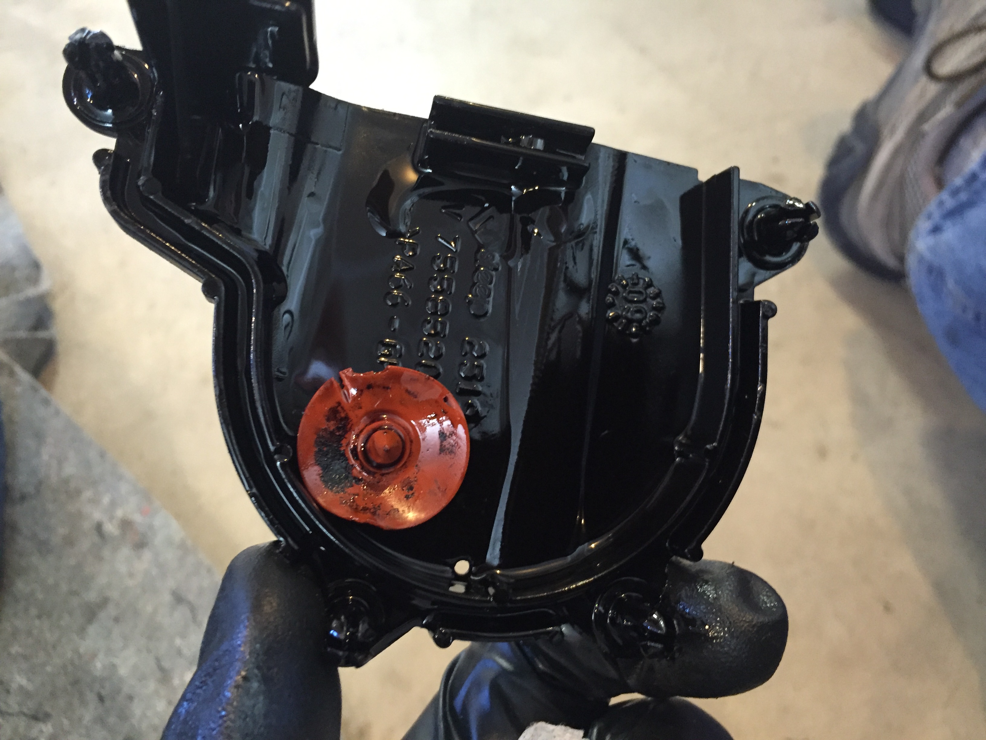

Check with the companies that support this forum and you can find one under $400. This is what failed on my valve cover. I had to drop the oil pan to find it stuck to the inside of the oil pump sprocket cover.
Attached Thumbnails P2414 Code with some oddball stuff.. Really!-img_1955.jpg   P2414 Code with some oddball stuff.. Really!-missing.jpg   P2414 Code with some oddball stuff.. Really!-img_1957.jpg

After I changed both O2 sensors I was still getting the P2414 code, so I decided to do some more troubleshooting. I removed the hose from the valve cover and decided to spray inside knowing that carbon buildup sometimes causes issues. Once I did that the light went away and hasn't returned. I may remove the valve cover just to inspect the PCV valve and make sure it isn't actually defective. Thanks for the info.
I can't believe BMW would build something this way, but then again, it's BMW, and they like their money. Too bad we can't just buy the replacement PCV valve like 99% of every other vehicle made in the world.
