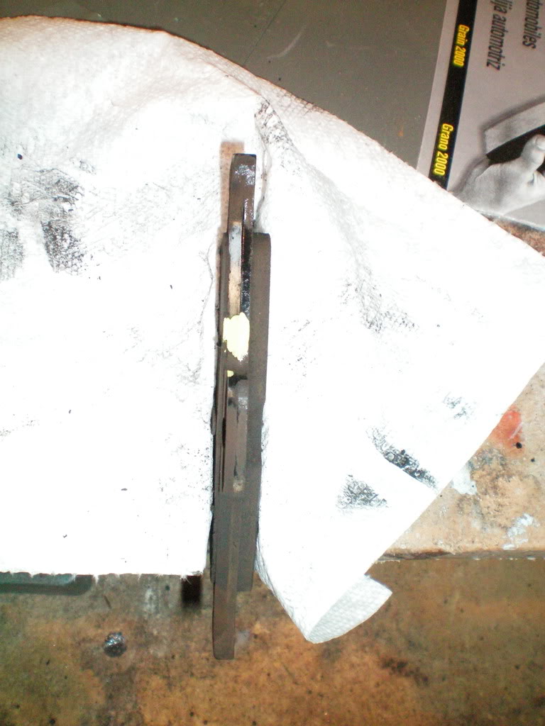

visual pad check
you can do this without removing the wheel in most cases, altho removing the wheel allows you to check the inner pad as well as the outer.
Look at the pad face (thru the wheel) if the pad material is thinner than the backing plate, you should be thinking about new pads. Here's an almost new MINI pad with some white on the backing plate to highlight it. You see the pad is MUCH thicker ....

here's a worn pad
note also that on the new pad you can still see the 'bevel' .... not ALL pads for MINI have the bevel, but the OE and EBC pads do ...
