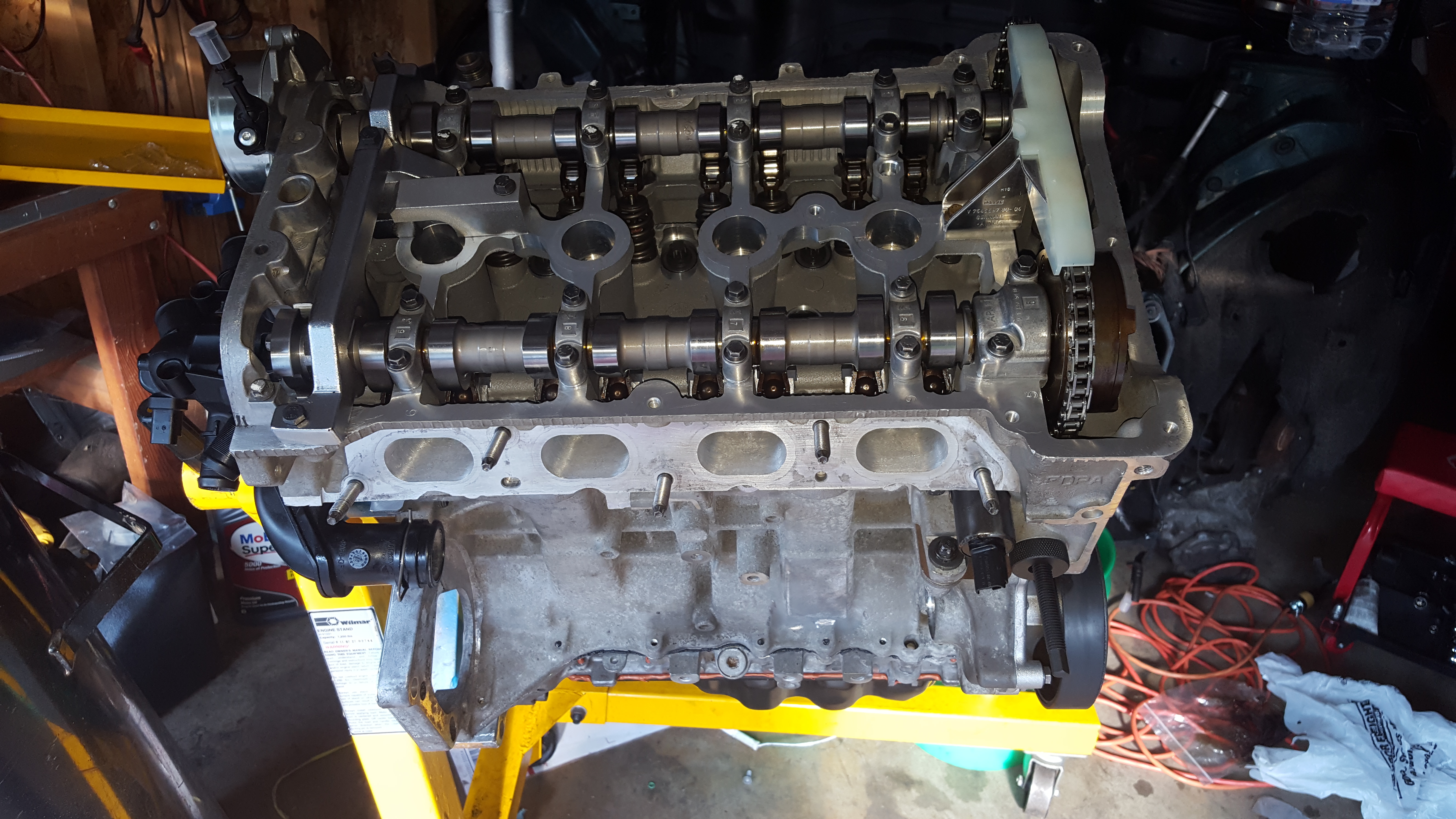

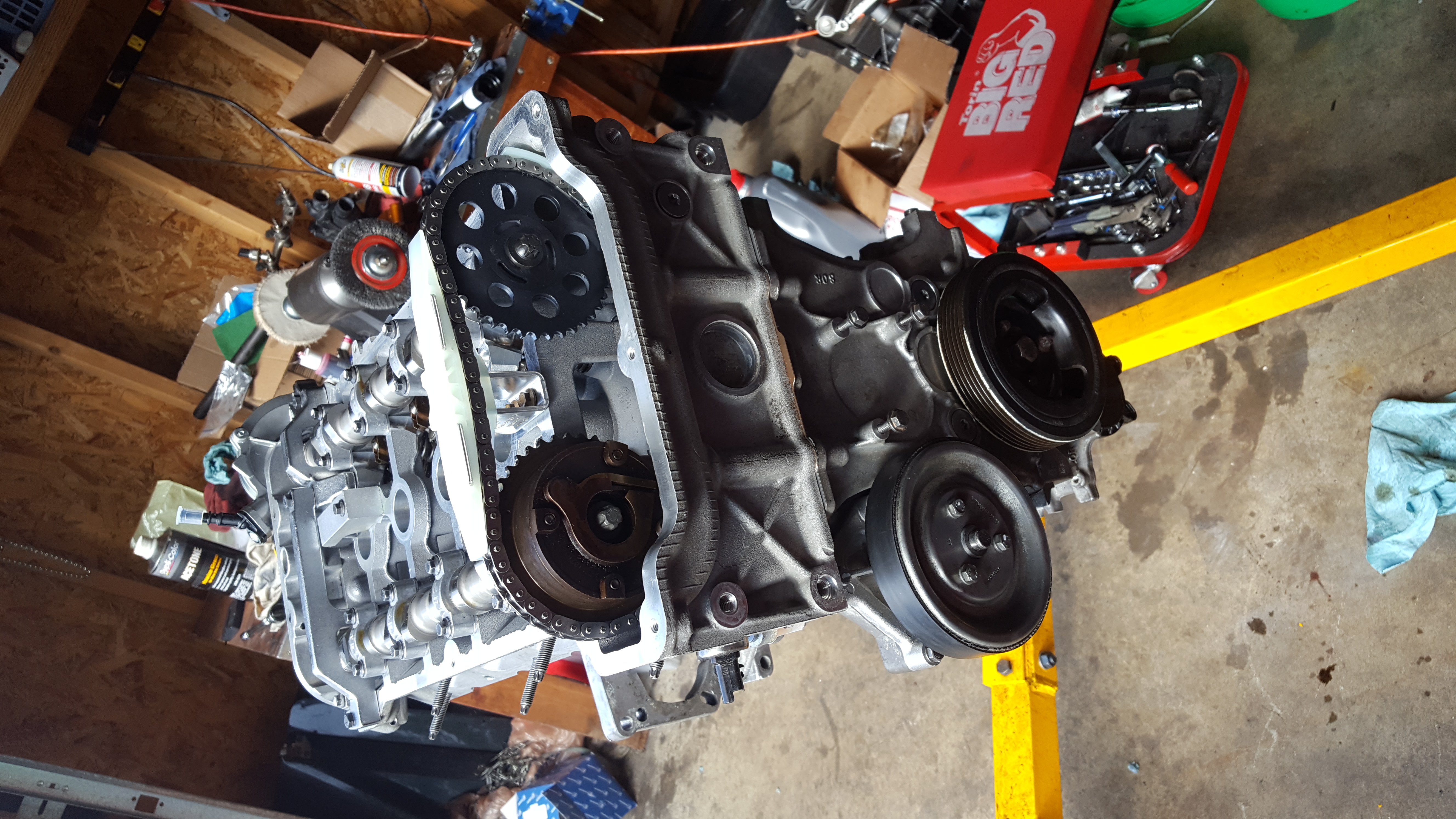

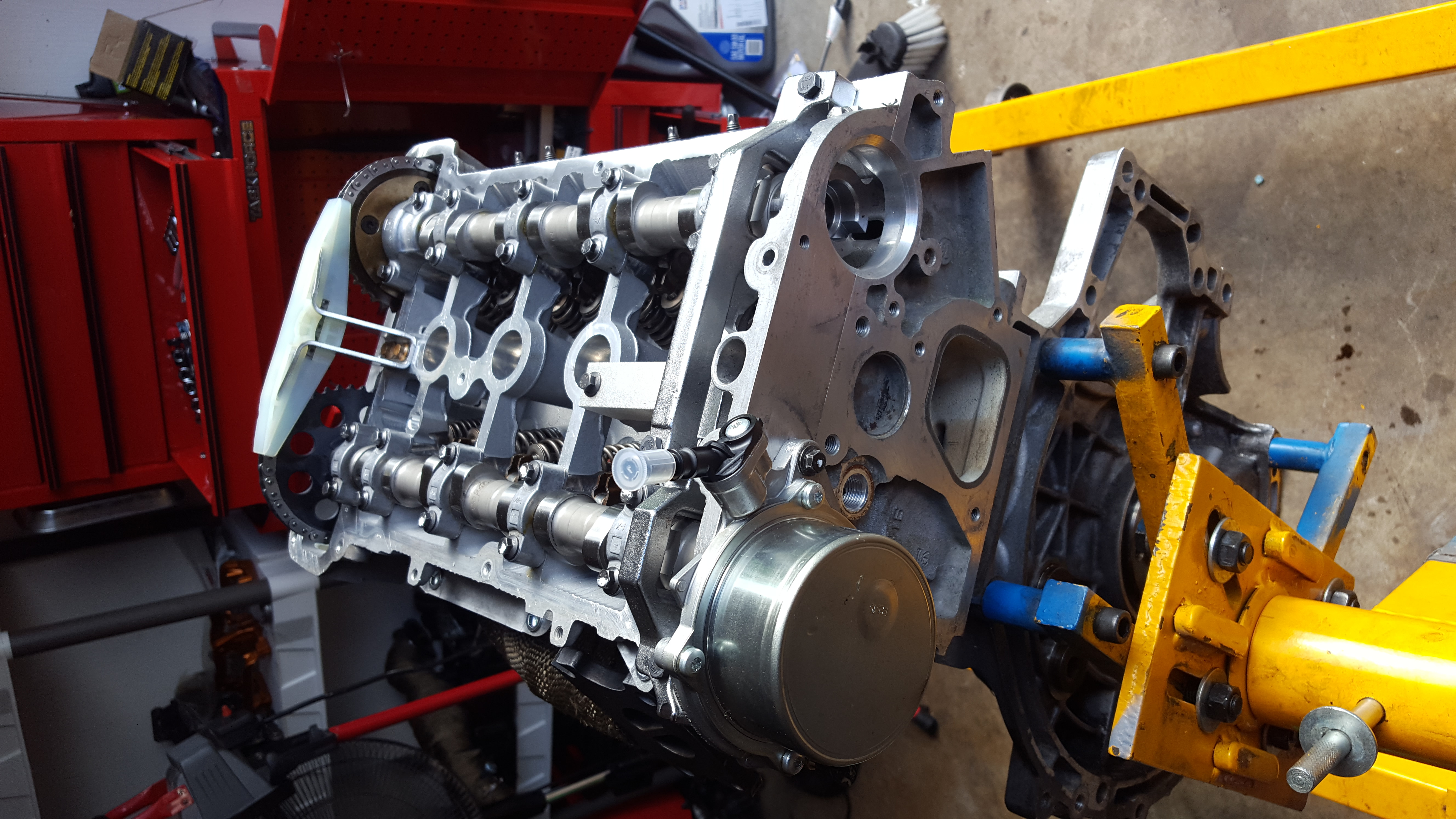

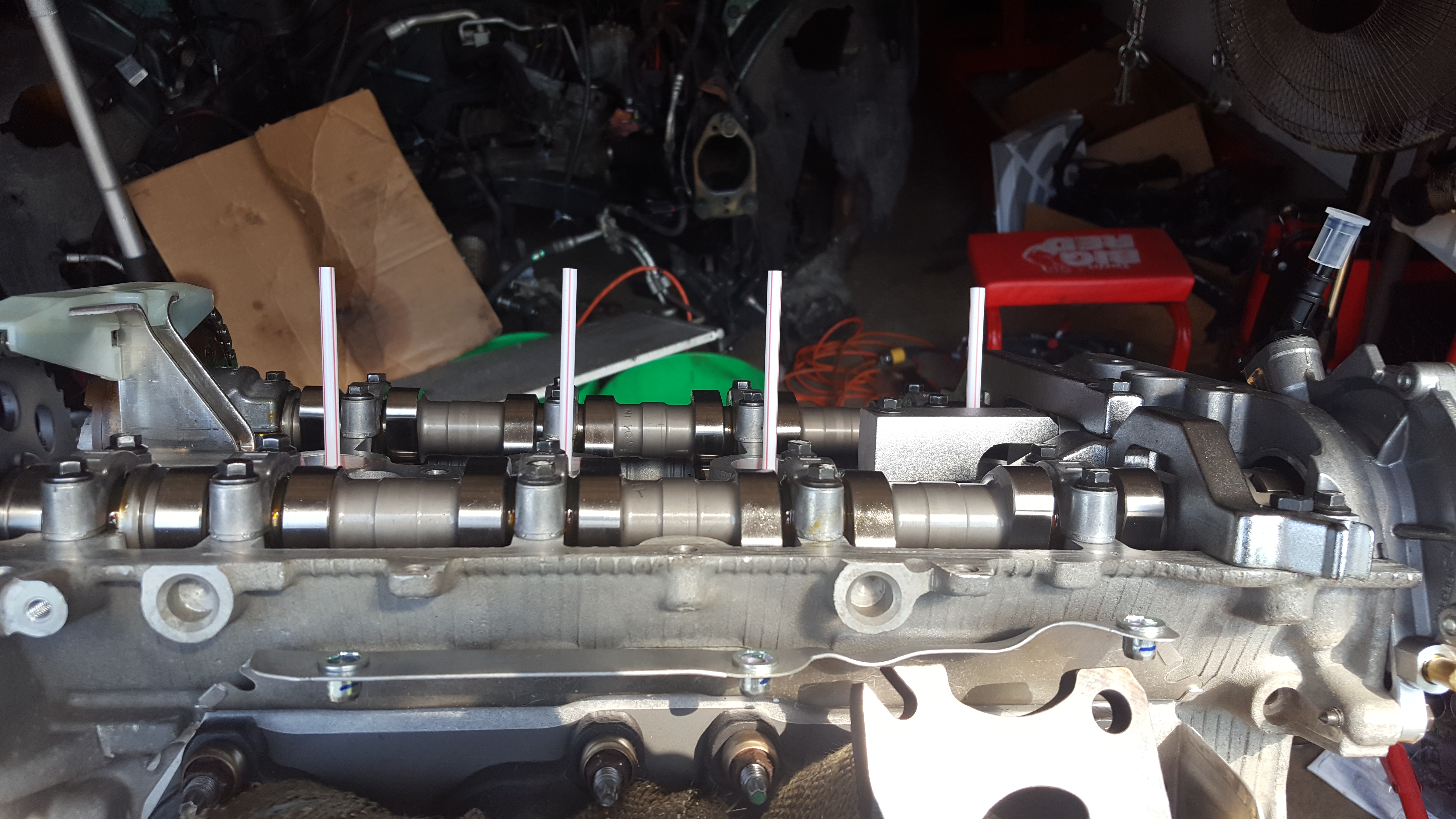

Just to recap. I will test the following and see where I get. I know the lower end worked fine prior to head install so I feel that part is solid. I could turn the cams with the wrench enough to get the timing tool on so I really don't think they are an issue but might be after the timing chain was installed. I mean I got all that together fine. Once the timing tensioner was installed the chain was tight. I remember installing the clutch and was unsure if it should be as tight to the flywheel as it was but my buddy said yes. First time doing a clutch. Actually the 1st time doing most of this crap but I paid attention and asked when I was unsure or curious. So based on my personal experience with this build I would say the areas I noticed anything that seemed odd to me were the timing and the clutch. However the alignment of the timing components I was dead on. I know the flywheel and cams lined up correctly and have little question as to this being an issue. Could the timing chain be too tight or something there? Then is the clutch possibly an issue? Both of these are not really what I want to dig into and check but I will if I need to. Just kinda a bummer thinking about that. Since it did fire up originally and seemed to be easier with the original starter I will look into this 1st and go thru the checklist below. If you feel my order is fine or off let me know please.
1. Remove starter. I will actually replace it since they have a replacement for me. --> Try and manually crank the engine.
2. Remove the drive belt. --> Try and manually crank the engine.
3. Pull the valve cover and look into the timing chain etc. --> Try and manually crank the engine.
4. If the above reveals nothing then I guess I need to pull the transmission off and double check the clutch/transmission connection....
5. If this reveals nothing I guess set it on fire :-)
Here are some pics of the timing and cams during the rebuild. I honestly feel i did it right but I could be wrong. I know when I put the transmission on I lined it up with the engine on the ground, tranny on the hoist and slid them together then used the bolts in a cross pattern to slowly pull the two together and we did not notice any excessive force that would cause concern. I just did a turn or two per bolt at a time. Again if I had to guess its 1. the starter, 2. clutch/transmission area or 3. something with the head/timing but I really went thru this. I only know that once the tensioner timing tool was on it got good and tight. I am just trying to share my personal experience with this post as none of you actually were here when I did this. I figure more detail the better. Again I want to thank everyone here for the assistance. I tend to over-communicate but thats just me...
Attached Thumbnails Rebuilt engine startup issues-20160710_182027.jpg   Rebuilt engine startup issues-20160710_182056.jpg   Rebuilt engine startup issues-20160711_165547.jpg   Rebuilt engine startup issues-20160711_183152.jpg

Dont forget to raise the car and check how the clutch is engaging disengaging before any removing, actually think through any part before it comes off, the clues are sometime easier to find that way,
Its impossible to not get frustrated sometimes so plan on taking a break, powering through stuff at this point may not help. look around for a car club or visit a race track, I visit my machine shop and see what cool things are going together.

Since I retired from the world of manufacturing quality assurance / control, I gotta ask --- did you use plenty of engine assembly lubricant on bearing and other friction surfaces? With all your new parts, they're gonna be pretty dry, unless you did some sort of "priming" to the oil supply lines.
If you get as far as pulling the VC off, ensure there's oil everywhere. After running a few times for several seconds, oil should be circulating.
Then there's the cam bearing caps --- it's not easy, but possible to get them mounted backwards or in the wrong location. This would cause binding and make it hard for cams to rotate. Your pics don't show the numbers clearly, but they should be sequential from 0 to 4 on one side, 5 to 9 on the other. #0 and 5 can only be mounted in one orientation and location, the rest need to be "readable" (not upside down) from the same direction. Watch #6 & 9 to ensure they aren't switched --- the number "pattern" should be the same as the other eight caps.
Yes, this is pretty basic stuff and I don't mean to offend you, but I've found that workmanship can be a significant cause of problems. When I did a similar rebuild a couple years ago, I had a couple "do-overs" and harness connection mistakes. Embarrassing, but part of the learning experience.
Patience, patience ----

Oh I don't get offended for advice. I had a shop assemble the lower and it moved very smooth and easy before I assemble the timing. The head was done by them as well. I only did the head mounting, timing and all items that mount to the engine also. I also added some extra assembly lube to the cams and on the timing components as a precaution. Honestly I do not feel its internal to the engine block unless the timing is too tight somehow. My best guess is the starter, clutch or transmission connection. I truly welcome all advice and questions. I'm no expert but my ocd makes me pay attention to detail.

Pulled the starter and no luck turning the crank manually. Same after engaging the clutch. Pulled the valve cover and all looks fine and oil in the head and oil filter. So that's good news. I assume that I'm correct that the timing chain should be tight like it is? At this point the only things connected are the hpfp and vacuum pump to the cams. I don't see that being an issue. Could be the oil pump is bound up but I don't know the odds of that. How can I verify the clutch is working besides pulling the transmission out because that looks like my next step?

Hi is it turning at all. even with the plugs out a new engine will have a little resistance of pistons and cam springs you should mostly feel the cams (just get another opinion before going further). I havent had an oil pump go like that mostly just dont pressure up. I would remove the fuel and vacuum pumps. The trans should turn mostly free in neutral even engaged, If something is binding the main shaft thats the question. One last thing to be sure of,,,, the vanos is oil pressure run off the variable pump at a decent pressure there is a release valve on the pump (two stages if you noticed) so its just a check but not hard, you can remove the vanos solenoid to check. after that its got to be trans or in the engine unless there is anything left I cant think of it

The timing checks out? cam locks still fit?
