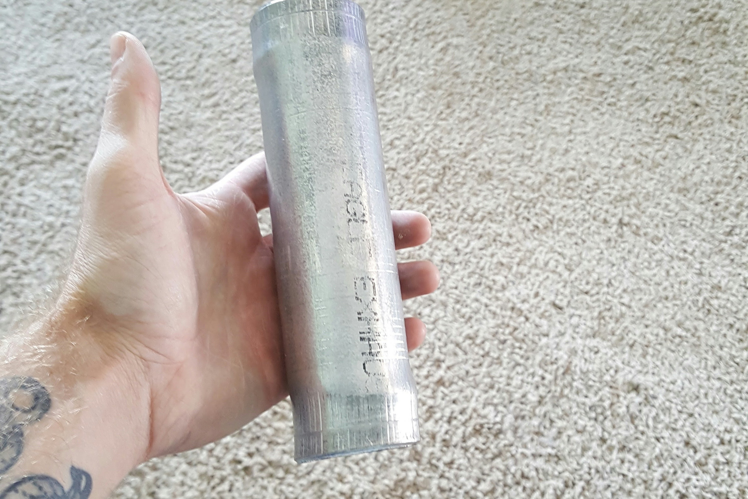

A hardy DIYer should be able to replicate this easily but I think the rolled edge is pertinent.

I bought a piece of pipe from my local muffler shop and had them flare the ends so the hose clamp has somthing to grab onto. Cost me 8 bucks and 20 minuets of my time. Works exaclty the same as somthing u buy. I felt like I had a little more throttle response after doing this.

It actually weights less than a pound, but feels heavy since it replaces a plastic part. We machine it out of a solid piece of aluminum bar stock to make it the highest quality possible.
There is absolutely no issue with not mounting it to the tab like the stock one as it doesn't take up near the space the plastic muffler does. So it doesn't need to be pulled to one side. Also the nice machined grooves we have not only serve to keep the rubber from sliding off under boost, or with old hoses like bead rolled tube can. But also allow you to tighten them down tight enough it all locks it straight so the tube doesn't move around, and keeps the hoses in place.
