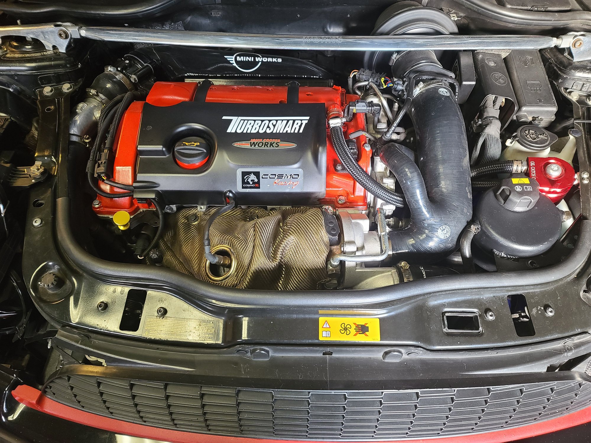

I'd like to add to this..
running a jb+ or nm module, if your reading boost based off ecu calculations from the obd2 port it IS NOT reading max boost. The plug in module trucks the ecu into seeing less boost than it actually is. If you hook up a true boost gauge off manifold pressure you will see upto a 4psi discrepancy.
I have personally tested this because I've run both jb+ and nm module and have a true boost source boost gauge and when i run a module, the boost readings dont match the ecu calculated v the true boost source..
with my car I can hit 26psi true boost BUT my ecu calculated boost only says 21psi.. that's with the nm module set to max.
i too made a post wondering about stock boost limits ect because I couldn't believe how high of boost I was seeing with JUST an nm module and NO tuning.
