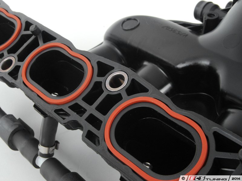

Intake is usually around $350 We see this with the Canada and far north cars get it. But when its gets really cold down in the US. Then i pops up.
11614584240 Cold Climate intake manifold.
https://www.northamericanmotoring.co...different.html
Intake Manifold Part # 11614584240 $316.30
http://www.ecstuning.com/Search/SiteSearch/11614584240/
https://www.northamericanmotoring.co...d-weather.html
