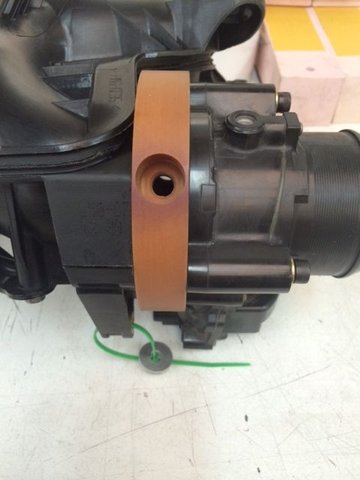

my post throttle housing adpt two postions available

sec postion for injector

Photo of where to mount the FAV for the HFS4
